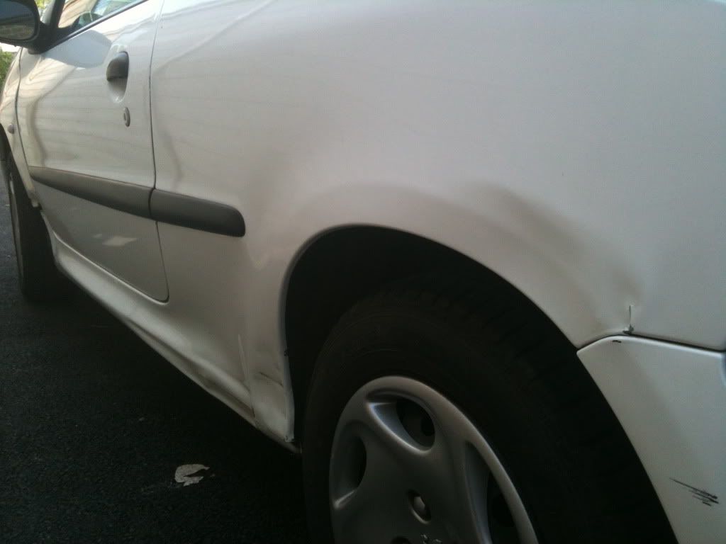

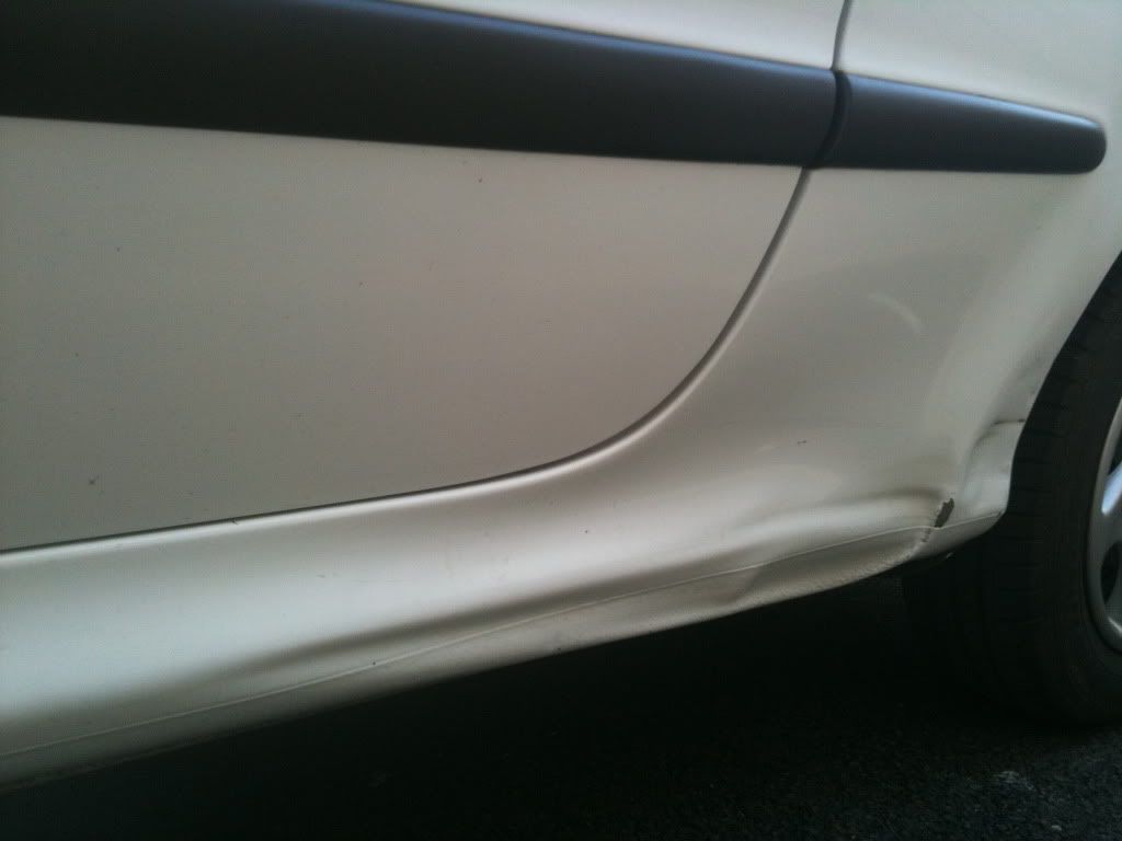

i got quoted £1500 for all 3 pics, not including wing
tried someone else got quoted for main dent £270ish

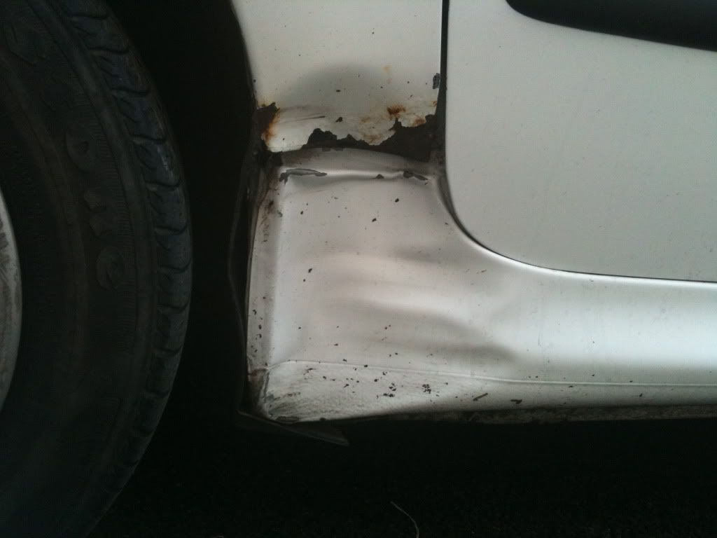

mines actually on the underside of the sill and about 1/4 of the width of the door but has pushed the sill right up
as said i will be getting a quote on thursday and will post up a picture and what i get quoted Smile
thats far too much for whats needed
