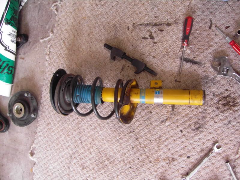

Should be like this. The spring tension should hold the bearing against the top mount.

SinfulDesignCom wrote:
Ed - tell me you gave that Billy a lick of paint before re-fitting?
Naah. I bought new ones!
