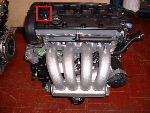

unplug your VVt solenoid then plug it back in, sorted mine.
Or it could be a Lambda sensor on the exhaust but my first suggetsion wont cost you anything Laughing

nellyhaggis wrote:
What is the VVt solenoid?
If you take the engine cover off, and look towards the back lefthand side of the engine, you will see some wiring going to the solenoid, just unplug it.
The VVT solenoid is what controls the variable Valve timing, so it will run like crap when it doesnt work.

Clean the VVT solenoid with carb cleaner while it's out. It's a 5 minute job.
It may also be a sensor in the exhaust bringing up the antipolllution fault.
