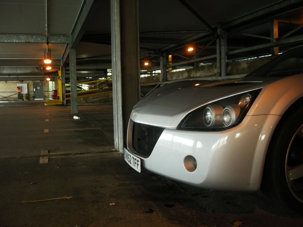

Well, bought the car in August 2009, looking a little like this:
206 Hiding in the background

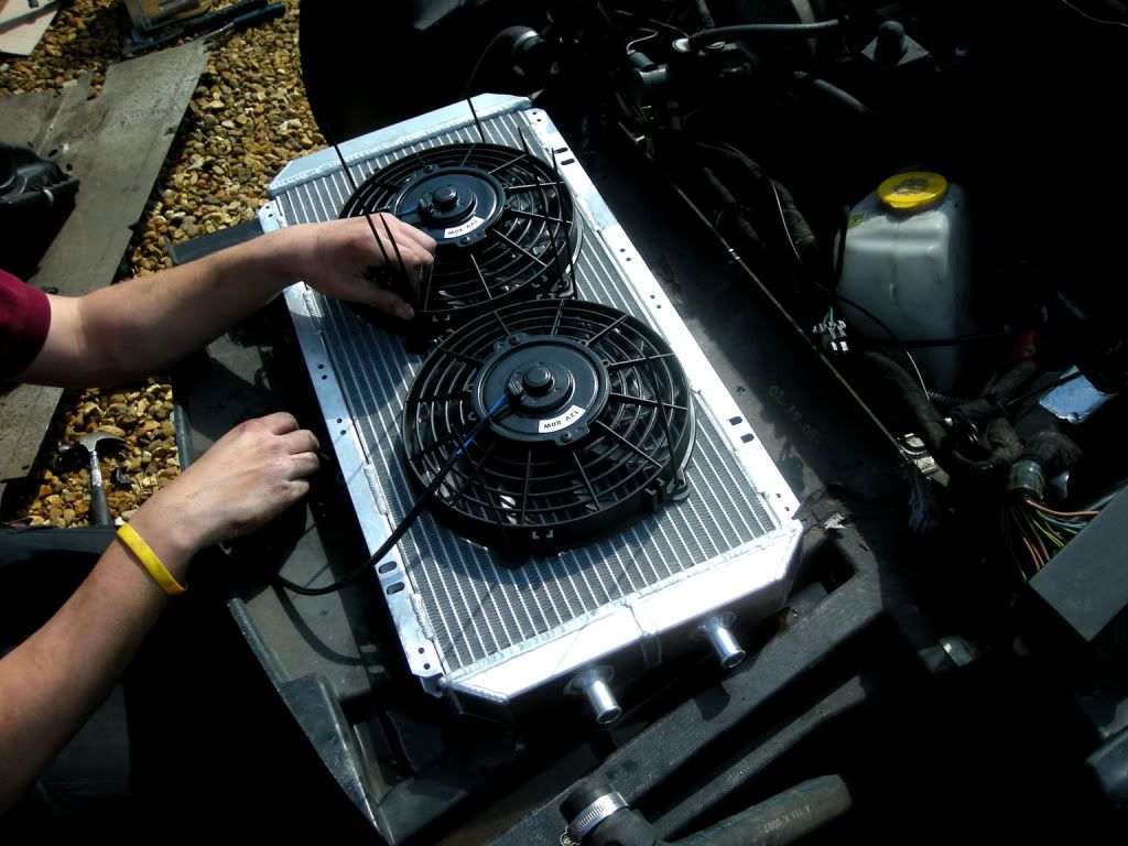

Replaced the standard plastic ended radiator with a pro alloy one:

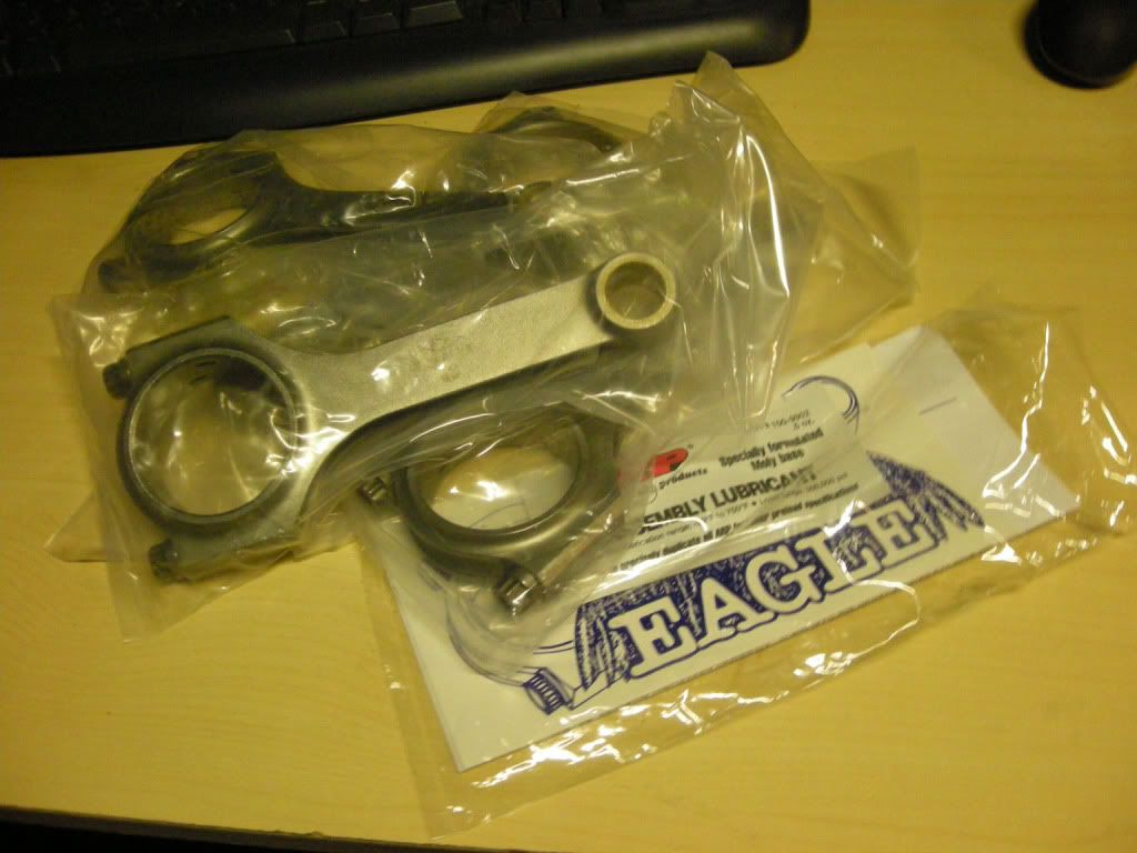

Forged conrods:

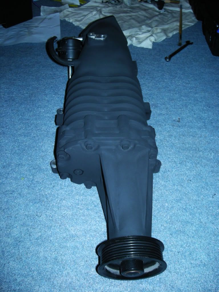

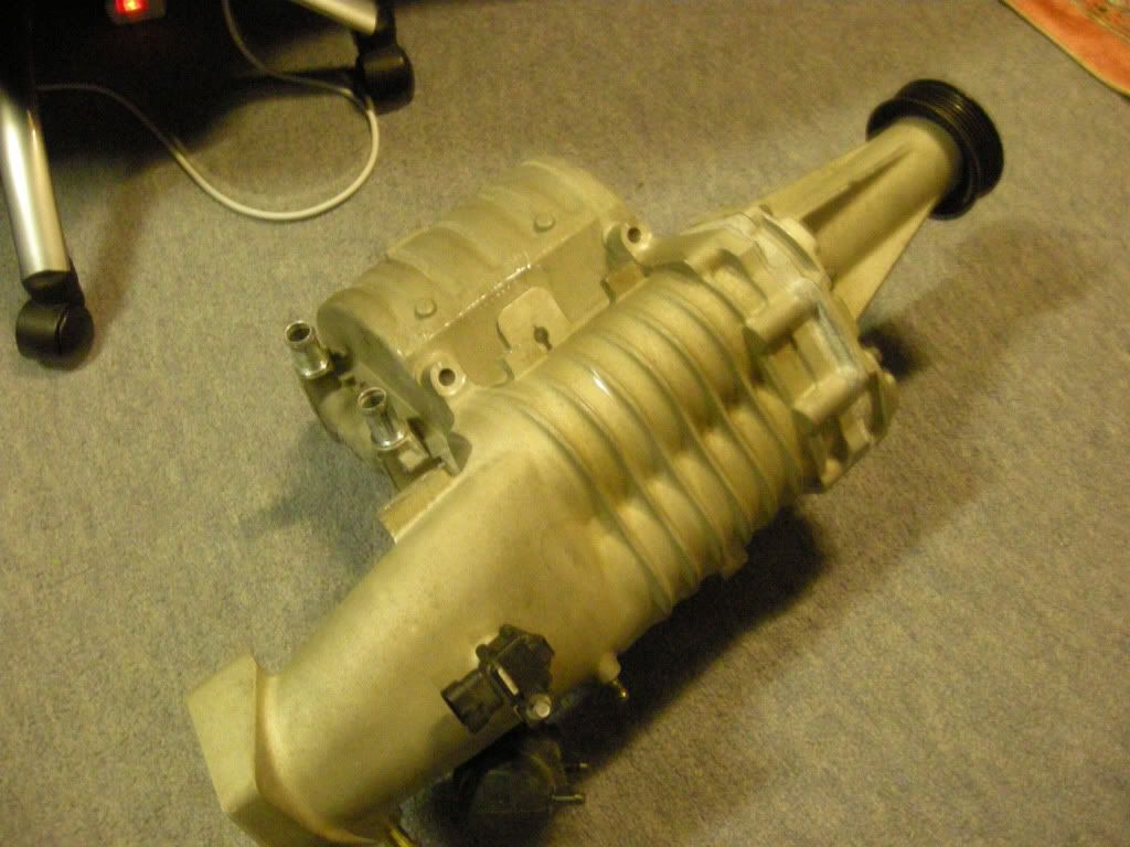

Really bad picture of an Eaton M62 Supercharger sat on the floor:

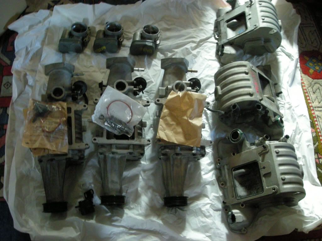

Some other kits I had in (bought 7 in total from the USA and passed them onto VX guys here):

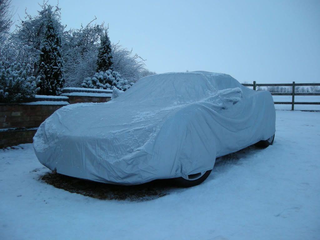

Packed up in the snow:

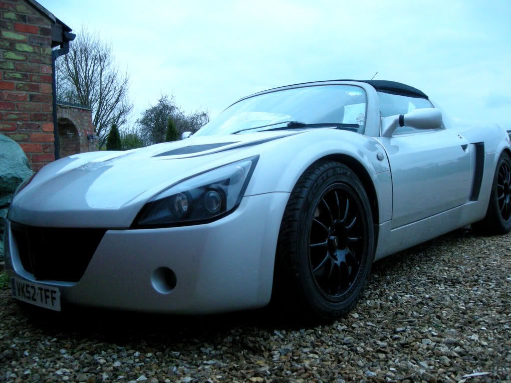

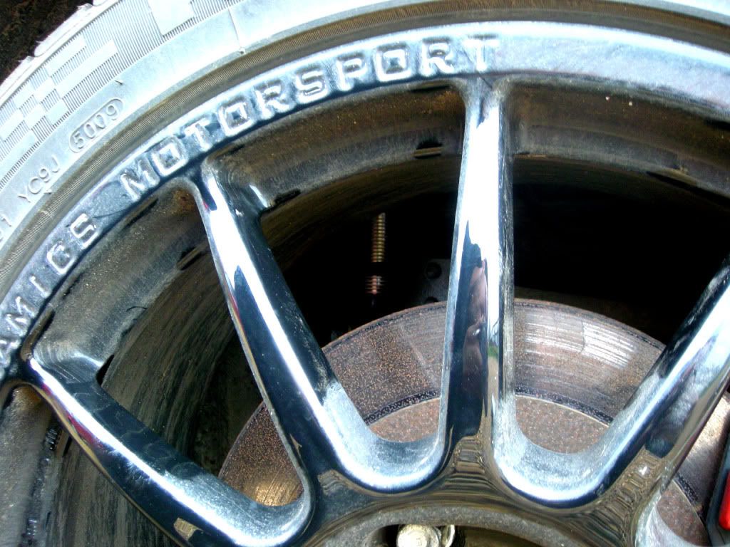

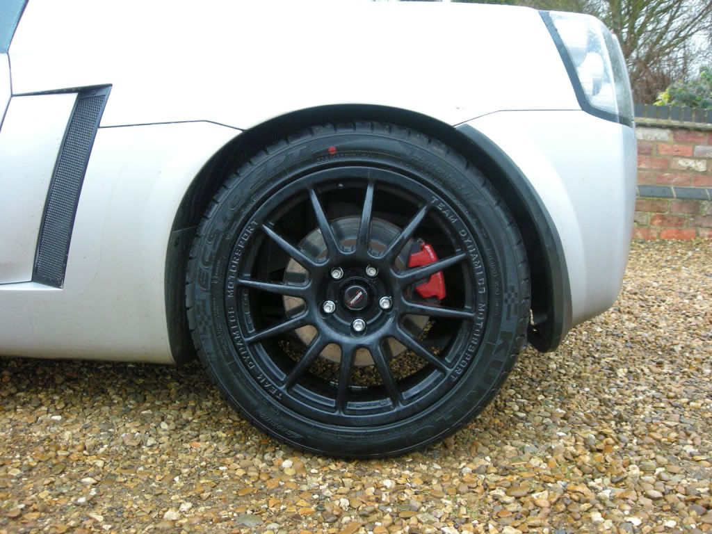

Got some new wheels on order as I needed new tyres and felt wrong not to get new wheels when it would only cost me about £200 more (£100 if I count in the sale of my old wheels).
TD Pro Race 1.2s designed by Thorney Motorsport and Rimstock to perfectly suit the VX. Comes in 7Jx16" fronts and 8Jx17" rears. Saves about 3kg per wheel on weight too.

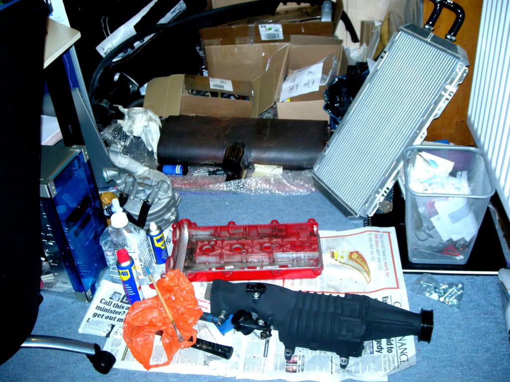

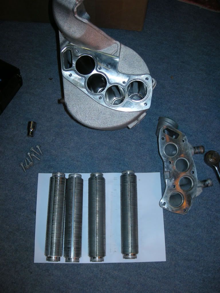

Clean laminova cores and manifold:

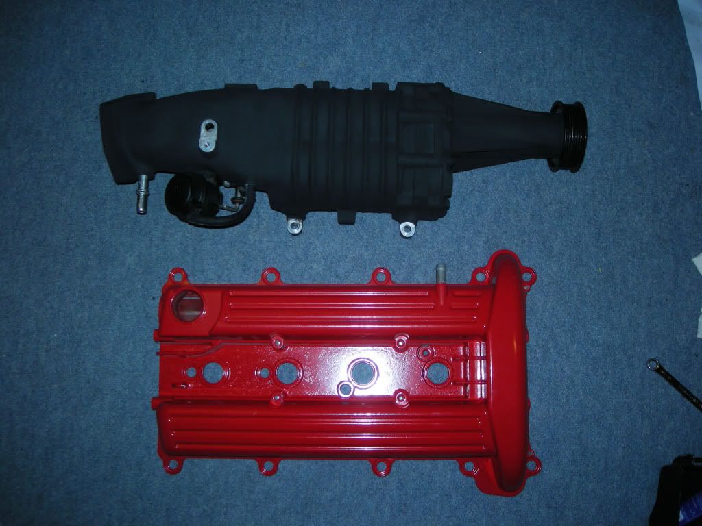

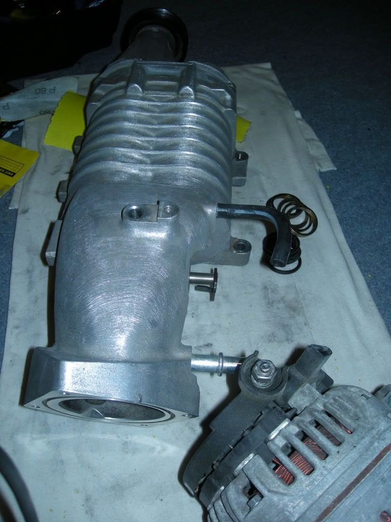

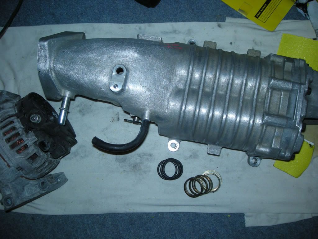

S/C all sanded down and keyed ready to be sprayed now.
Washers and o-rings are from laminovas.
100A alternator there too as the 120A one is too large to fit on alongside the charger and larger inlet.

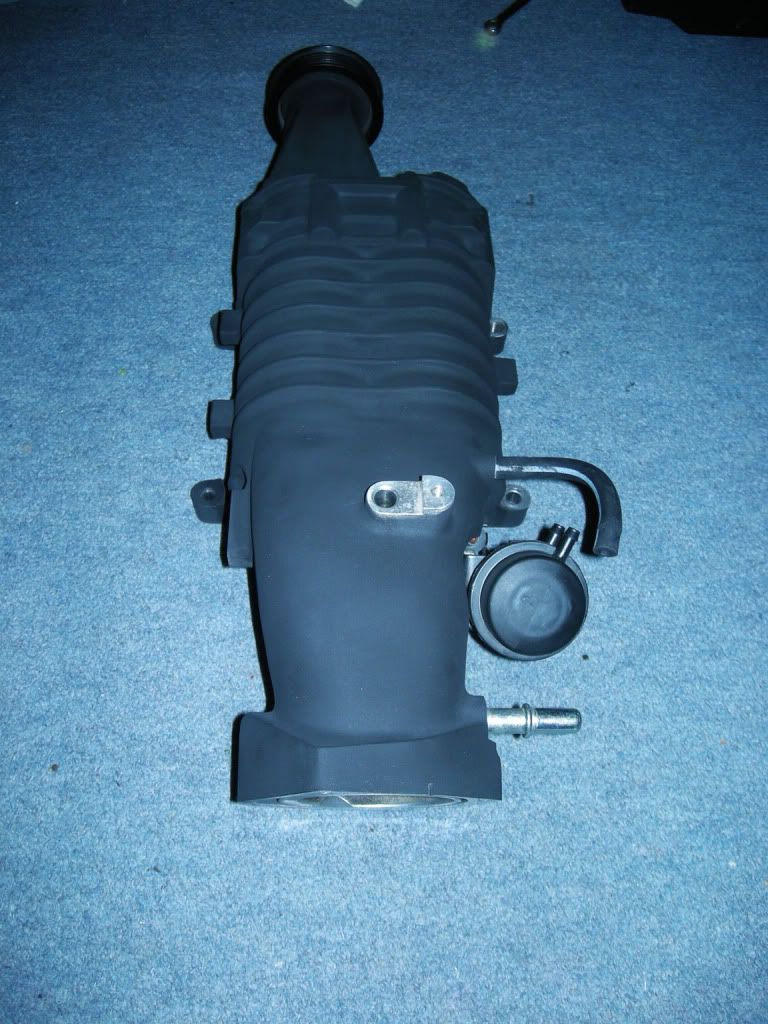

Charger is now cleaned and sorted, along with my rocker which a friend did for me. In two minds about the whole colour thing though, but will see how we go, calipers should be red soon so maybe it will work.

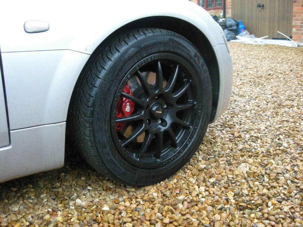

I've painted the calipers to go with it. Kind of like them.
Lettering looks a little odd from this angle, and it was hard to do, but still looks alright.

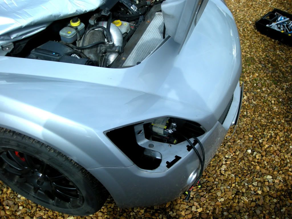

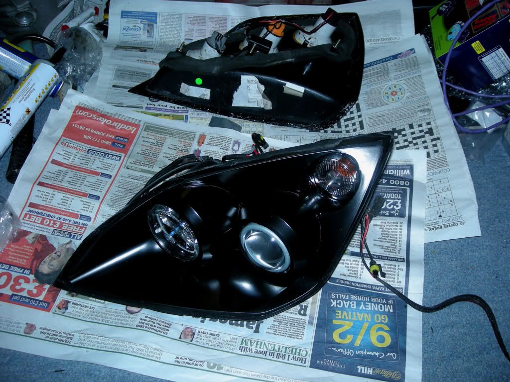

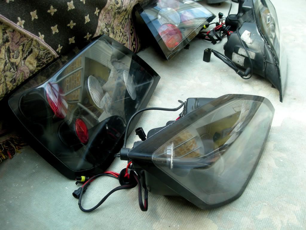

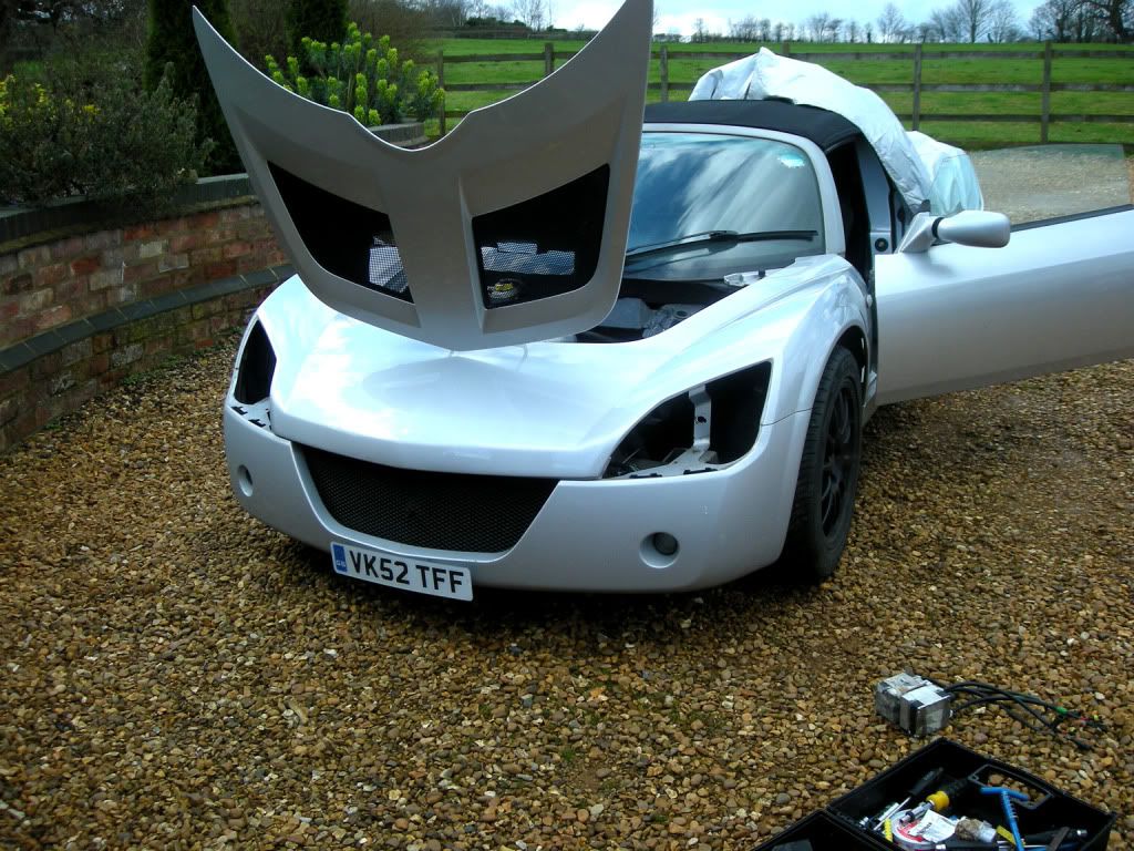

Lights came out (as they are getting black coated lens surrounds as it looks a little meaner and gives me something to do) and most of the front clam bolts were out too

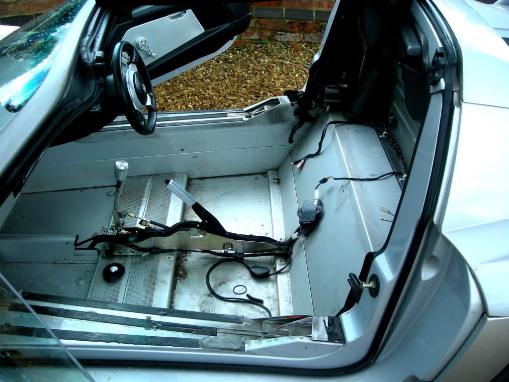

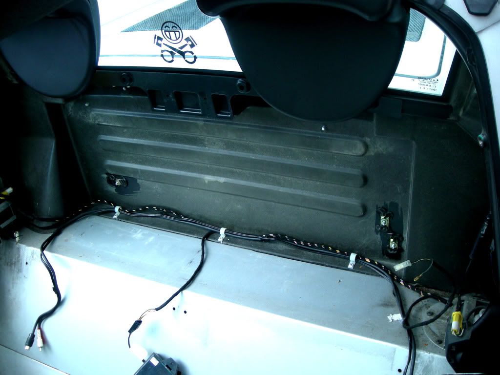

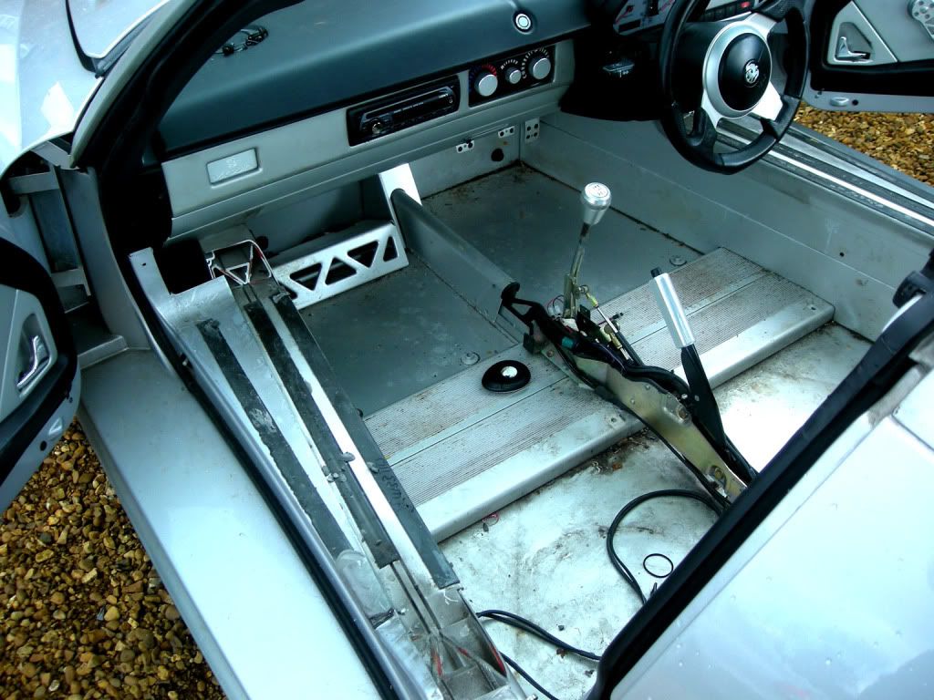

Then took to removing everything inside, that included mats, centre consoles, side pockets, carbon sills and rear shelf, and of course seats.

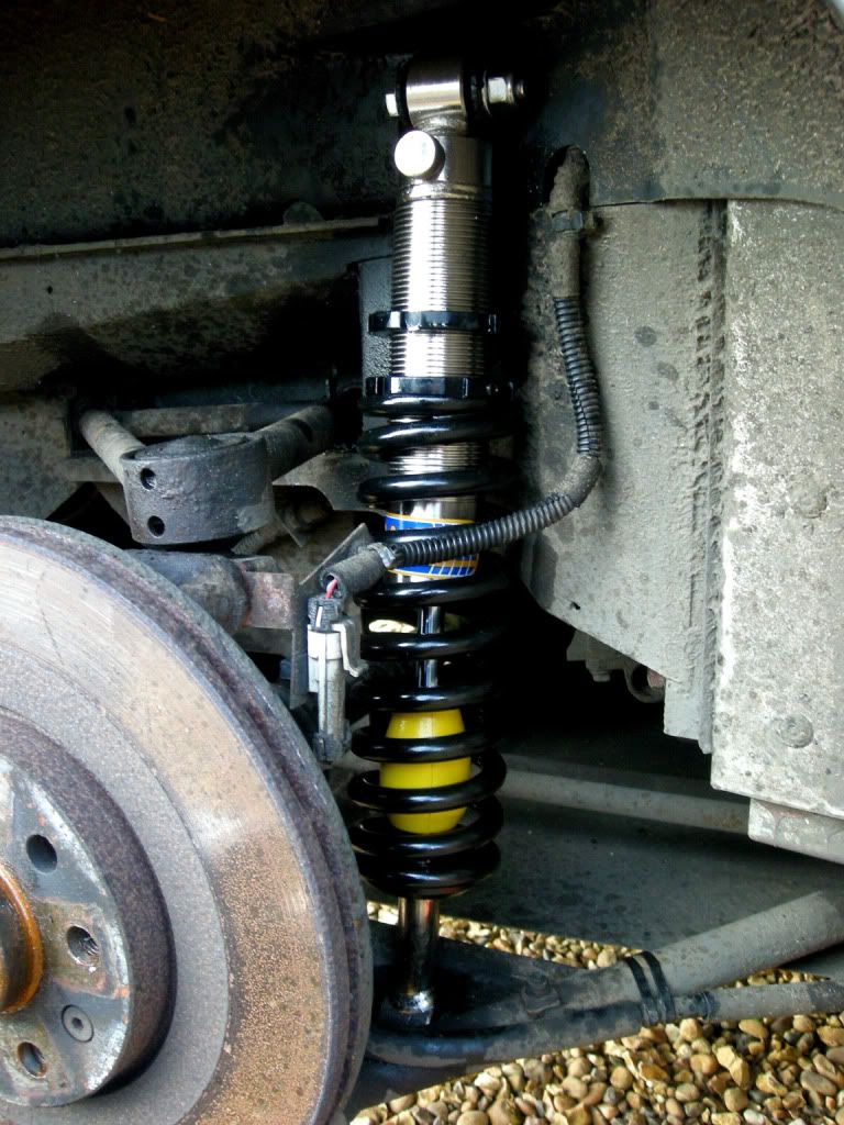

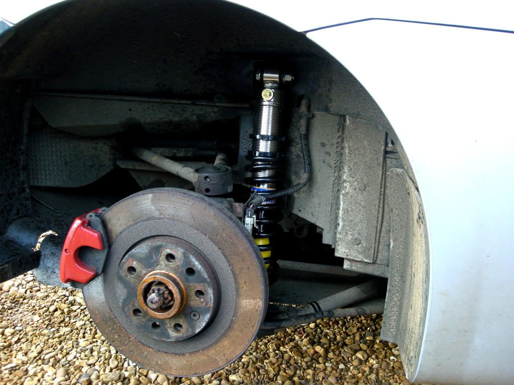

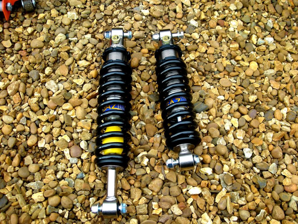

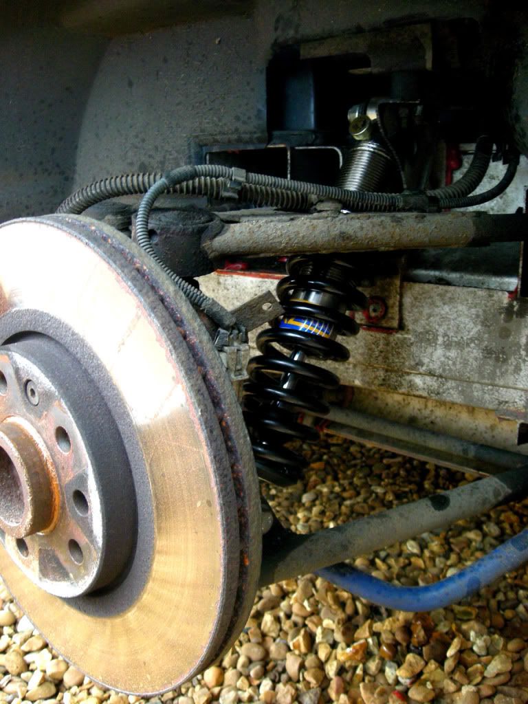

New coilovers ready to go on, 425 front spring rate 475 rear

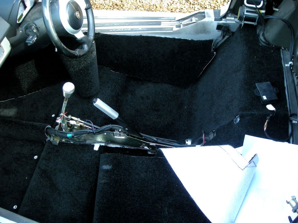

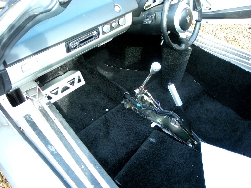

Made a bit of progress on the interior. Fitted most of the floor carpet section. It just adds a little warmth to the car and makes it more welcoming for a daily drive. Side bits are still loose for now as I've not got time to do the rest.

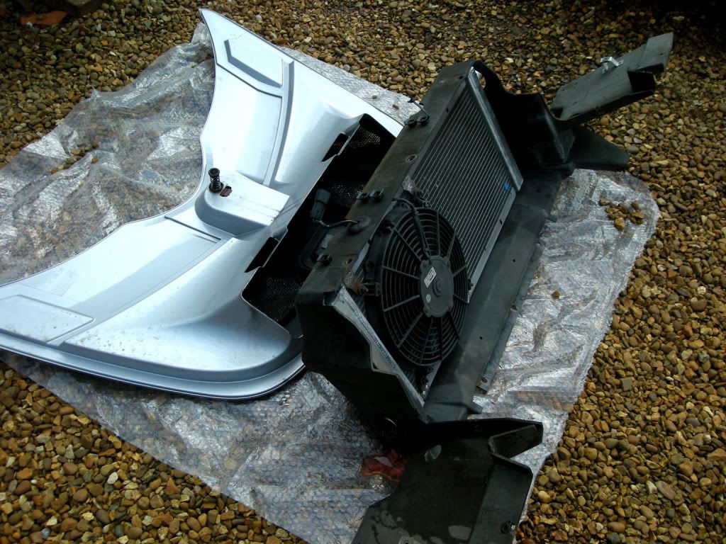

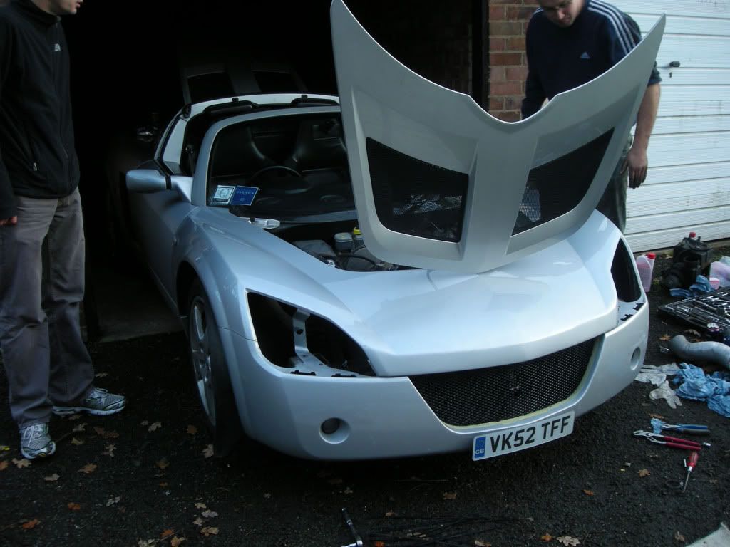

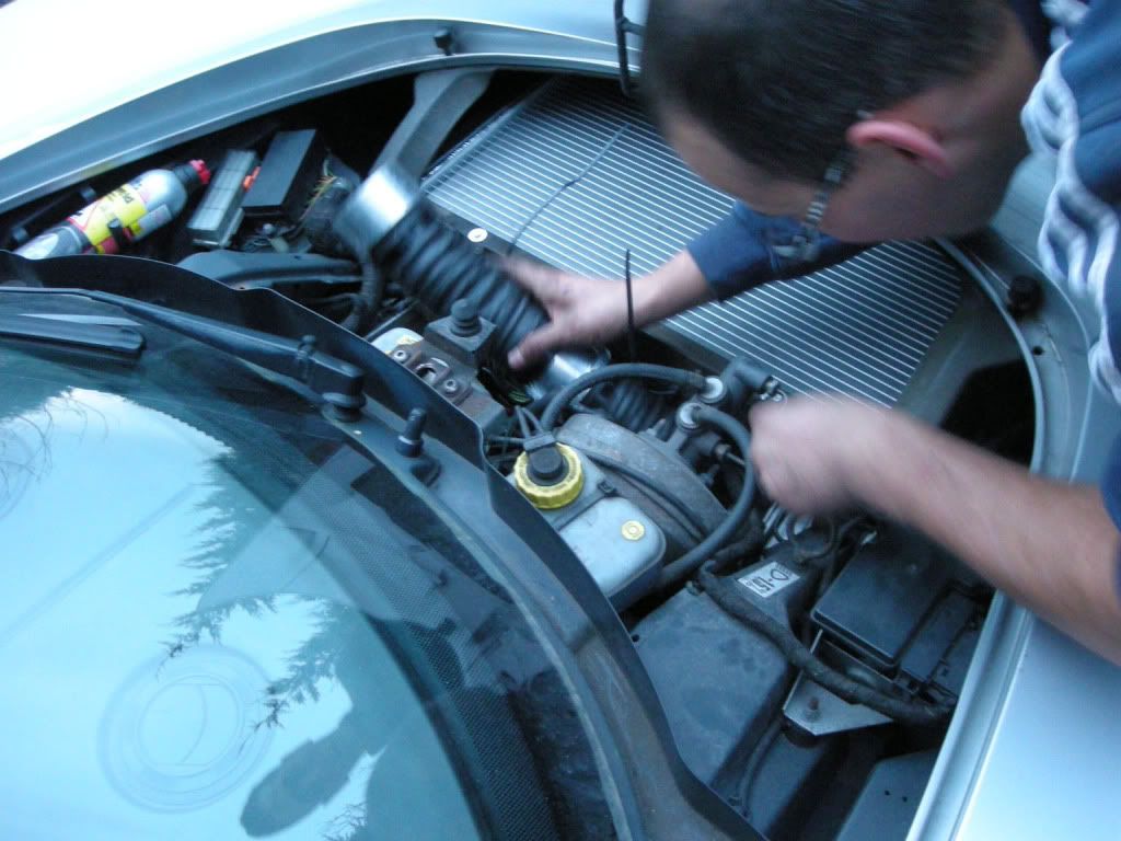

Took the front clam, bonnet and rad surround off to drain all the coolant down.

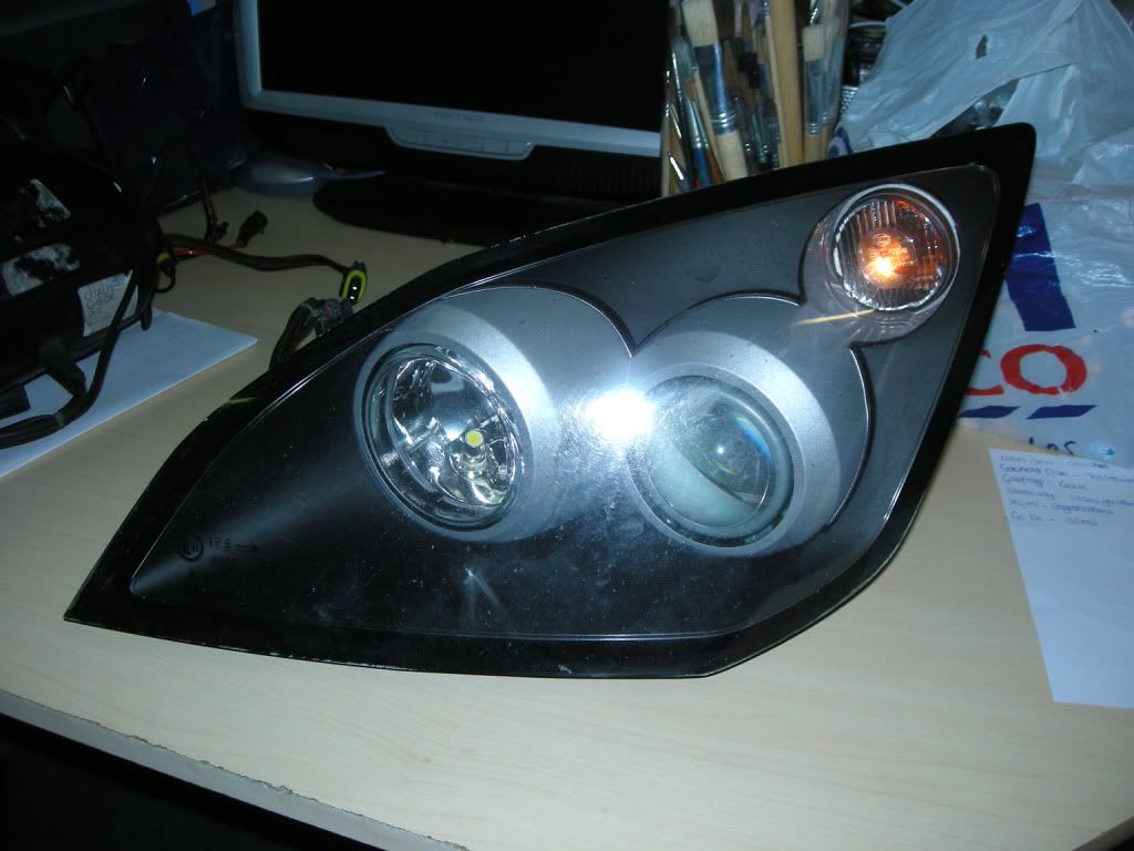

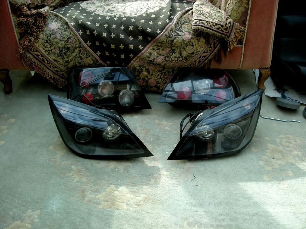

Got my standard lights which look like this (silver lens surround):
Popped them open, masked them off and sprayed them similar to the VX/T lights (black lens surround), and resealed again. Gave me something to do when it got dark.

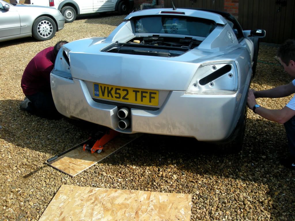

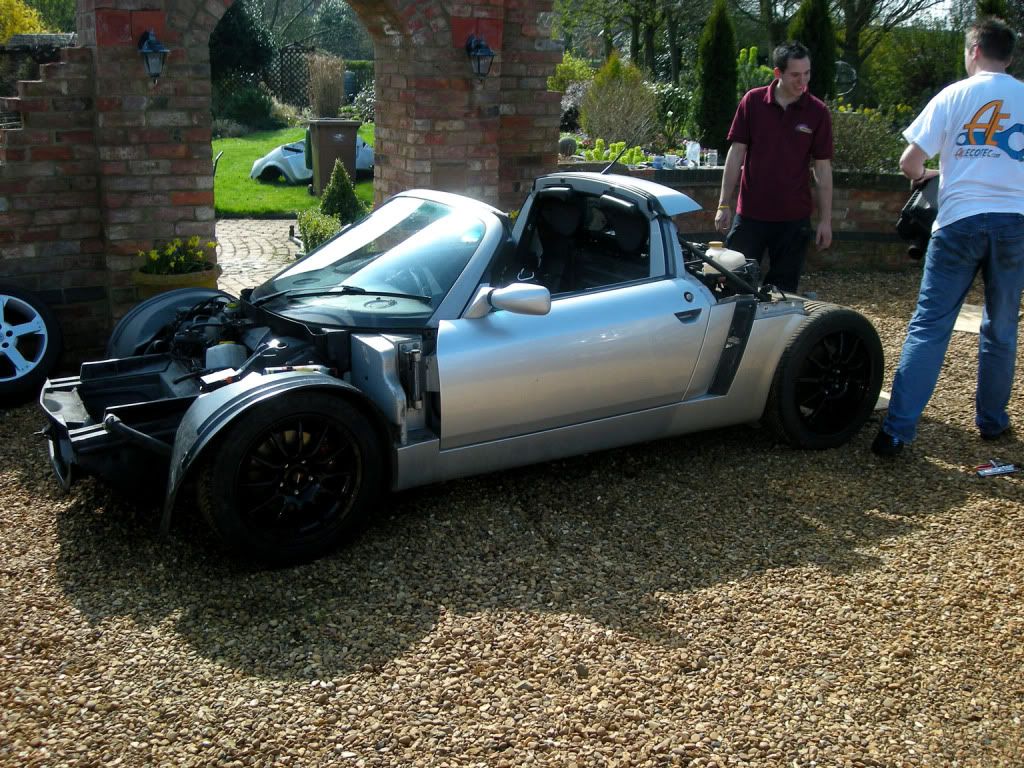

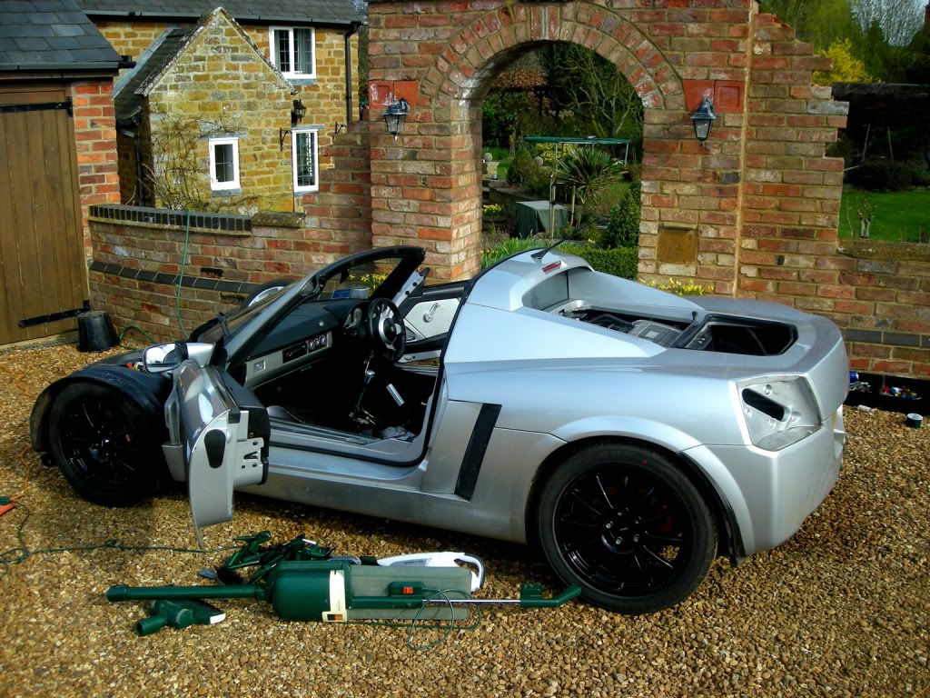

Started on the real work now, enlisted the help of 2 local friends as there was way too much work for 1 man over the 2 days I have this weekend.

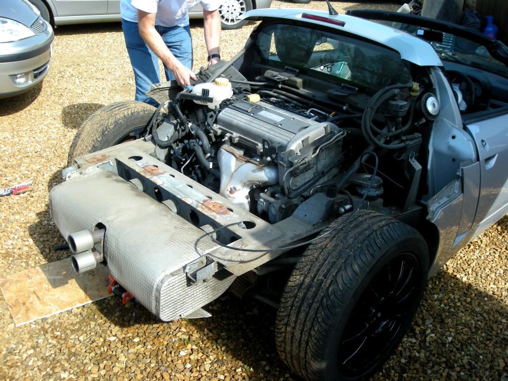

Rear clam had to come off.
To expose the engine and exhaust, including chassis.
Now you see why they are called big kids go karts, under that body work there is very little to them with the ridiculously short wheelbase and hardly any weight outside it at all, can just about see the rear clam on the lawn in the background:

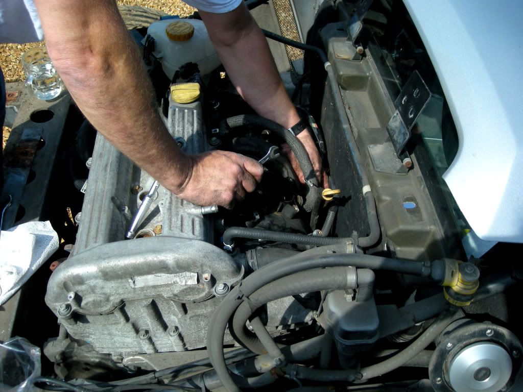

Bits started coming off, inlet manifold, exhaust etc.

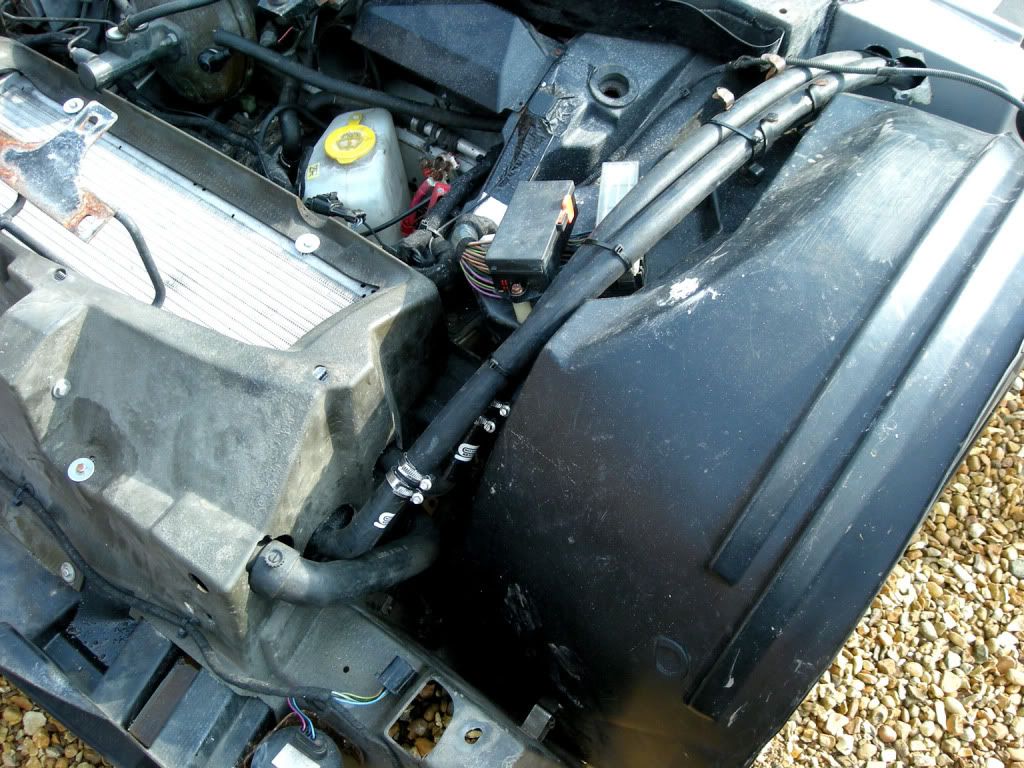

In the meantime work was having to be done at the front, chargecooler and twin fan fitment:

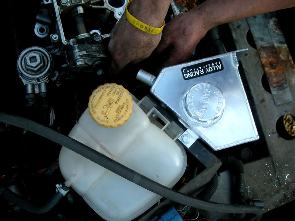

Chargecooler header tank in the engine bay:
Fitted with the normal engine rad and surround back in place, chargecooler pipes leading into the sill to the rear:

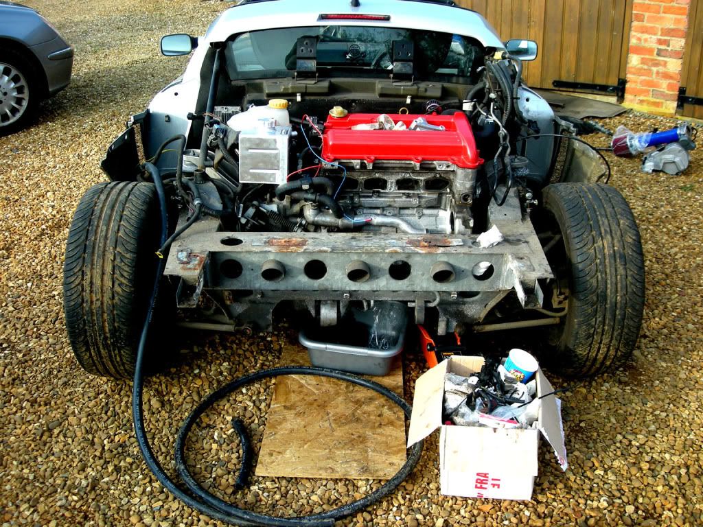

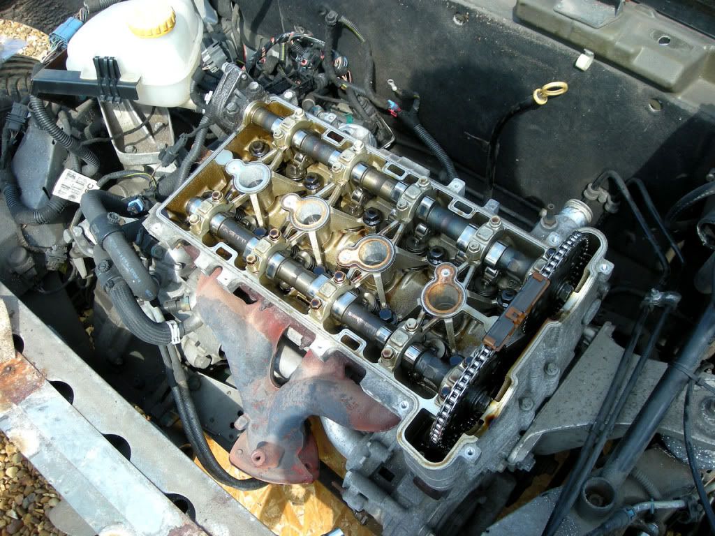

Rocker off:

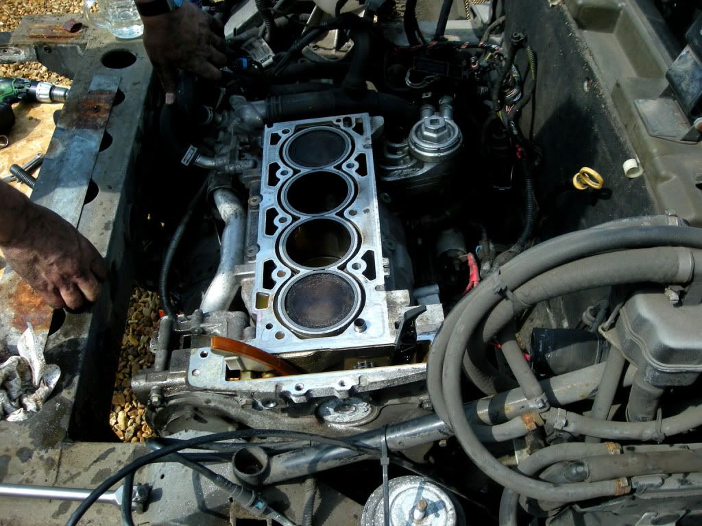

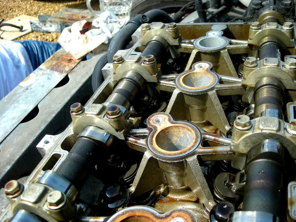

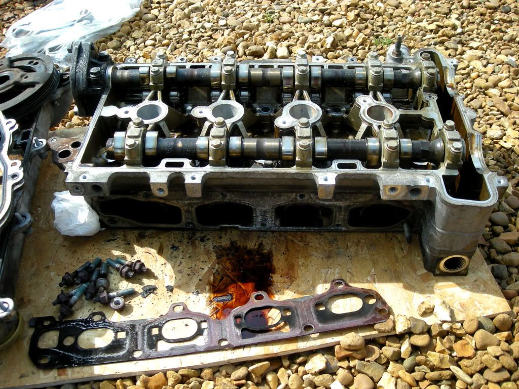

Head off:

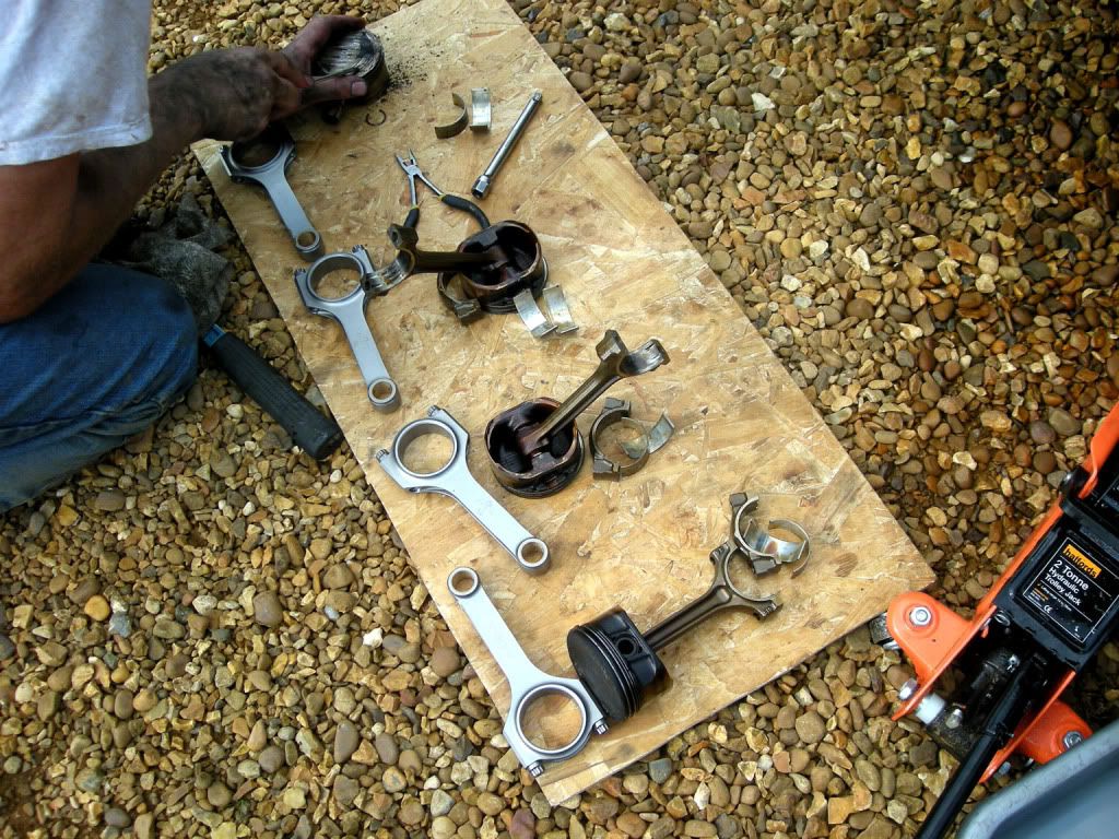

Pistons:
At this point the sump had to be removed and drained of oil, to get at the crank to remove the conrods so the pistons could slide out. No pics of the inbetween as I had my hands full.

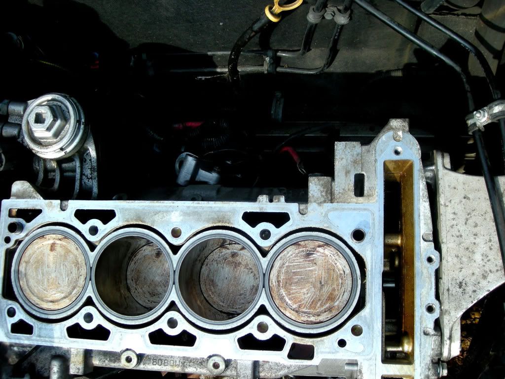

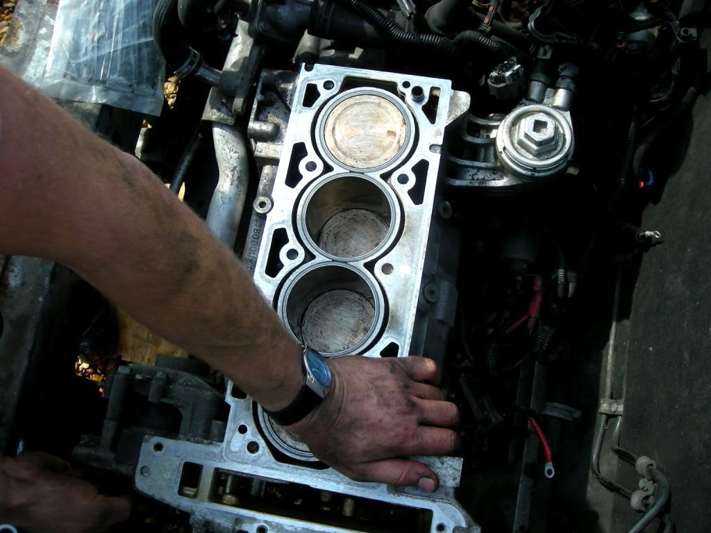

Pistons out:
You can tell the difference between the new larger forged rods and the old cast thin ones.

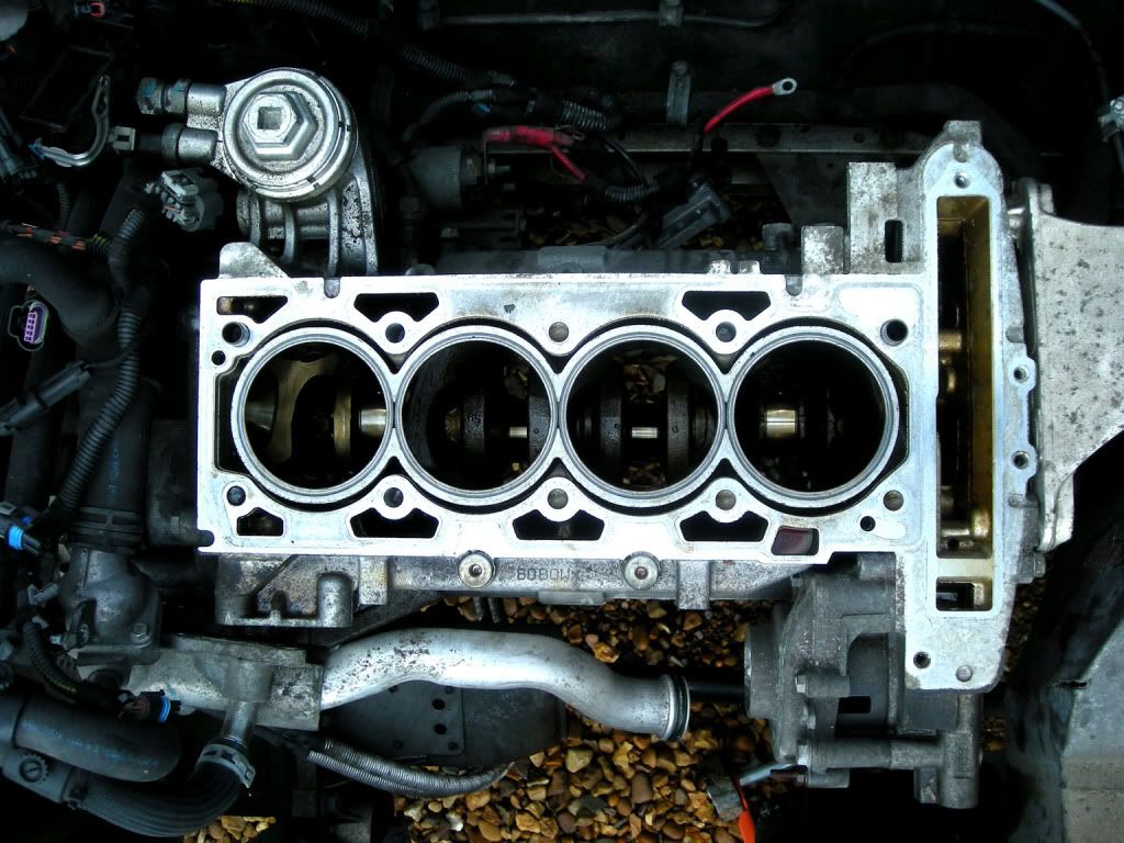

See straight through the bores to the floor:
At this point I noticed that not only did the cams look brand new, the bores didn't have a single score mark on it and Neil (who has built about 10 of these engines to different specs) said it looked almost new and not even run in. Previous owners have kept/serviced it very well.

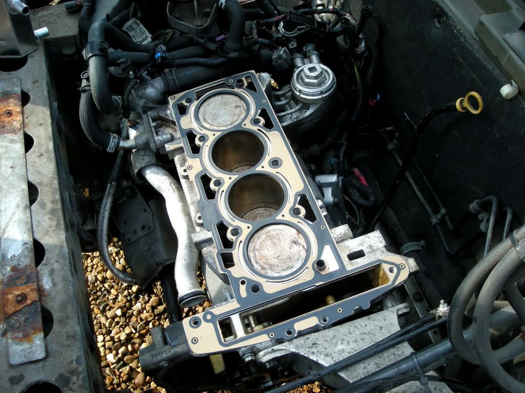

Pistons and rods back in, gave the pistons a very brief scrape (so we could see the directional arrows they have imprinted on the crown - wouldn't want to put them back in the wrong way!!), though you can be fairly rough with the surface of a piston as it does see some fairly large explosions and high temperatures.. just don't touch the bores!
Multi layer head gasket on, shorty after, the head went back on

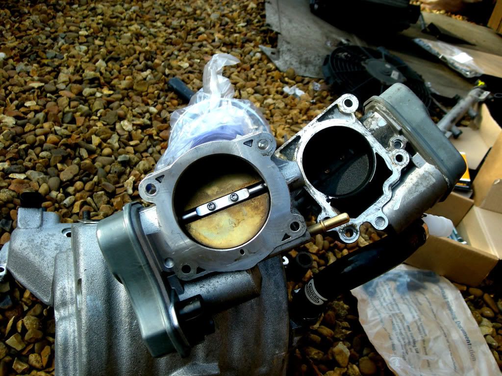

Was just comparing the new S/C (left) to the old N/A (right) throttle bodies to see the difference, fair amount in it!

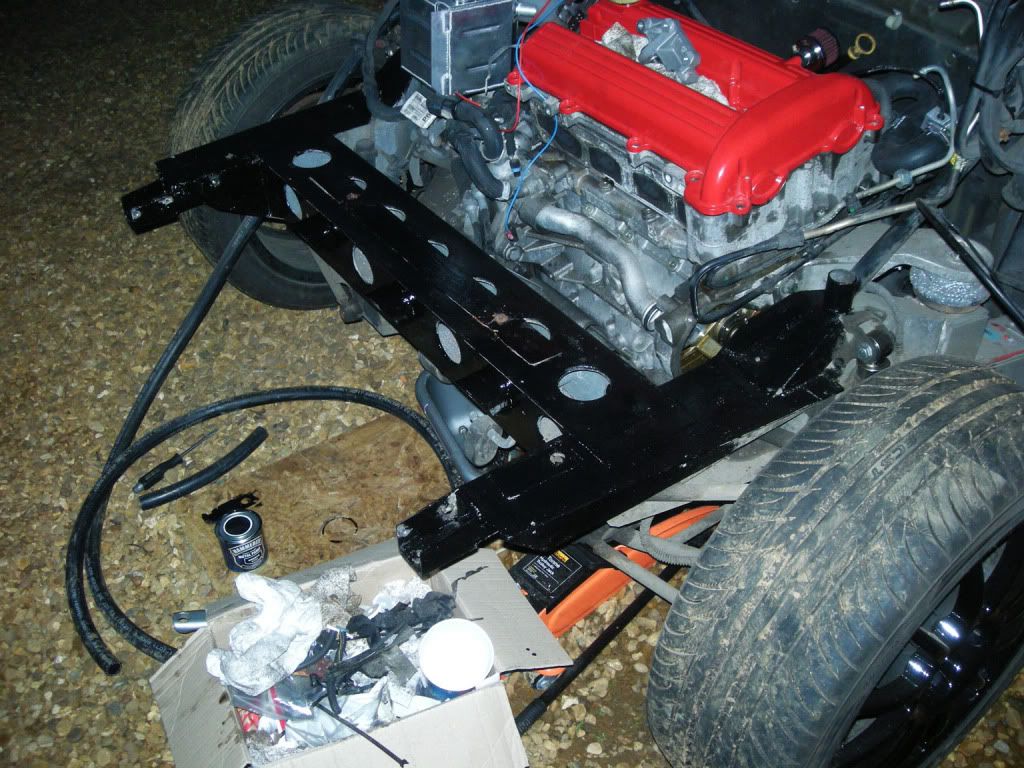

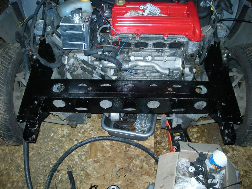

So the girlfriend came round, had a look over the rear chassi, decided didn't look nice enough and proceeded to sand, brush, and paint it for me because I was knackered:

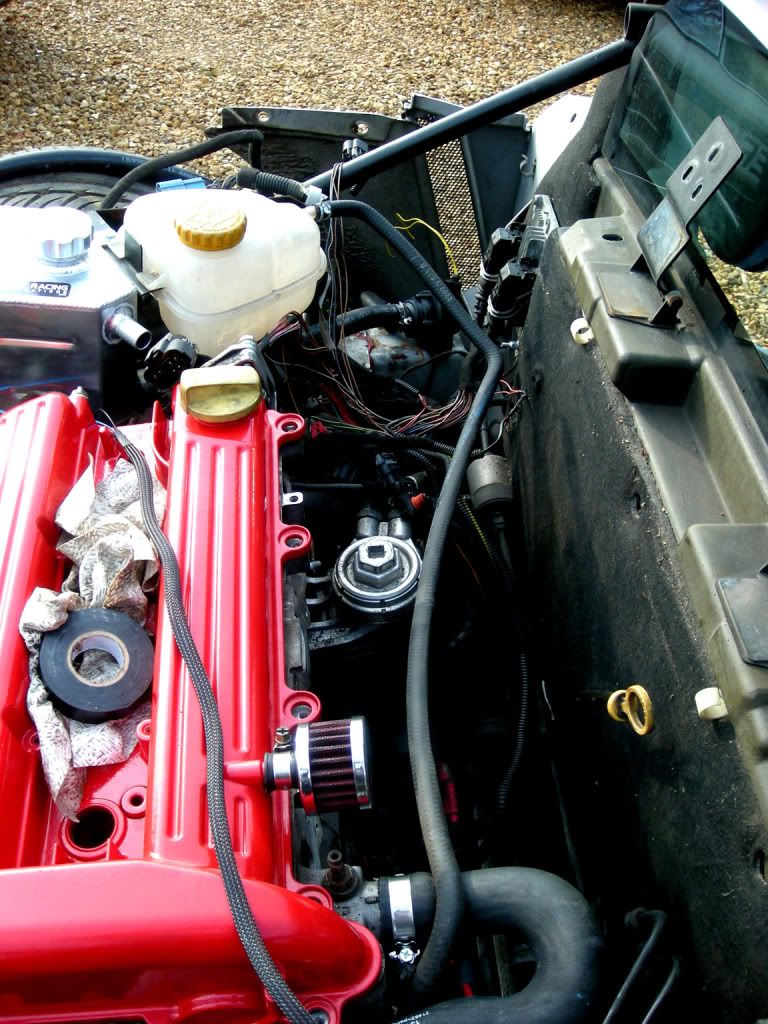

Timing chain on and rocker on properly:
Inlet on:
Alternator and custom made idler for the charger belt:
Wiring to be sorted:
Sorted!Injectors & fuel rail on. Tried to keep as much of the 'factory' look as possible:

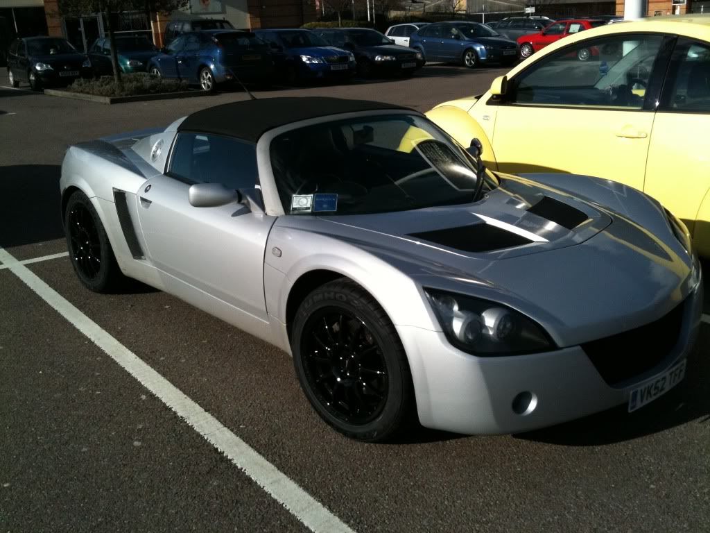

Had my windscreen replaced with a black surrounded one minus the previous dents.
Dirty, as usual, but brakes are nearly bed in and tie rod is holding well.

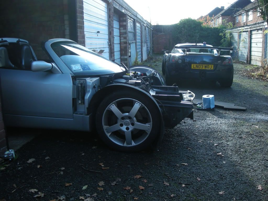

Also forgot to say, note the wing in the 6th picture on the black VX'R' used as a beer shelf Razz
