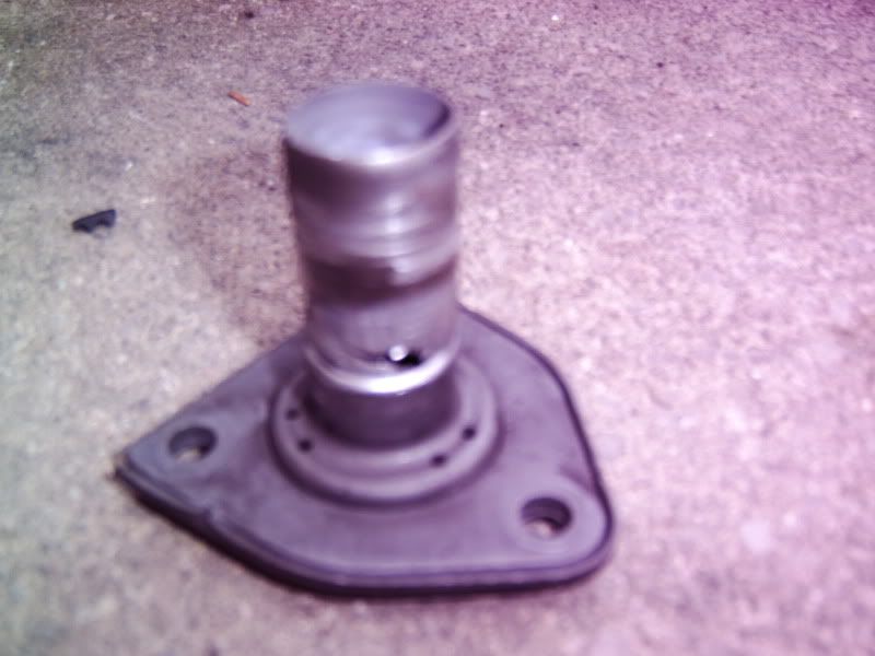

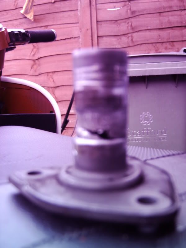

Right ive only had the car a few days and the clutch had a major judder and first thing i did was buy a new kit, anyway to cut a long story short it had a new clutch fitted 10 months ago and has only coverd 3k since it was done
i was going to do the job myself but didnt fancy it after all it was a bigish job on a driveway
so got a new clutch kit trade and got a garage to fit it for me at the cost of £150 quid

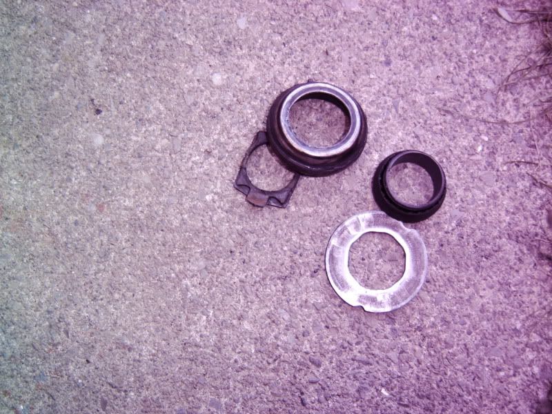

got a phone call at midday today saying the the clutch relese bearing has shatterd inside causing it to ware a big hole in the shaft on the gearbox but the part with the seal was only £16 so well happy now and she lives for another day here is the pics

PostPosted: Wed Aug 31, 2011 12:52 pm Up
so that means the previous owner didn't fit a new clutch kit?
can't believe the release bearing fail in 10 months Laughing
anyway glad to see you find the problem Razz

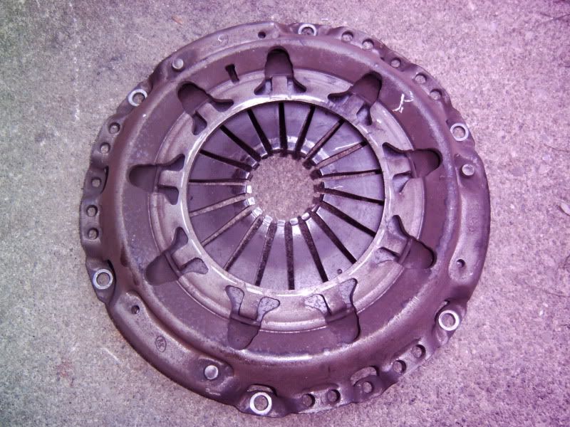

Well the clutch and pressure plate has LUK on it so must of been done, the clutch itself was fine just everything else
The garage said who ever fitted it was a monkey as they was bolts missng everywere
