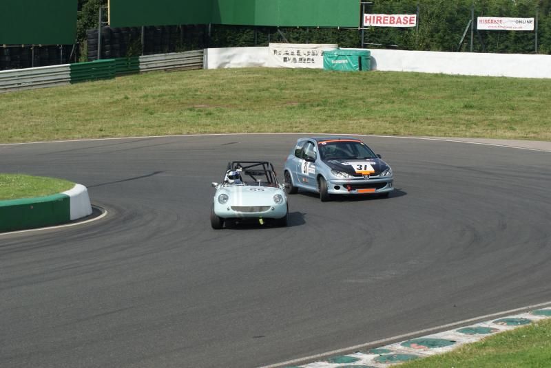

Qualy
A good turnout meant 16 on the grid for the sports V saloons races. I was getting into the groove in qualifying and trying to recall my braking points from the last visit here in 2012. I caught a very quick Metro and it took me 3 laps to get past him, then as I finally passed him going into Gerrards I looked in my mirror and saw smoke pouring out of his bonnet. On the next lap, halfway round Gerrards the car lost front end grip and I went shooting off onto the grass, luckily I was able to recover it and continue, but there was obviously something on the surface so I pulled into the paddock with 9 laps completed and a time of 57.25. This put me 9th on the grid with a Fiesta ST in 8th and a Honda CRX in 7th, both with qualifying times about .3 of a second faster. They were my targets for the race...
Race one
It was a rolling start and I think I was passed by a Midget who jumped the gun a little bit. Having watched the video I was way too cautious on the first corner, I seem to say that a lot! The Fiesta and CRX disappeared into the distance and I spent a long time trying to get past the Midget, great fun and we came extremely close to touching several times, but there was always a little bit of racing room. I was able to reel him in on the brakes at the Esses and Hairpin, but he would pull away out of the hairpin and had a better exit from Gerrards. I knew that the hairpin was the place to do it and eventually got myself into position and managed to make a pass, then let the car run wide on the exit so he would have to go round me the long way at the Elbow. I held him off into Gerrards and then it was a case of defending my position for as long as possible. Unfortunately the chequered flag didn’t come out as soon as I hoped, and as we caught a backmarker (the aforementioned Metro) there were no blue flags and he blocked me at the hairpin, allowing the Midget to get alongside on the exit and go round the outside at Elbow. We were side by side down the start/finish straight and at one point I thought he was trying to run me onto the grass, but he left me just enough room... We caught more backmarkers, he opened the gap, more backmarkers, I closed the gap but couldn't get past him again and then the flag came. So I finished in 8th but only because of DNFs in front of me. Great race, had a chat with the Midget driver afterwards and he was equally thrilled with the close racing. Fastest lap time 56.5 (my previous best was 56.9).
Race two
This was a sealed handicap race, didn’t find that out until the drivers briefing in the morning. Oh well, just race as hard as you can eh! Started in 8th place, rolling start again. Got caught napping as the lights went out and cars swarmed all over me, don't know how many places I lost. Also the CRX span going in to Gerrards and I think that slowed us all up, allowing the first pack to get away. Having watched the onboard video, I also knocked it into 4th gear, no idea why. By lap 2 the Midget from the first race was 100 metres ahead, I was now lapping behind a Spitfire who had the same fast/slow characteristics as the Midget. A few laps behind him checking out his weak spots and I made a pass, I think it was at the Esses??? He was all over the back of me until a few laps from the end when I pulled a gap... and that's all I remember. Car was handling funny and felt slower, reflected in the lap times with a best of 57.3. Pretty sure this was caused by me swapping the front tyres around between races to even the wear (stupid idea!). I think I finished 9th on Handicap as my handicap time was 56.5 so I was losing time hand over fist. Still really good fun, felt like a very long 15 mins!

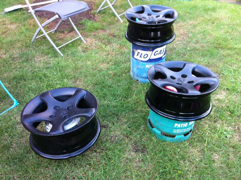

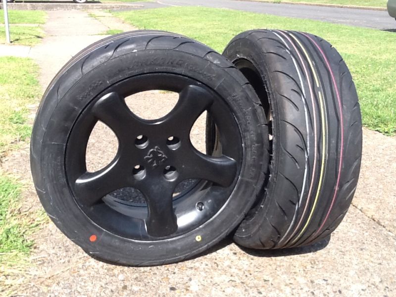

Finally finished painting the 306 wheels I bought last year and bought and fitted a pair of Nankang NS-2R tyres. I'm going to run these on the back in the dry, with the aim of having another pair with extra cuts in them to run on the back in the wet and swap these to the front. Won't be as good as proper wets but will allow me to at least survive a proper downpour. I've fitted them to the front for now just so I can scrub them in (hopefully on the airfield at work...).

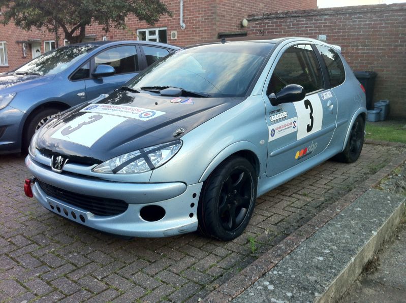

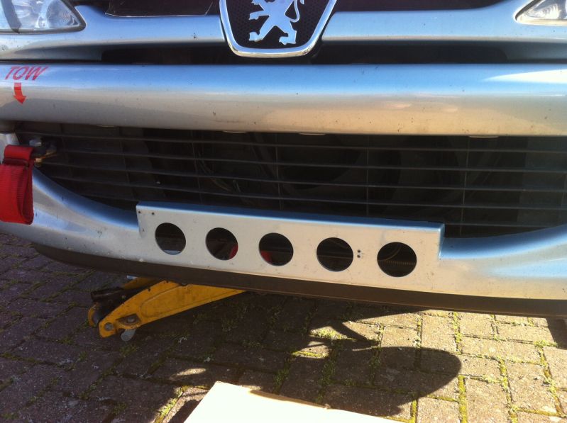

The power steering is another area that's been giving me some issues for a while now. It seems to weep quite a lot during a race and the fluid is near boiling by the end. I noticed today that the loop in front of the rad that's supposed to help with cooling is actually behind the number plate part of the front bumper, so out came the hole saw... this should help a little bit:

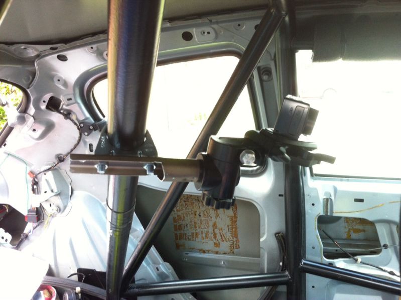

Also made a new camera mount using an exhaust clamp and an old monopod, giving a good viewpoint just over my left shoulder. Should keep the scrutineers happy, the old mount was a spring clamp secured with a tie wrap, always got a raised eyebrow when they checked it Wink

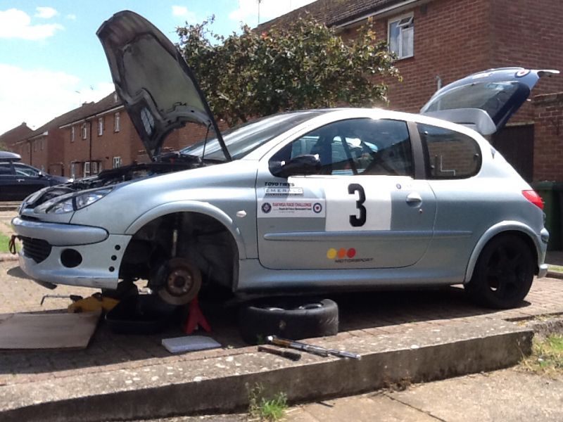

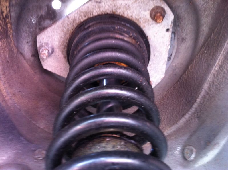

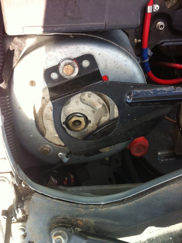

Another area I've been looking at is suspension setup, specifically negative camber, or a way to add it. I had a good look at the top mounts today and noticed that they appear to be fitted back to front. I can only assume this is something to do with the strut brace fitting? Anyway, can I just drill some new holes further inboard to induce more negative camber? Anyone know any measurements that give a set amount of camber?
Cleaned all the old dayglo orange tape off, looks much cleaner now Very Happy
206 GTi Circuit Racer
Tricolore Trophy
www.trackattackraceclub.com
usher
PostPosted: Sun Aug 10, 2014 7:41 am Up
Joined: Jun 04, 2010
Posts: 1691
Location: northallerton
looking good, i have folowed you with drilling the holes in the number plate area, cooling being my focus atm, drilling the top mounts will the the easiest way to do the camber but depends alot on space, obviously you will probably not be able to use the strut brace unles its got adjustment on it, i would say an inch over on the top mount hols wil be ample for some camber best way would be to undo the bolts holdin the strut to the car and push it over and see how much camber you will get for a rough idea hard bit will be getting the holes in the right place

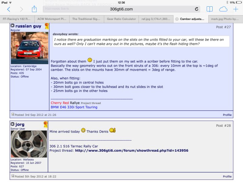

Drilling the holes in the right place "should" be easy, by making a cardboard template of the original holes and sliding it over to the new location. I'll have to enlarge the central hole too. This guy thinks 10mm=1 deg camber on a 306, so I can't see it being too different on a 206:

The camber guage arrived today, so I quickly zeroed it and ran outside to give it a go. Now before anyone says it, I know it's supposed to be done on a billiard table flat surface but my drive is fairly flat and I was intrigued to see what sort of reading I would get. So, -0.5 on the front left and +/-0 on the front right. Some large adjustments are needed...
