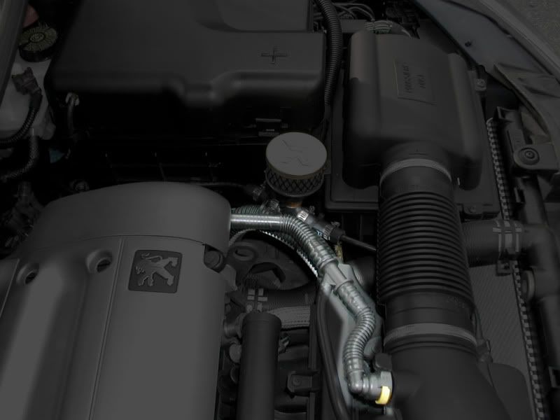

I've managed to get to the bottom of why the car wasn't starting, there was a wiring issue at the Coil pack! Anyway... whilst we were fixing this I noticed there was a crack in a pipe which I need identifying.
I've got a feeling that this may be the oil breather pipe but can anyone confirm this?
It's cracked near the coil pack so would I have to replace the whole thing or just the part from the "y" backwards?
Cheers Smile

I am 98% tht is the breather pipe

That was my gut feeling from past exprience. It had a small amount of oil residue in it (when I snapped it off... whoops) but wanted to check before I phoned Peugeot and bought a new engine by accident hahaha Smile

Is the oil breather pipe. they often snap!!!!

I'd get some silicon tubing from Ebay and fit it. That's what I did, you just need to cut the existing tubing off the T piece. Will cost less than £10. I bet that hose costs a few quid from the dealer.
PostPosted: Tue Dec 28, 2010 3:54 am Up
The part costs about £24 IIRC, the oil makes them very brittle.

£24 for a bit of tubing? They've got more chance of finding rocking horse s**t than me paying that.
I'll get some tubing as advised... cheers Smile

Yeah mine broke too lol I replaced it with silicon tubing not had a problem since Smile
