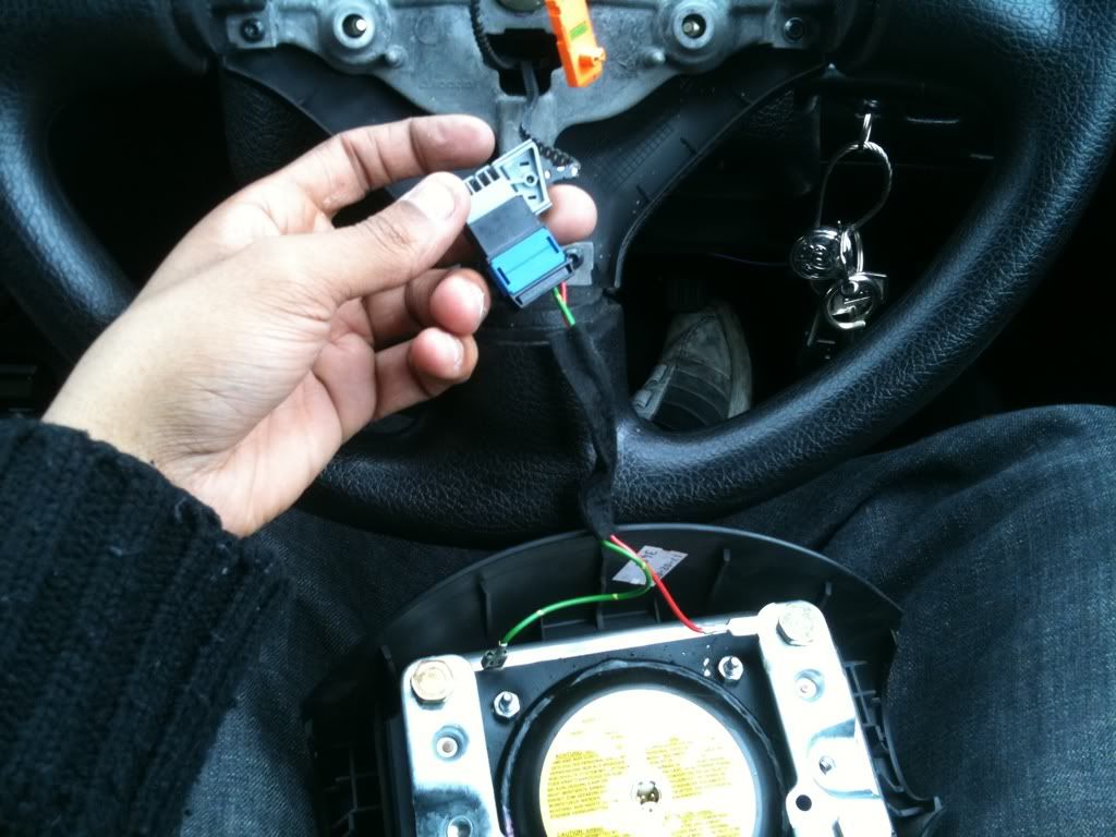

Ok well I'm just about to install my new gti steering wheel on my w reg 206, just one quick question after following all the guides, does the airbag cover (plastic bit with the lion on over the horn in te middle of the wheel), does this bit pop off before you attack the torx at the back or is it part of the airbag unit itself?
Cheers, think I can do it just don't wanna pull the plastic cover off and find out it was actually part of the airbag lol.

Its part of the airbag.
PostPosted: Fri Mar 18, 2011 8:55 am Up
Just be careful you don't take it off and snap the wiring

Ok here goes .... .... ....
PostPosted: Fri Mar 18, 2011 9:07 am Up
Have you disconnected the battery & left it for 15 mins?

Yeah I've just unscrewed the back, this thing looks like a bomb, if I pull the wrong cable the bugger is gonna explode in my face, it was hard enoughto unscrew looking out the passenger window so my face didn't disappear lol.
Right, back to the guide...

I can't undo this connector here in my hand, don't wanna break it but it won't come apart any way I try
PostPosted: Fri Mar 18, 2011 9:28 am Up
It pulls out, the grey from the black bit but it can be very stiff
PostPosted: Fri Mar 18, 2011 9:31 am Up
Have you disconnected the battery?
Note that you can also just remove the spade connectors going to the steel part.

Done that, now my t50 bit is missing so I'm having to improvise, nothing ever goes smoothly

Half way through, been driving with no airbag for a day as I couldn't get the t50 off, got the day off so that's the mission of the day

did you read my how to, took about an hour icluding tidying up

I wouldn't really improvise tbh, I'd go and get a new T50 torx key, as the bolt is always on pretty tight.
