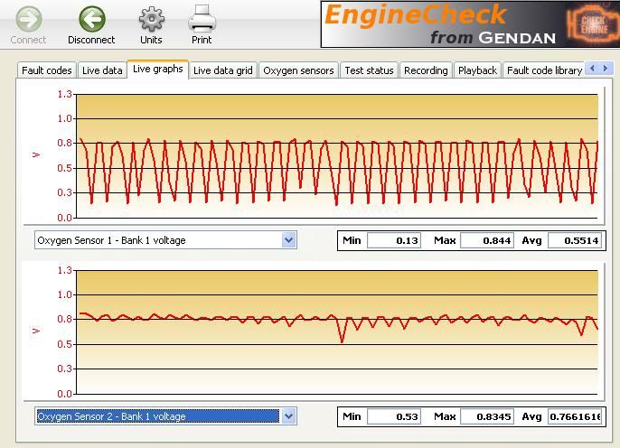

On tickover with a warm engine then the O2 sensors should look like this. Pre cat oscillating around every second and post cat fairly stable
If the pre cat sensor showed consistently high voltage then it might well mean an over rich condition (or an exhaust leak) but with the post cat sensor then it's simply saying "lots of oxygen here after the cat" The cat converts oxides of nitrogen (NOx) to produce carbon dioxide(CO2), nitrogen(N2), and water(H2O) so lots of oxygen there

Many thanks for that! Seems to be exactly what mine is looking like, mine is maybe a touch higher Voltage in the pre CAT sensor but still oscillating as it should.
Hope it will go through the MOT now!
Bugger, just realised you said at tick over, what should it look like at high idle?
