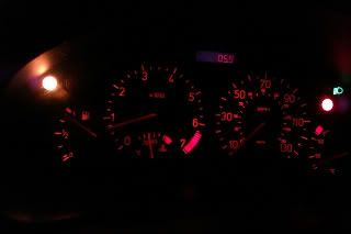

Hi, I have a yellow / amber light at top left of dash which is to the left of the airbag light and comes on with ignition and goes off but then comes back on and stays on constantly,
The symbol is of 2 seated people with seatbelts and possible side airbags either side
sorry about crap pic but it shows where the light is (top left)

Have you turned your passenger airbag off?

No but i tried that, the light stays on whether on or off?
PostPosted: Sun Dec 11, 2011 4:20 pm Up
Looks like you have an airbag fault then I would think
PostPosted: Sun Dec 11, 2011 4:24 pm Up
get the code readed, ebay code reader won't work this time

Ive read that there are connection issues under front seats.
Is that worth a check? If so whereabouts are the connections please??
Thanks
PostPosted: Sun Dec 11, 2011 4:35 pm Up
Right under the seat I think its a green plug

there's 2 plugs under each front seat on non plexed 206's for the side airbags.
The other plug you need to check is the red one.
PostPosted: Mon Dec 12, 2011 11:09 am Up
Crash data or the airbag is switched off.
Loose wires is a flashing airbag light
