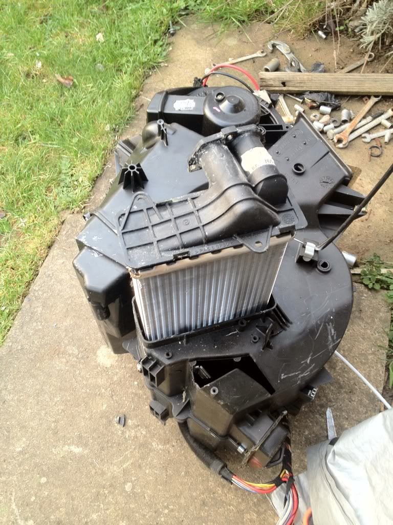

Any ideas on how to unlock the clips holding the twin pipes and the black box together?
I've just been out trying to unclip the thing but nothings working.
Pug 206 GTi 138 Owner.
PostPosted: Thu Jan 19, 2012 10:47 am Up
you pull the clips up and pull the matrix out like this......
so if it leaking from behind that plate it will need new matrix i would say,
if its comming from bottom of the two pipes were they join, might just need new rubbers on joints, in the joint pictured here......

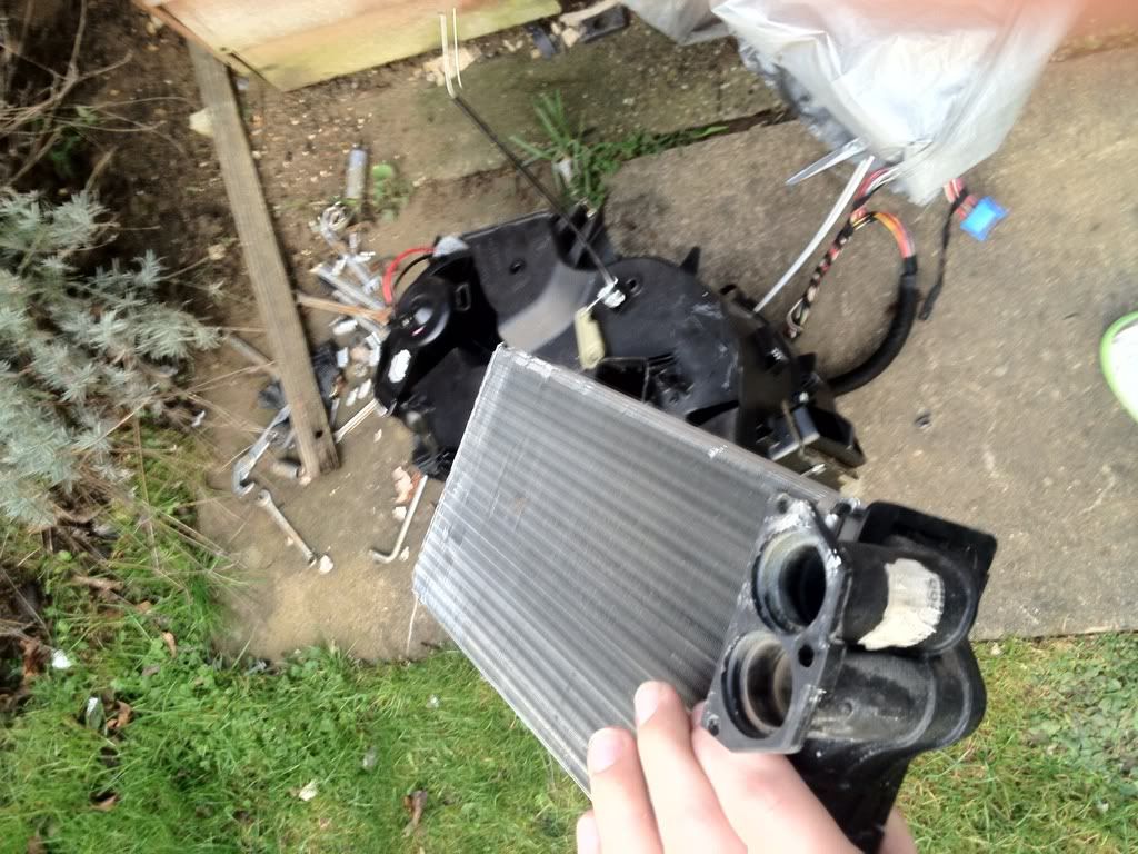

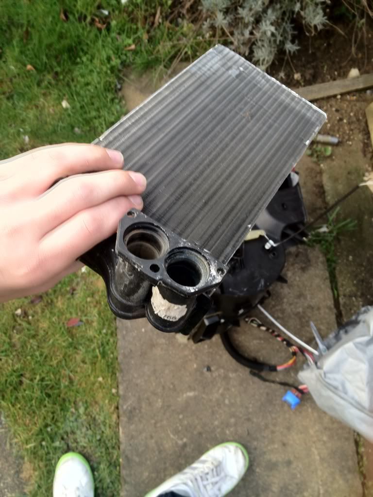

Necro
PostPosted: Thu Jan 19, 2012 11:29 am Up
Joined: May 21, 2010
Posts: 271
Location: Bedfordshire
Got it off. Broke the clips though Sad
Need a new matrix, got a few holes in it Sad
