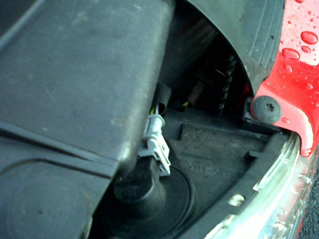

So can anybody shed some light on what this is? its not creating any problems but im just looking to know for reference really
heyziq
PostPosted: Sun Apr 08, 2012 9:57 am Up
Posts: 620
Location: Malaysia
alarm?
heyziq.com
138Andy
Joined: Oct 05, 2011
Posts: 672
Location: Notts
not sure but mine goes into the wing not sure what its plugged into maybe your side repeater ?
PostPosted: Sun Apr 08, 2012 10:04 am Up
Posts: 11530
heyziq wrote:
alarm?
Correct Wink
Sk3rry93
PostPosted: Sun Apr 08, 2012 10:45 am Up
Joined: Feb 04, 2012
Posts: 91
Location: Newry
So alarm then guys? So presumably having this disconnected would result in my alarm not working?

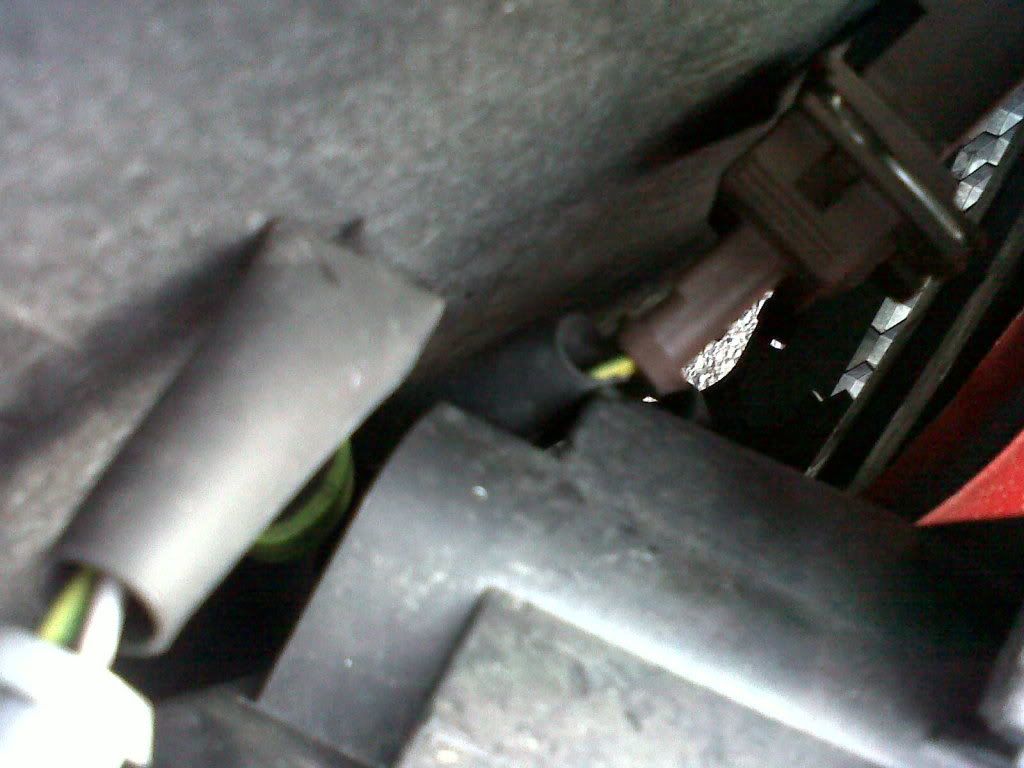

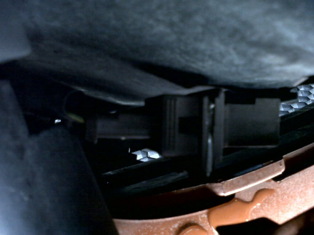

Should be a blue multiplug next to handbrake lever for ultrasonic switch.
Brown plug near boot latch for that sensor & a black plug behind grill next to drivers headlight for the bonnet sensor.
Sk3rry93
PostPosted: Sun Apr 08, 2012 12:18 pm Up
Posts: 91
Location: Newry
Okay ill go have a look see what I can find ....... Okay so no blue multiplug near handbrake no brown plug near boot. But i did find a brown plug behind the grill

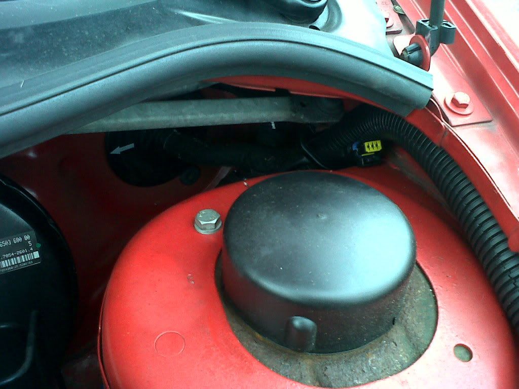

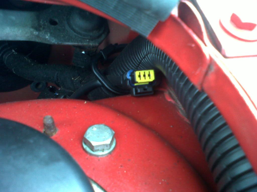

When investigating the engine-bay I found this behind the battery. What could be this? (sorry its a bit blurry Sad )
PostPosted: Mon Apr 09, 2012 2:18 pm Up
Alarm control unit is the BSI
PostPosted: Mon Apr 09, 2012 3:29 pm Up
Posts: 11530
there's an extra black box for the alarm on multiplexed with blue plug one end & brown plug for ultrasonic on the other, clips up next to BSI unit.
