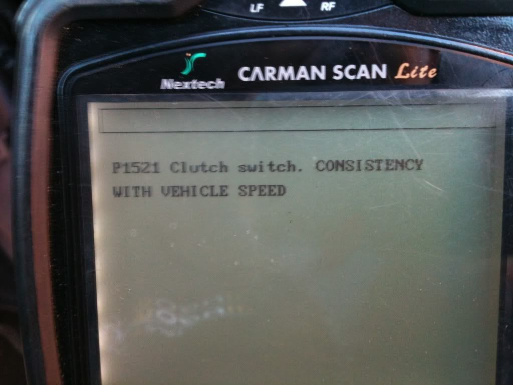

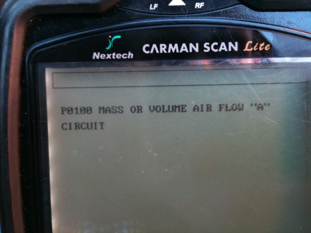

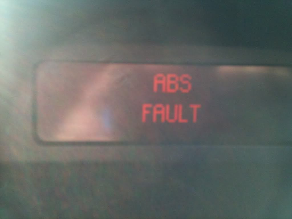

I recently changed the abs ring on the drivers side as the old one was broken, never got an abs fault on the dash until now after changing it, i counted the teeth on the ring tonight, they are the same amount as the passenger side, only thing was the clearance on the passenger side was bigger than the driver side from the sensor, i plugged the diagnostic tool into the car tonight and these are the codes, there is one for the maf sensor but i dont think that has anything to do with the problem. the codes are P1521 clutch switch and P0100 which is maf sensor i think, heres the photos from the diagnostics, its my dads, im not to sure if the diagnostic is a decent one or not and i dont know if it has gave me all the codes from the abs problem, can anyone help? would really appreciate it as i have mot on monday :-/

P1521 - clear it and ignore it usually

Right this is really strange, got mechanic to put his snap on diagnostic machine in and no faults on abs put another diagnostic machine in, it's reading all the abs sensors and they are all putting out the same reading equally I was looking at it while we where driving, the light doesn't come on all the time just occasionally, the mechanic recons it's the abs pump, could it be faulty fuses or something straight forward?

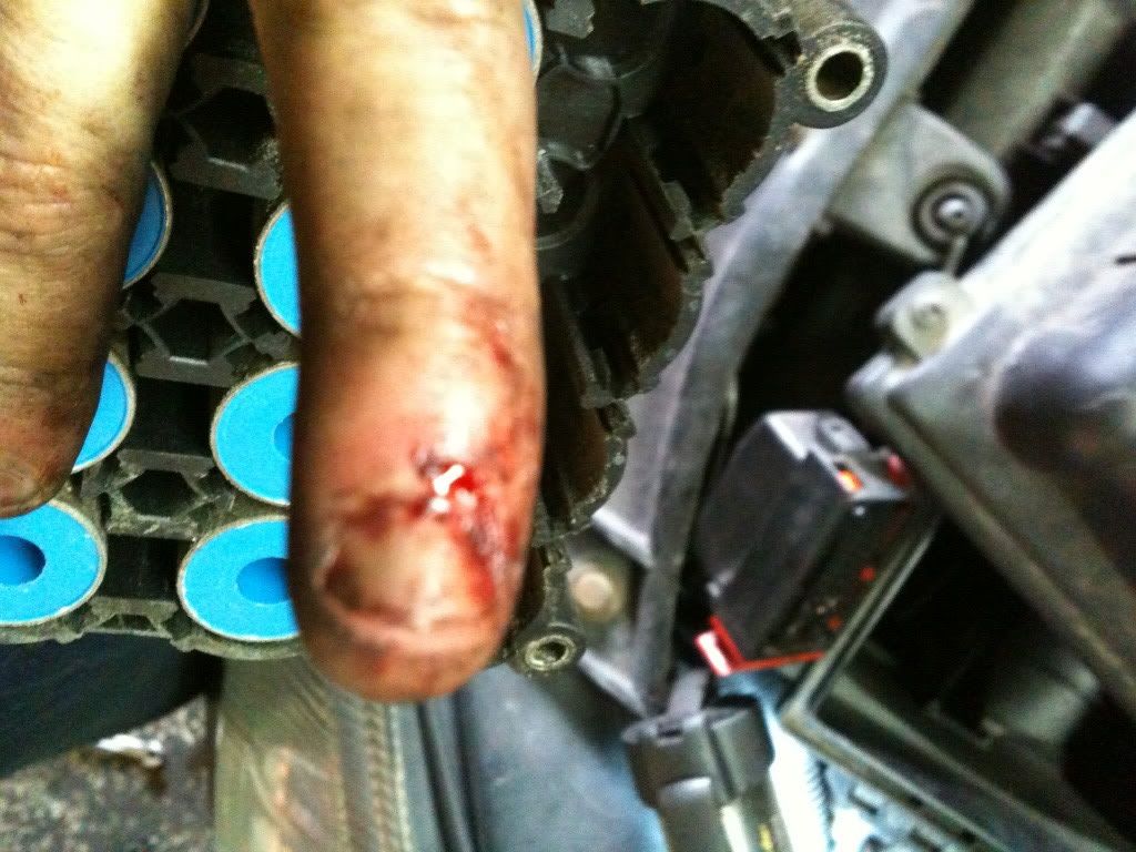

cheers for the help guys, fitted the pump this afternoon, busted up my little finger slipping on the brake pipes going to the pump, had to take off the housing that holds the air filter then take off the whole bracket that holds the pump, if anyone ever needs help on removing a pump give me a shout, obviously not the exprerienced people on here but people who dont have a clue, seen a few threads with people asking how to do it, the bleed screw ended up getting a bit of rounding the little sh-it was rusted solid, ended up draining the whole brake system and just put new stuff in.
Yeah lee its a bit much for equipment, but even my dad was telling me earlier who knows the same guy, he agreed and said he paid that for all the equipment, computers etc, i think he gets the arm into people who he doesnt know to get his money back on the machine, probably got robbed by some salesman lol
ps heres a photo of my finger.... lol
