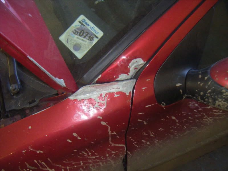

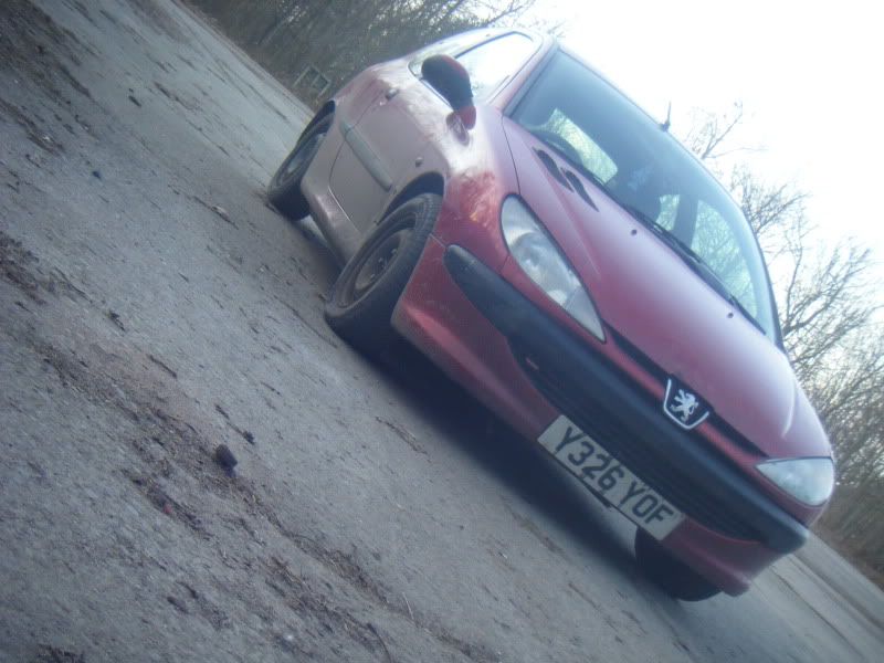

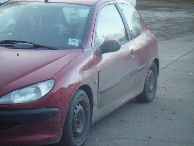

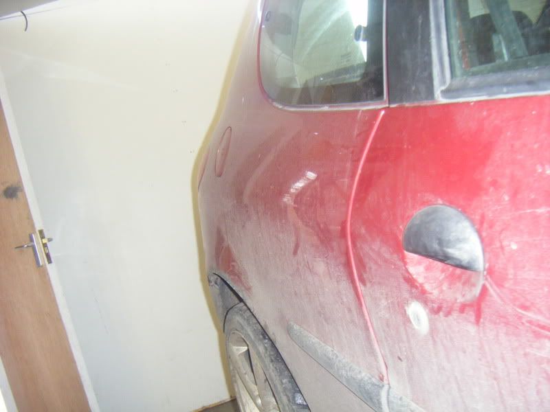

hi just tought i would share my latest project with you all
the damaged car is a cat c due to the pillar damage......to be made into a work horse lol
car:
1.1 Laughing with k&n induction kit
suspension full brand new rear axle and torsion bars etc
with weitec shocks on rear lowered 45mm aprox
front weitec shocks and springs lowered 45 mm aprox
body work issues ..........
both rear qtrs damaged and dented
both doors damaged due to wind
both front wings beyond repair
ns pillar damage
bonnet damage
bumpers split and heavy gouges
wheels sitting on std 14 " wheels but 17" toora 5 spokes to be fitted
bits i have bought
2 new doors full of dents but best i could find
1 new wing
1 new bumper with spot cut outs
1 spoiler
2 rear window panels
1 set of skits
full respray/ colour change
pics......
more to come ............ Very Happy Very Happy

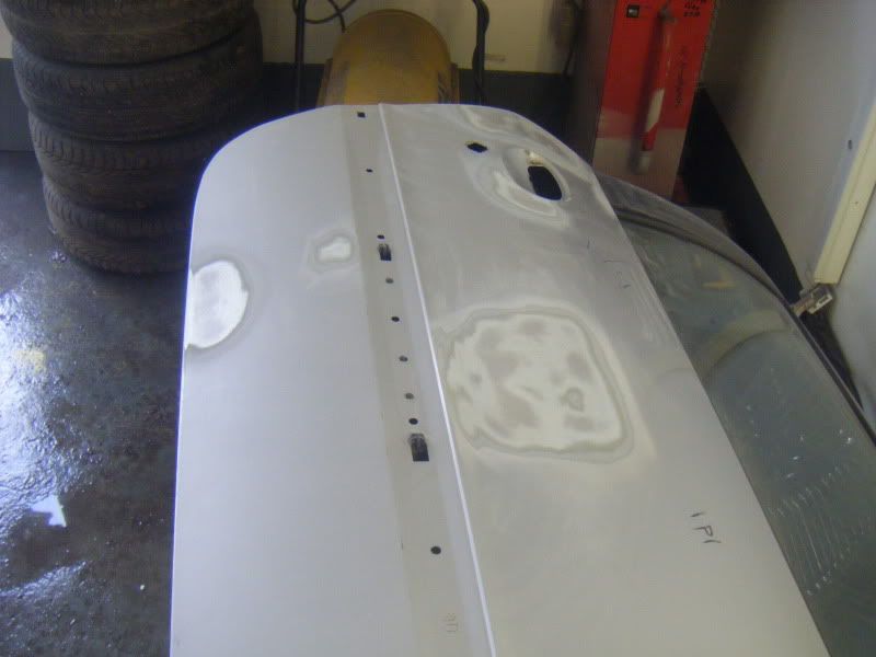

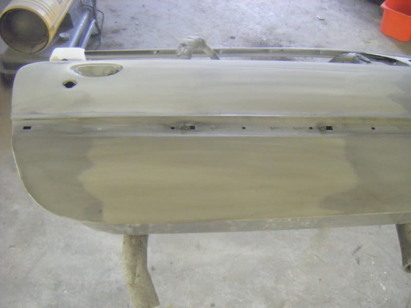

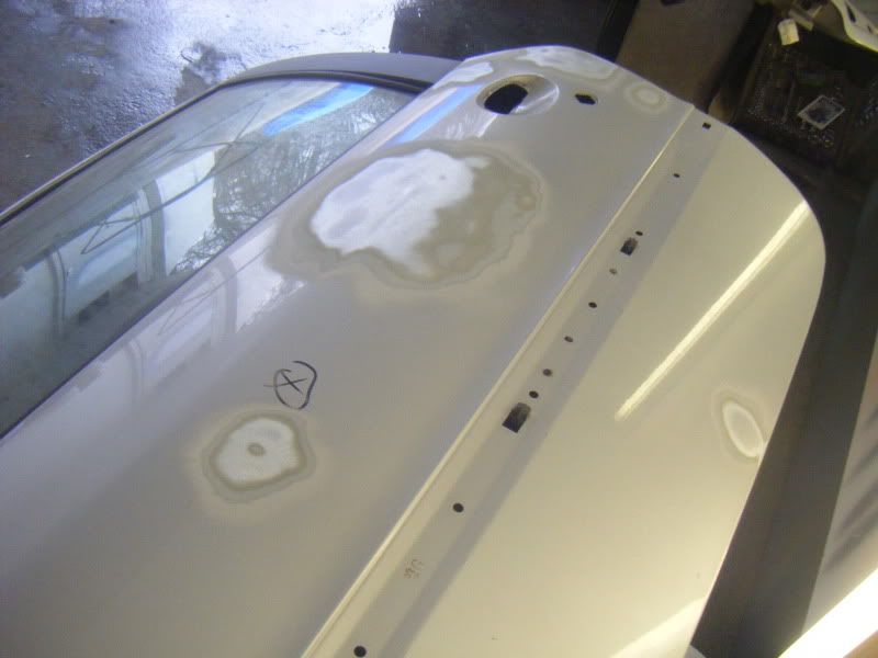

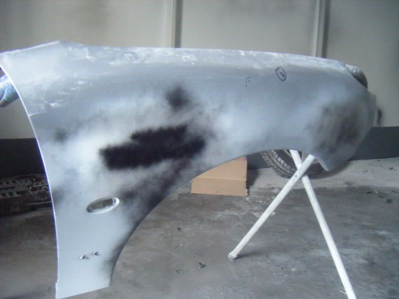

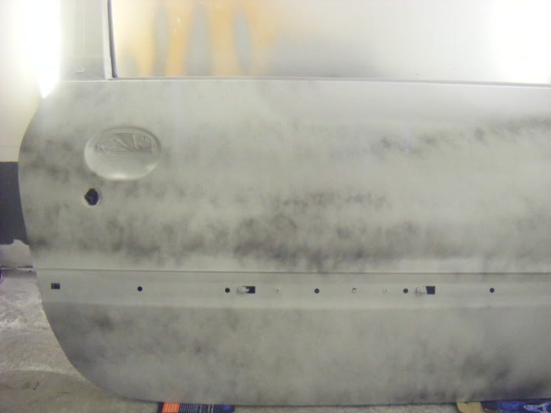

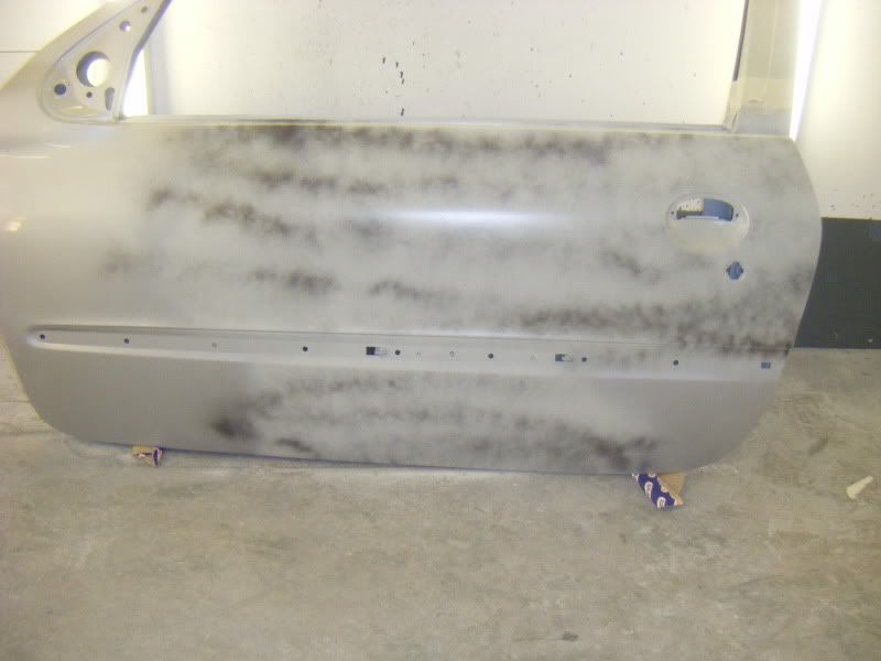

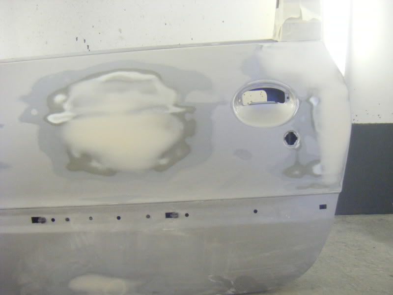

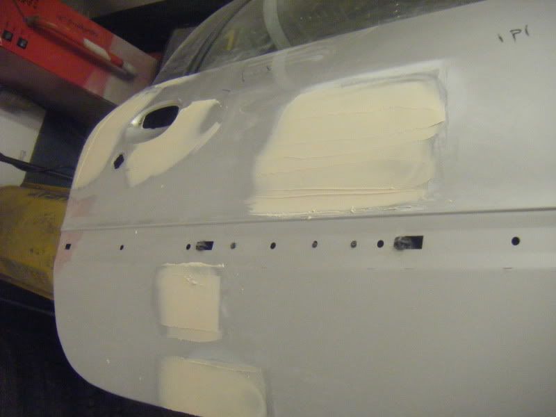

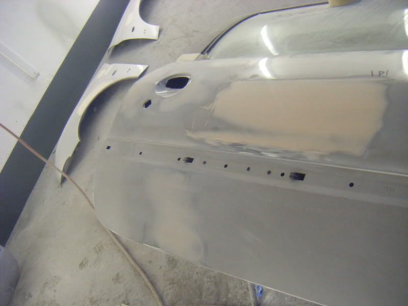

COUPLE OF PROGRESS PICS FROM TODAY .....
DOORS ..
FILLER
FILLER SANDED READY FOR PRIMER
WING REPAIR
PRIMED REPAIRS AND BAKED
THEN BLOCK SANDED AGAIN WITH 180-240 THEN REPRIMED
THEN THE DOORS AND THE REPAIRS ARE PRIMED TOGETHER
These will be left over night and re-sanded ready for paint
more to come
