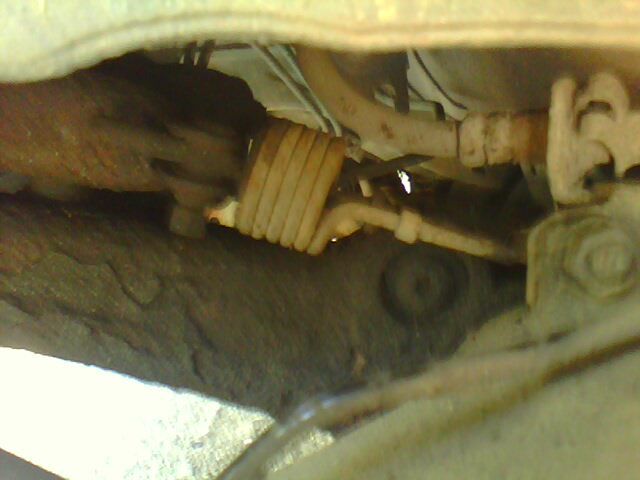

found this spring is lose can move it side by side. is it ment to connect to anything. wot does it do??
PostPosted: Fri May 25, 2012 12:40 pm Up
that's brake compensator, it supposed to move

mine very lose tho will get vid

is it ment do that?
PostPosted: Fri May 25, 2012 12:59 pm Up
no....
looks like your spring is broken or loosen..
it suppose to hook up onto the trailing arm.

do u have pic of where it hooks 2?

is that brake hose sits
PostPosted: Fri May 25, 2012 1:17 pm Up
yes..near to that. i believe you meant the metal brake pipe

i see now . now got pop it back in sum how

That is the rear brake compensator and I had the exact same thing recently.
If it's so loose to the point it's rattling when you press the brake pedal, that means your rear brakes
are hardly working at all because not enough pressure is getting to them by the hydraulics.
You'll find the car doesn't 'dive' so much at the front whilist braking when you sort it properly.
Make sure the spring is just tight-enough (by adjusting the collet screw holding the pin), so it's not rattling.
Do not stretch (tense) the spring at all because that would make the rear wheels skid really easily, esp. if there is no weight (people) at the rear of the car when hard-braking.
It might be worth trying-out a few times to get it just-right OR take it to a garage to have it set for 75% front 25% back ratio as recomended by the manufacturer. It is a safety issue after all, and is absolutely checked by the MOT.

always learn something new.
i never know you can adjust the compensator, always think they are self adjusted.

i cant seem get it to undo so can pull it back so it tight

I havent got a compensator Sad
Mines part of the ABS unit Laughing
As for adjusting the compensator, you really need to follow the correct Peugeot setting procedure & that means using special equipment.
