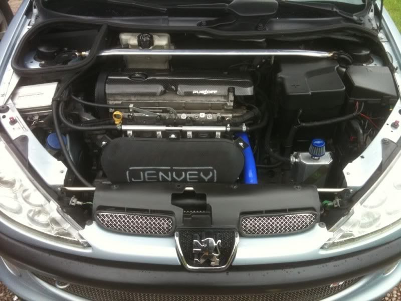

got the car back today and i must say it looks and drives mint! cant really get any pics atm as the weathers being crappy and i'm trying to get stuff sorted for the show 2moz as well as doing a few jobs for people.....just hope the weathers not this bad 2moz lol
edward...im glad i went for the bonnet pins they look fantastic

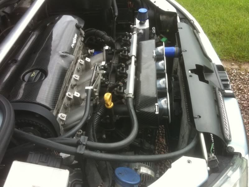

Edward: Personal prefferance mate I'm just saying glad I decided to have them put on as it looks a evil now, I also utilised the standard rad so no need to buy an aftermarket/outher makes rad as the standard one fits spot on. I can say the elec pas is alot better than belt pump.

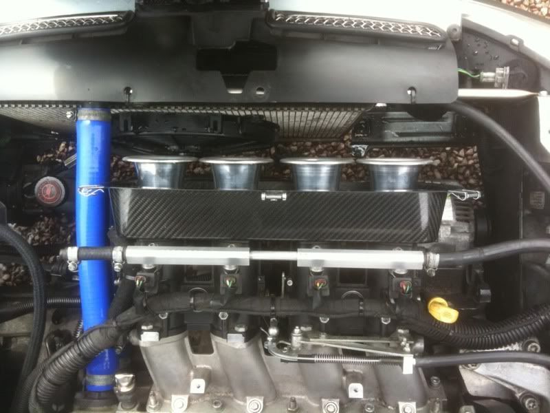

What pump have you used? You used the standard radiator but fitted longer trumpets too?

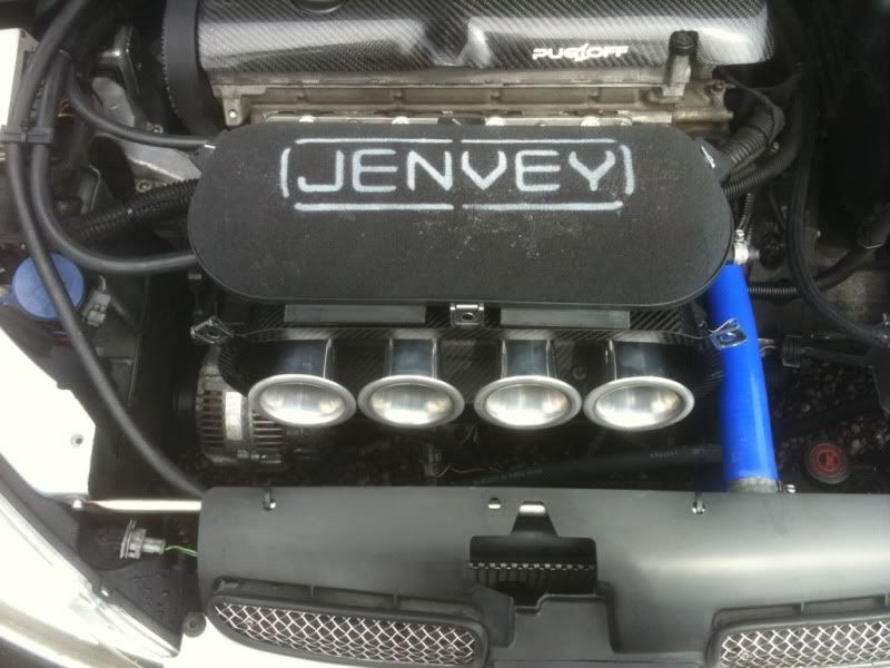

A 106 pump and yes standard rad with 80mm trumpets I'll post some pics ina bit

Looks neat enough but I wouldn't want the lower cross member cutting. I like the deep box for the filter.

It hasent been cut Paul a custom bracket bolts to the crossmember then the rad is bolted to that it's also a tad higher than the bumper so is by far high enuf for day to day use I.e speed bumps ect.
And I think it feels a more positive feel when turning, no slack when turning the wheel I don't know why they took so long to Introduce it. It also feels more punchy mid range and picks up alot quicker.

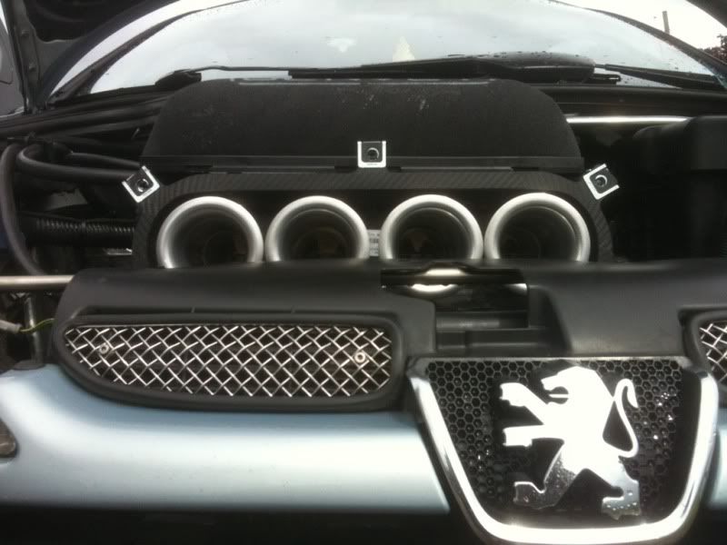

Also will have a custom fabricated sheet under the intake to force air into the filter when I have my badgeless grill I'll be getting rid of the top mesh.

Good stuff...I wonder if any sort of vent could be put in the nose of the bonnet to let air flow in easier...

I'd rather it to be fixed to the car and go up underneath the filter I think that would be easyer for my application
