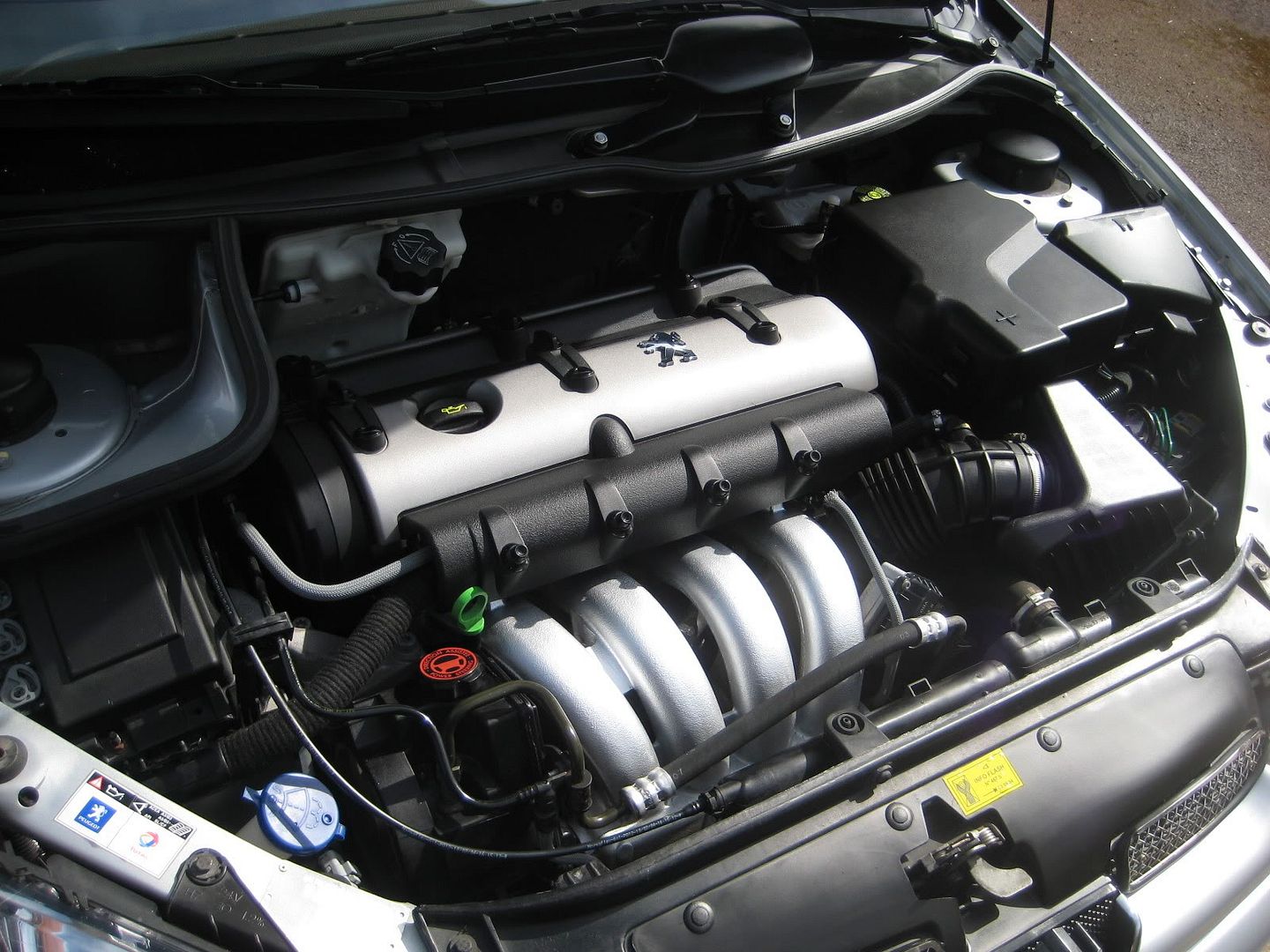

Hello,
I have a problem which I hope you could help me with.
The thin pipe that connects the coolant bottle to the left side of the radiator is leaking at the joint on the radiator end.
Drip, drip drip like a tap - I have to refill with water once/twice a day!
I have had greenflag look at it who said that it is the clip that hold the pipe in place and i need a new one (which is impossible to find)
The garage had it all day and they fitted a new pipe but it still leaked.
They suggested that I could get a £28 radiator repair kit though they are not sure what is included in it and if it will work. They also suggested a new radiator, though again, it depends if a clip is provided or a different way of attaching the pipe...
Even if I remove the clip and push the pipe in by hand, it still drips at the joint...
Do you think it would be feasible to get some plumbers/duct tape and wrap it around the end before inserting it into the radiator, to make the joint tighter?
Options/advice is greatly appreciated! I don't know much about cars...

Can't work out if anythings incorrect from the pictures
Yes use some PTFE tape will improve it for sure, may even fix it

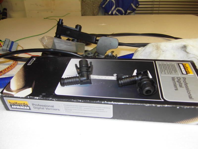

Is it a new radiator? I think those clips allow the old hose to be attached to the new style radiator.
You've only got part of the clip there... I'll check my stash. By the way, a pack of 3 from the dealer is over £20!
These are similar. A pack has a straight clip and 2 x 90 degree bend clips. Cant see why it would leak though. The part you have just locks it all in place.

Are those actually what is pushed in the pipe and then you place the plastic end in the radiator? - The mechanic mentioned that it would be great if you could get them. - Do you know what they're called?
The guy in the garage compared the clip to another peugeot he had in for repair and showed me the clip, it was the same, just a fraction bigger. I can't find any anywhere!
Yep it does appear just to lock it in place. Though without it and me holding it firmly in, it still leaks. So I am of teh mind that it isn't just the clip that its the end of the pipe that pushes into the radiator in general - I don't think the seal is good anymore, but why would that change now?

I'm very certain that's not the original radiator. Newer cars from the factory use that radiator with a thinner hose going to it. The hose has a clip like that built into it. Those silly clips allow the use of the old thicker rubber hose like you have fitted. I actually believe it's called a radiator repair kit. It's a rip off for just three adaptors.
You can't use a hose and jubilee clip directly fitted the radiator either. The inlet isn't round.
I'd take it all apart and get some sealant on it. Then put it back together, let it dry and top up the coolant if necessary.
