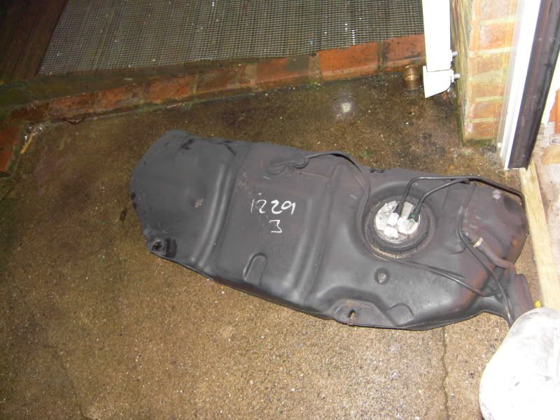

I'm talking about the pipe that goes from the filter up into the car, alongside the tank. im wondering whether taking the tank out will give me better access to the pipe because at the moment it's very difficult to fix from underneath the car! Need to know where the pipe goes?
Edward is it ok if you link me to the page in your project thread with the fuel tank off as its 60 something pages long ha!
PostPosted: Mon Jan 21, 2013 8:41 am Up
Posts: 7047
The pipe that goes over the tank can be replaced without moving the tank. It's a bit tight between the body and tank but it can be done. Is it the tube going into the filter that's broken off?

In the 2nd picture you can see the pipe I'm talking about. The one that has the three junction on it that goes into the filter. But it's not the tube going into the filter, it's the bit that goes up onto the top of the fuel tank that broke off meaning the pipe is basically unusable. I've bodged it for now but I really don't think I can remove this pipe without removing the fuel tank.
Is the fuel tank easy to remove?
PostPosted: Mon Jan 21, 2013 11:00 am Up
Posts: 7047
You access the top of the pipe from under the back seats. You do not have to remove the tank to replace it.
