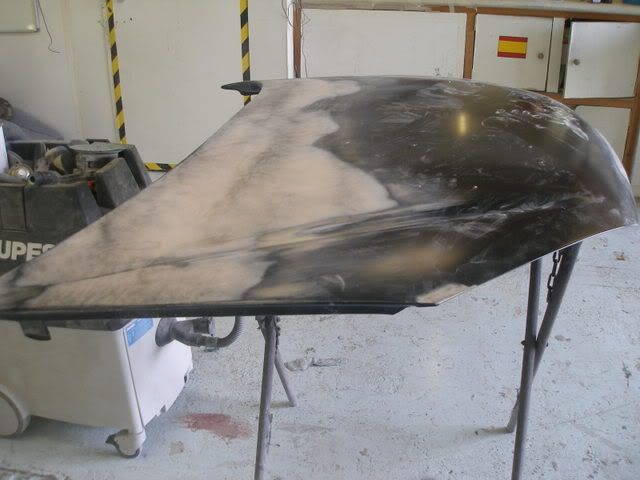

Also had a new bonnet made (as I decided to weld up the holes on the back without think it would act as a water trap, Basically bonnet was in practical) And I had a new boot made at the same time as I wasnt happy with the old one. Work done by xsquisite.

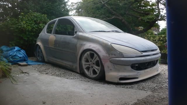

Had a couple of days off work this week so got cracking with the arches. The rears are pritty much done now. I decided to use Mk2 Golf arches as a base and moddify them to fit. I f**kin love em now.
Few pics, dont have any of them as they are now. Them reason for the duck tape is i wanted to make sure they would fit before I fitted them properly. Il get some pics when I next have the wheels on!
I also did the front arches but they just looked dog poo so I ripped them off. They were way to big. Although a rethink has led me to blending a set of SP arches in which works with the wheels alot better!
Update 30/04
Just a small update. Not a lot has gone on over the past few weeks.
After extending the arches I wasnt happy with the way it left the rear bumper looking. The arches seemed to have taken to depth and width look out of the bumper. So with a single change I turned it from this:
To this:
I think the changes maintain the factory look of the bumper although its now 4" wider at the bottom. It also makes the arches look more factory.
Unfortunatly I do not have any pics of it on with the rear wheels on, but as soon as I do I will get them up.
Work is currently focused on the front arches. Which are turning out to be a bit of a ball ache. But I finally have something that I can work with.

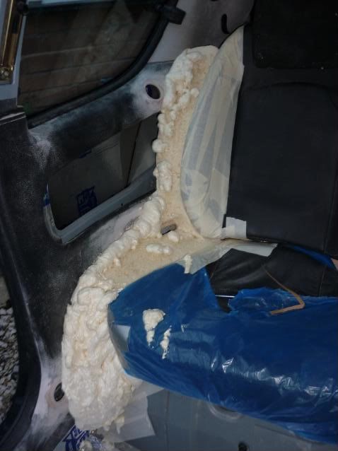

I have also began to build my cc rear bench into the car (not an easy job) After a couple of failed starts I have now come up with something that has worked well. Still a long way to go though.
Created a fibreglass mould of the underside of the seat, to provide a level of support when your sit on the bench. I made the fibreglass reletivley thick to provide a great amount of strength.
I still Need to mount this secruly to the false floor.

Well I have been busy working away getting the interior built. Since my last update I Have been working on the rear seat mouldings, which are coming together well. Nothing has had any filler appliied yet as I want to get all the fibreglass done then it will allow me to make any alterations I need to make.
Some pics of the foam work coming together.
I have now applied the fibreglass but I havent got a pic of it as yet. I have also Fibreglassed the sub box.
Currently working on the final peice of the rear seat mouldings
Pic with parcel shelf in.

Calipers Fitted
New wheels had to go as the old ones didnt fit over the calipers
Its close lol
Sorting the wiring
Black mask headlights fitted
Love this

>Gti sports bumper with Mekur Angel front splitter reshaped and smoothed in. Front fogs and number plate recess deleted.
>Esquiss badgeless grill
>Bonnet vents, badge recess and washer jets removed. Top edge reshaped.
>Ariel removed
>Gti sports wings fitted with smoothed off side repeaters
>Door handles and locks shaved
>Reiger sideskirts blended into the bodywork
>Ecosse Porsche 911 mirror conversion
>Bootlid number plate recess reshaped
>Sports rear bumper cut & extended 70mm, toe eye and exhaust cut out removed
