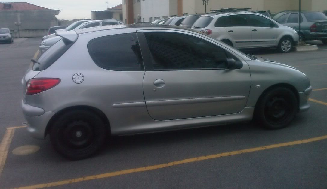

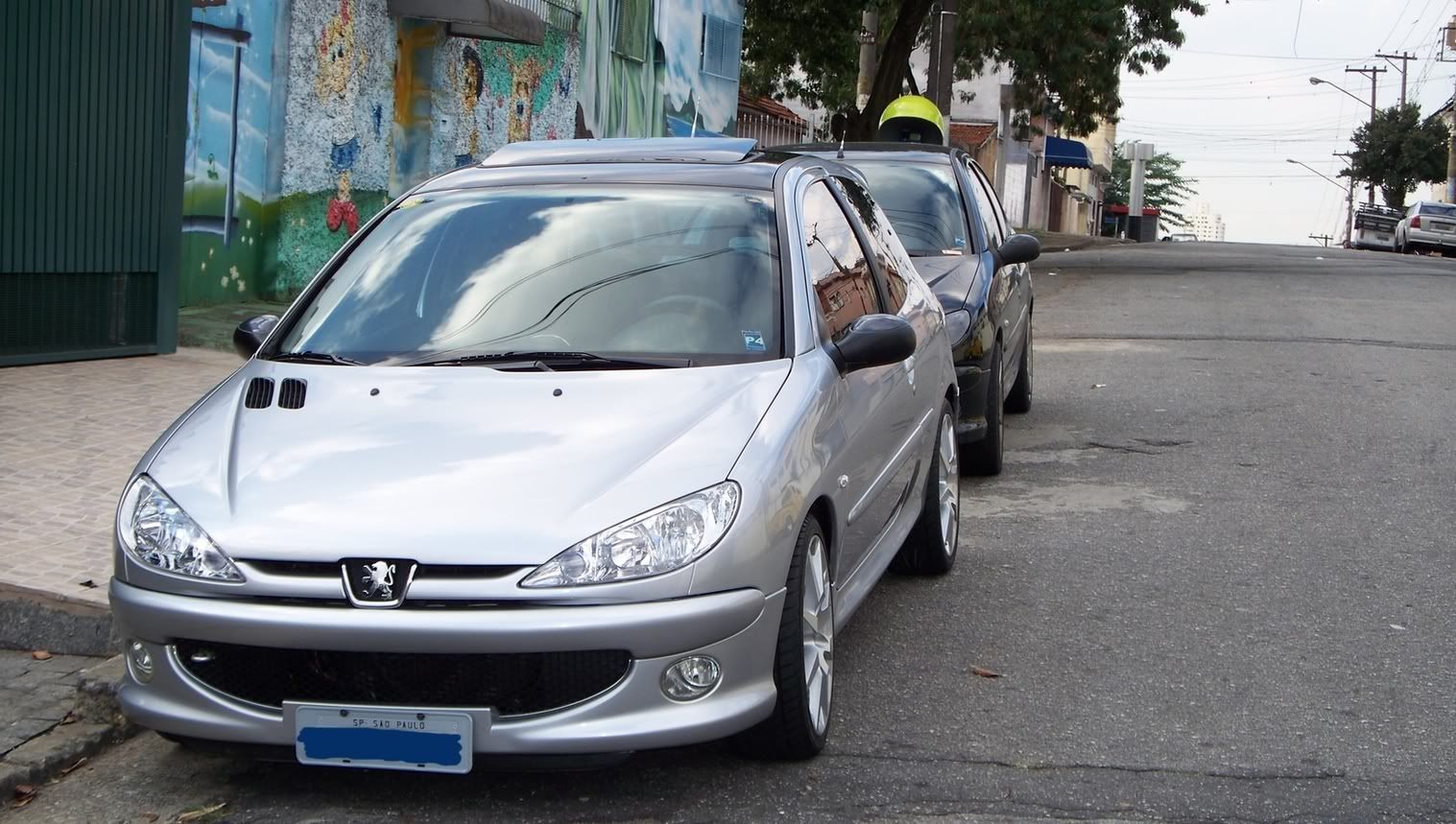

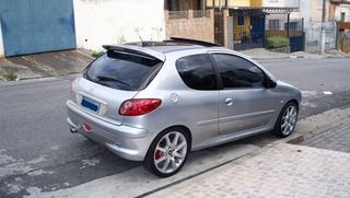

Complete Car (the silver is the 2.0 and the black is a 1.6 16v for everyday use)

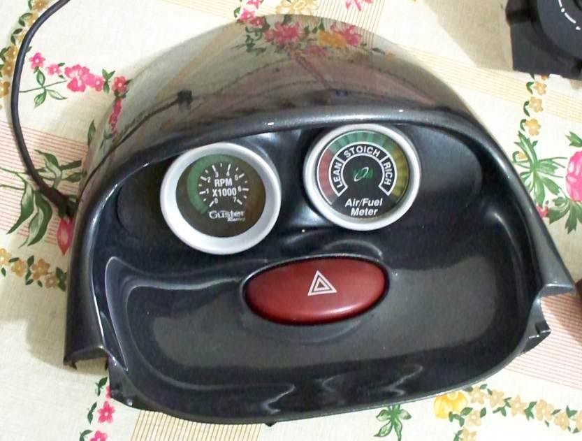

Speedometer from a Xsara Picasso in the 206 dashboard:
RPM and hallmeter

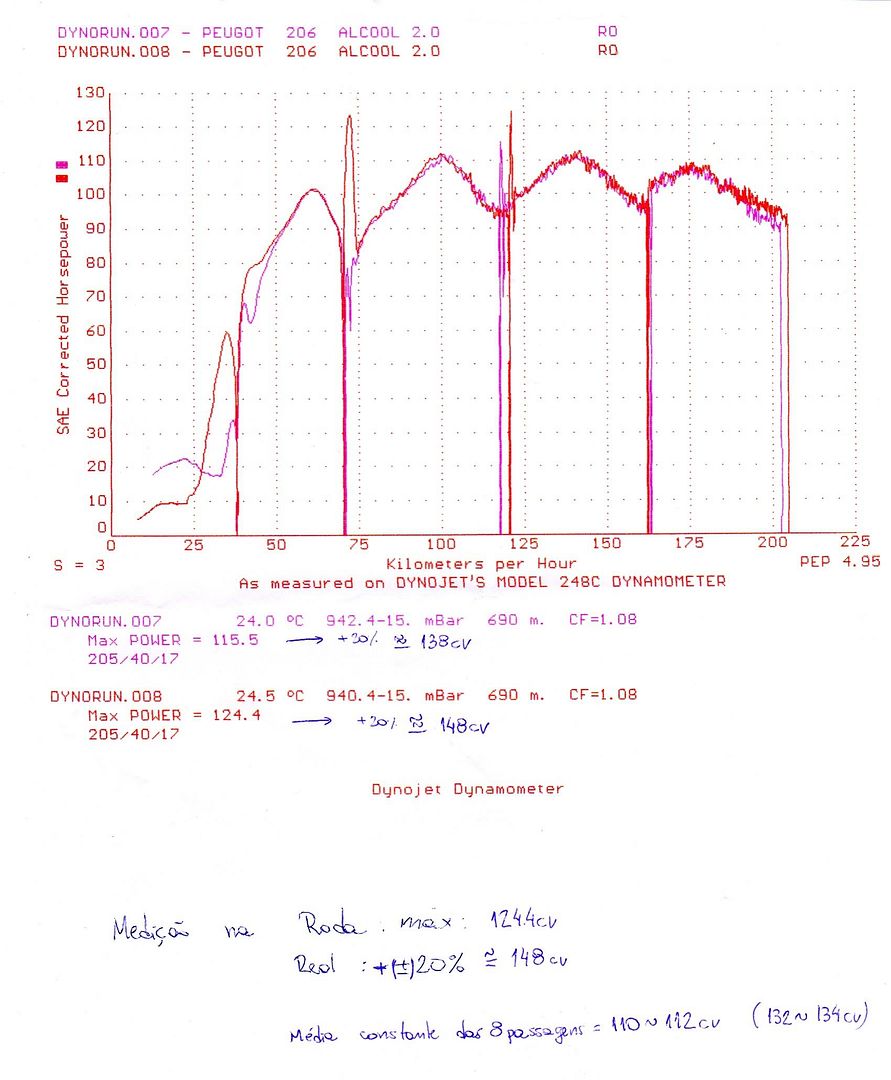

After this first phase, I took the car to the dyno and could confirm the "original" performance, with 125bhp on wheels and top speed of 219km/h
A video with the dyno run:

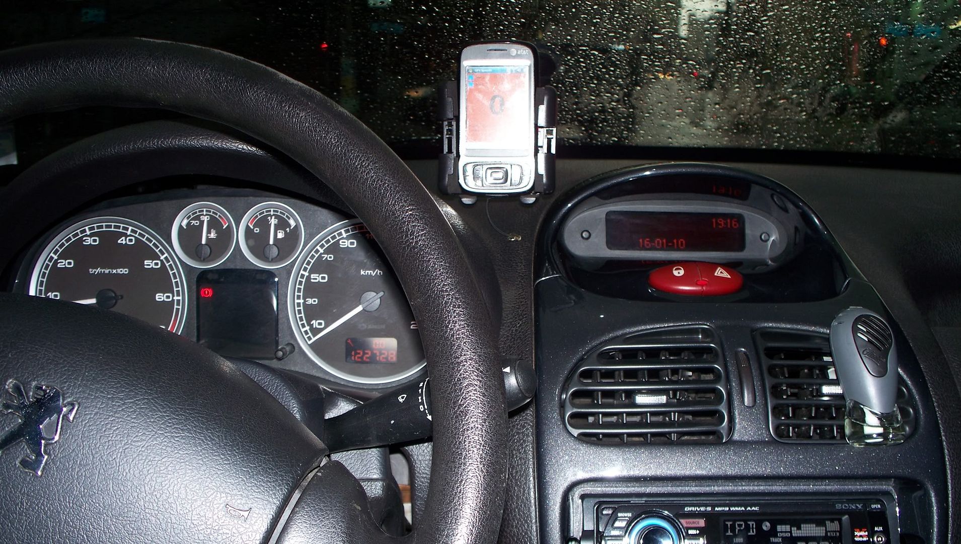

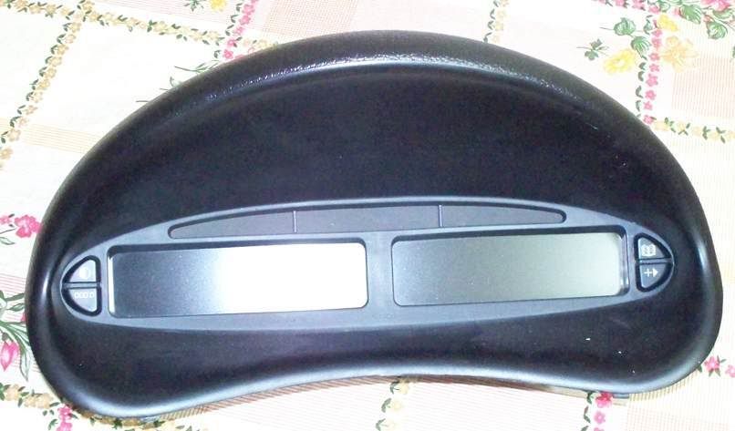

Here are some pictures of the dashboard afther the 307 based project :
After all that I still have some problems:
- the donor 307 had ABS and because of that I don't have the speedometer working. The 307 system relies on the Speed Sensor which comunicates with the ABS and then sends the speed info to the dashboard via CAN network through the BSI. Since my car didn't have ABS and I didn't know that the ABS would be necessary, when I bought the 307 parts I didn't include the ABS system. Now I'm fighting to find a way to have the speedometer working. If I can find the same ABS ECU from the donor 307, I may put it to work... the problem is that it is a very hard model to find, a Bosch 8.0 assembled unit (hydraulic + electronic unit)

SOME PICTURE UPDATES:
As of today (Feb 2010) , this is how is the car, for trackday use so far:
The engine:
And the interior:

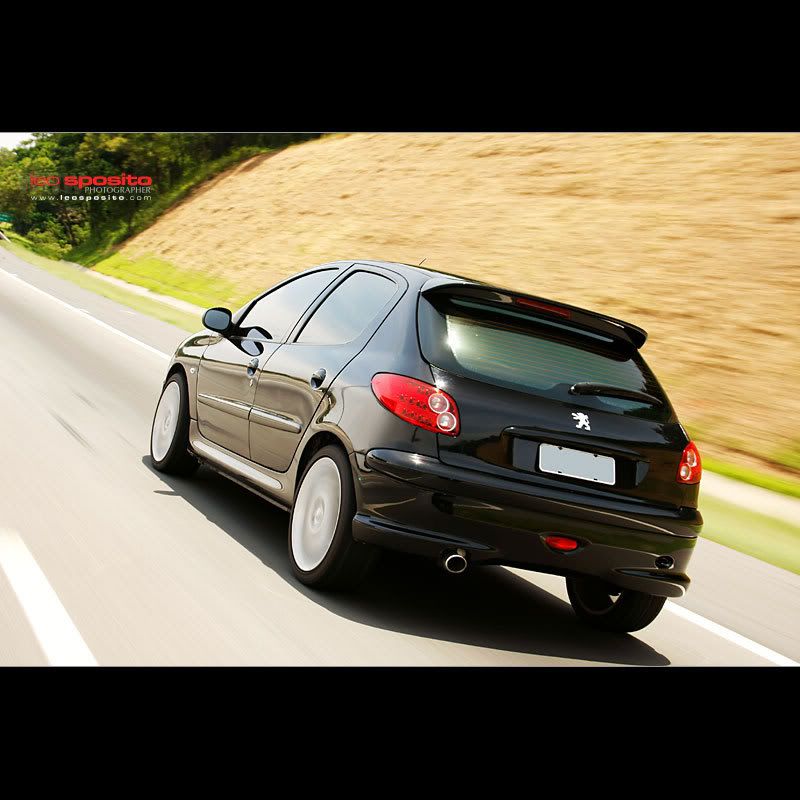

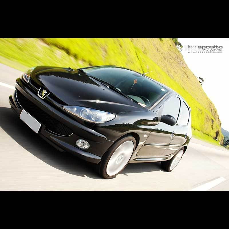

about the black: yes, those are the 207 wheels. I imported from UK, since it was not available here. It was 2 years ago, when the wheel launched overthere. Now it is already available here in Brazil at regular peugeot dealers.
some pictures for you:
This was my first 206, with GT kit:
This is my second 206, the black one you asked for pictures. These are when the car arrived, original:
After some modifications:
And some pictures a friend of mine did for me:
Hope you like them.

wagsy206
PostPosted: Tue Feb 09, 2010 12:39 pm Up
Posts: 776
the 307 dials actually look quite good. but the picasso speedo is also an interesting idea.
were the 307 dials just plug in and go or did you have to change anything?
in my case I changed all the electronic system (BSI+BSM+ECU+loom+speedo). So it worked fine because it was a full swap.
I had plans to install the GTI180 speedo and looking for pictures it seemed to be the same connector. Yesterday I got a regular 206 muxed speedo and tried to install but it didn't work. First the connector has different locking system. I removed the lock and connected just the pins directly through but didn't work at all. So I believe the speedo for 206 and 307 are not compatible. At least the models that I tested:
my "307" system is the 1st generation (CAN-VAN) , but there are 2 more generations after that. Maybe some of them is compatible with the 206.
