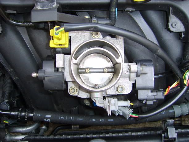

GRRRRRRR!!! Bloody car, so today i have replaced the lmbda sensor, map sensor , air temp sensor and air idle controll valve still cant work it out and its getting expensive Sad
on the gti throttle body at the back of it there are 2 hoses 1 comes from the right hand side and goes to the head and the other 1 goes off to the left and dissapears, questin is what does that one on the left do?
I think the left one goes to the fuel tank or the charcoal filter in the inner wing.

u might be right i managed to trace it as far as wing
