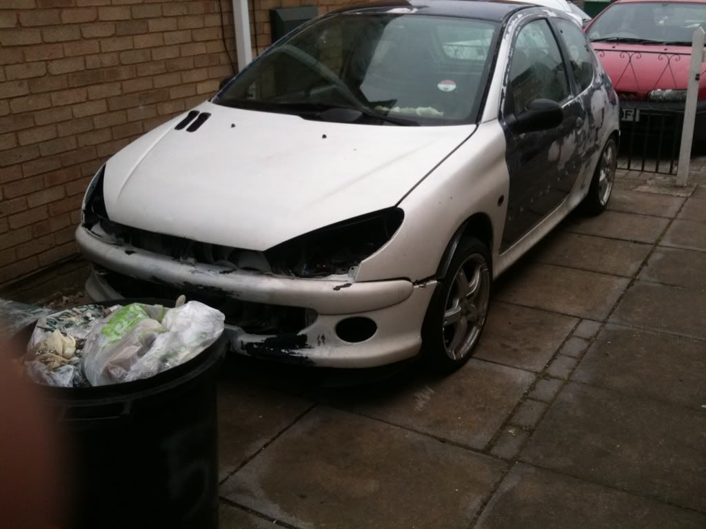

Well all I'm doing ATM the min is lay a cloth on car and pour thinner on cloth (holds it self to side of car etc)
Leave it 5mins, take off cloth and it's all bubbled up.
Then just remove it with credit card type card.
So very easy ATM requires no effort Laughing the tough bits I will sand.
+ this methord there is not White dust flying everwere all over next doors car lol

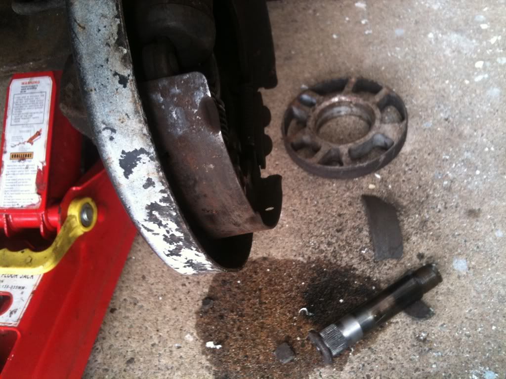

got brakes sorted so its safe to move around (as it had none at all) the rear was bad, the hub nut was cross threaded grrrr (32mm btw Wink ) and also couldnt get the hub off to save my life so just hit the stub axle out to get hub off,
bearing also naff on that side but planning on disc conversion anyway. (bloke had done other sides brakes) main thing is now it dont roll off drive or i have to use the reverse and 1st to brake when moving it around Laughing
also removed a bit more paint Very Happy

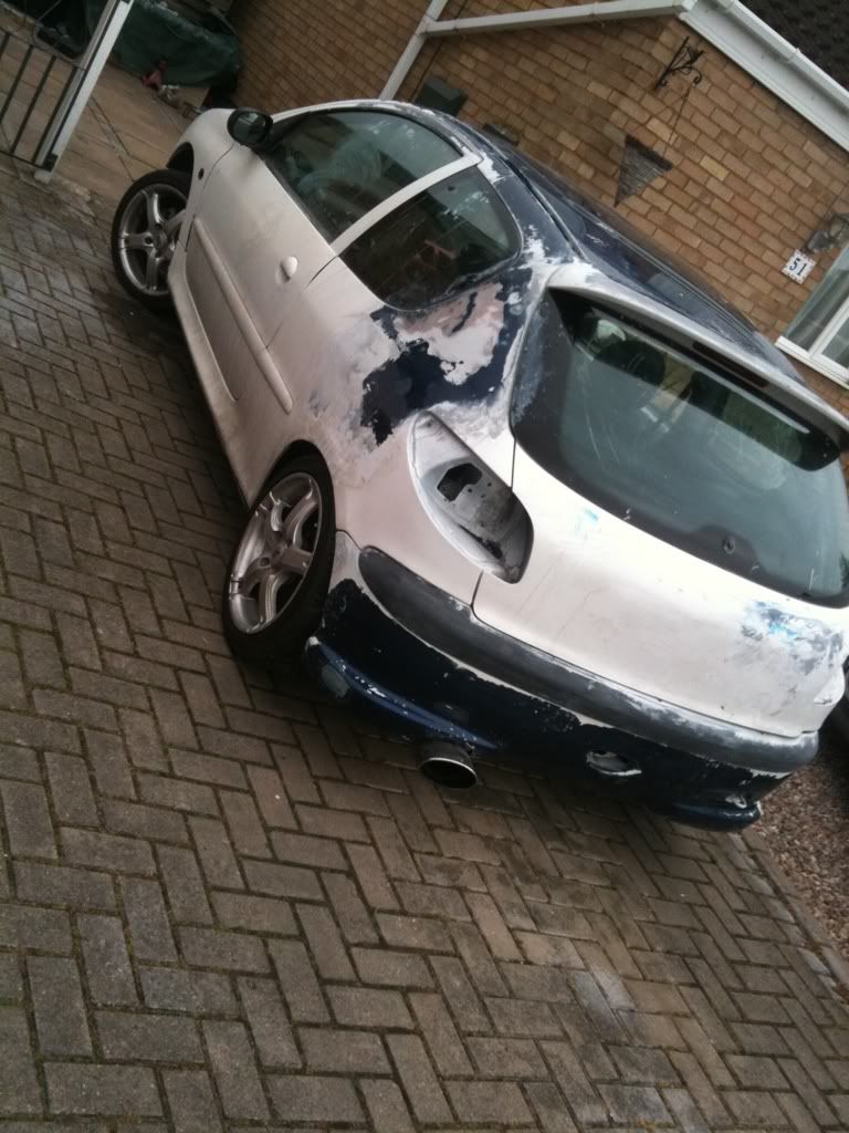

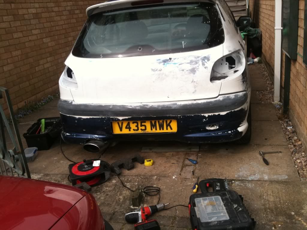

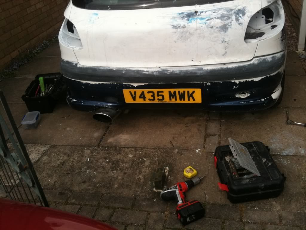

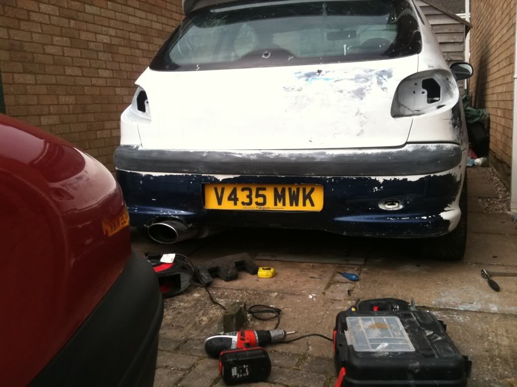

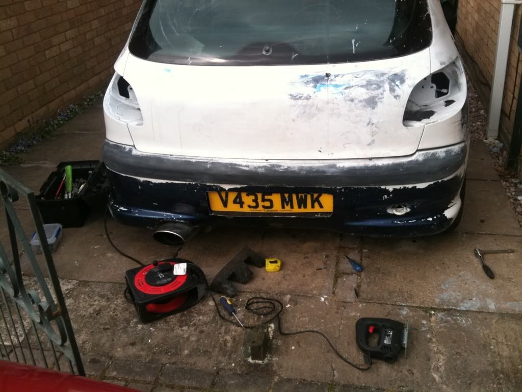

PostPosted: Sun Mar 27, 2011 11:05 am Up
Started 1st of many many many mods today, note this is STARTED not finished, got the back and sides of holder to make and put on, numberplate been held in temp to see what it looks like.......
bit more paint removed too....
thanks god im going to replace the front wings and bonnet Laughing
thanks for looking Very Happy
