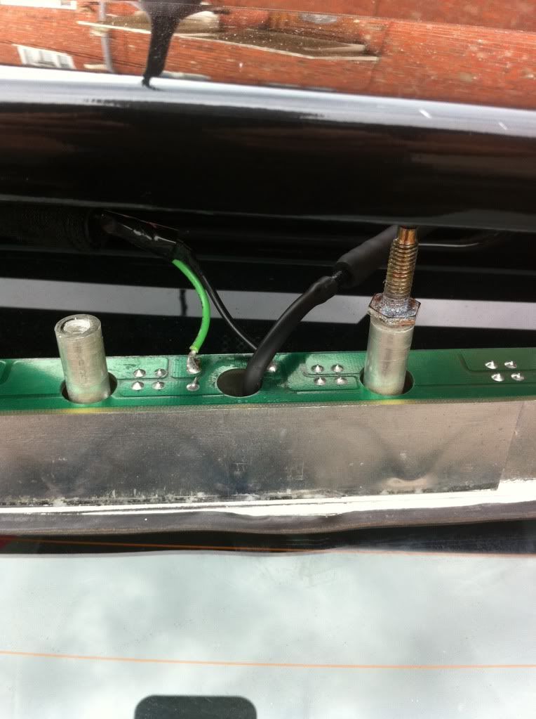

I've just received my smoked 3rd brake light, I also put one on my other gti before, however came to take the clear 3rd brake light off and instead of the little plastic connector for the electrics this one has been soldered on, here's the pic
Can anyone tell me what I have to do to connect my new one up, here's the connector hole, you can see it's got 2 little metal pins in it

well your definitely going to need a solder iron to get that off the car in the first place! and because your car hasnt got the plastic connector for plug and play you may have to solder in the new one aswell!

I gathered that much lol, I've got the little plastic thing that goes into the connector of my gti, thing is both wires were green on my gti and there's one green and one black on the 180

Get someone that's breaking a 206 or a scrapyard and wire the connector back in.

I've got the connector as I'm breaking my gti but don't know which wire goes in which side mate

if it was me I would unsolder that, get a plug from a scrappy / pug and connect it up OEM style, then plug it into the light
depending on the year of 206 either could be the earth, test it: light bulb on a wire, and connected to the chassis of the car, the positive one will make the bulb light up when the pedals pressed, the ground wire wont.
be sure to unplug the battery before wiring it up though, and when unwiring it.
