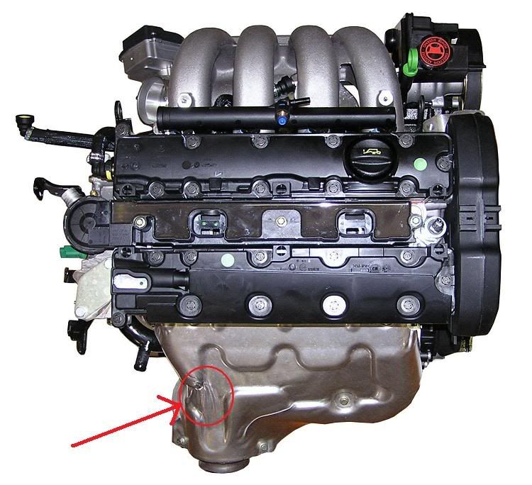

i194.photobucket.com/a...mabove.jpg
the vvti solenoid is the sensor on the right hand side of the coil pack, (looking at that pic) its actually on the left looking at the engine, its held in with a allen key and just pulls out, but be carful not to drop when its out as its very delicate and rather pricey i think

http://i194.photobucket.com/albums/z44/kieronpunto/180enginefromabove.jpg
