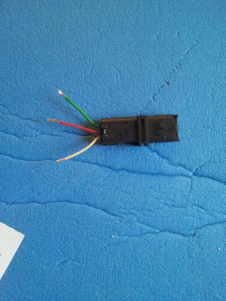

OK,
3 wires..Red ...White.....Green.
Dip light on give a circuit across Red+White and Green+white.
Main light on gives a circuit across Red+Green and White+Green
Which is the live feed for Dip and which is the live feed for Main?

Come on guys, 34 reads but no answer.
If I had a multi-meter I could probably figure it out but only having a bulb and some wires I can only test pairs of wires for a circuits.
I have a feeling that the live feed for dip beam is the White and the live feed for the main beam is the Red, leaving the Green cable as a neg.

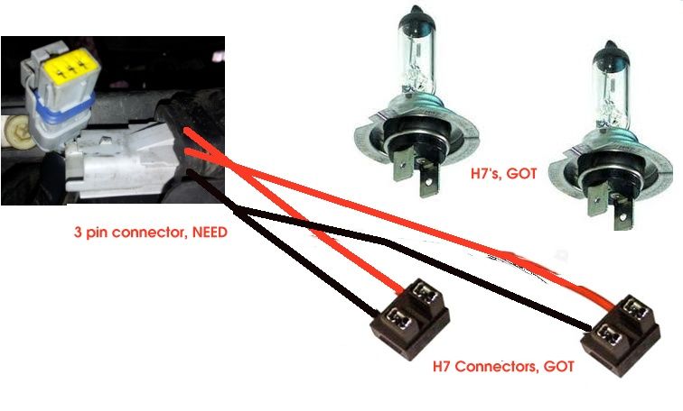

I'm wiring in some quads and not wanting to cut into the original loom I tracked down some compatible connectors. First thing I'm trying to do is to identify which wires feeds which H7, Dip and Main.
I imagine both H7's share a Neg and switch on the live. Something like this.
The colours are irrelevant it's what they are doing that matters.
I think I'll have to track down someone locally with a multi-meter to solve the problem
