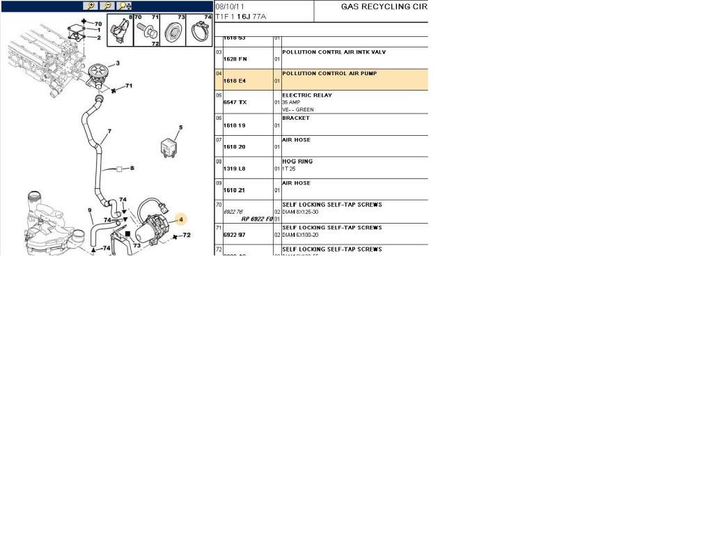

Found out the problem with my 180....but could anybody tell me the part number for me to clear this fault...the fault code is listed as a secondary air pump circuit if anybody could tell me thepart i need please....cheers all Wink

PM me your VIN number,and i can help u with that

Here is the pic of the part you need to check/replace to have your problem fixed,don't think that the optical sensor is available by itself,so it's better to change the whole unit.
so the Part Number is (1618 E4)

Thanks for help Timon. Now to find out what ludacris price Peugeot will demand...
