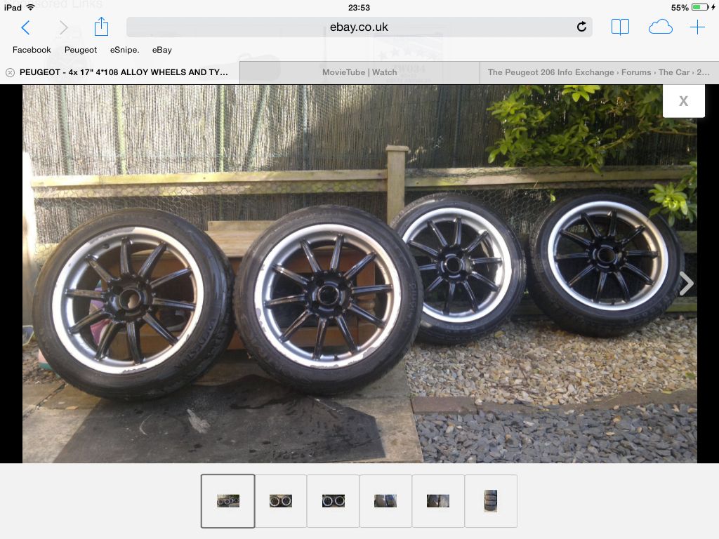

These are the wheels....

Can't say I recognise the style at all just by eye. Could always ask the seller for make or even the ET would be handy.
They seem to have quite a high profile tyre for 17's which could cause some arch rubbing on the fronts, perhaps this is what your friend means.
If push come to shuve the offset could be worked out by taking a couple of measurements.

ET is often stamped into the back of the rim ...
Possible that they're off a bigger Pug, like a 307) which will have a bigger overall diameter wheel compared to the 206, hence the higher profile tyre.
In short, the rims might well be OK, but the wheels as assembled currently might be to big. Solvable by replacing the tyres with proper sized ones for a 206 (205/40-17) if the width of the rim is suited for that width tyre.
