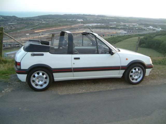

And whats wrong with a CTI??
This is currently for sale
(will probably never be for sale Laughing )

It only looks nice because its white! Razz
