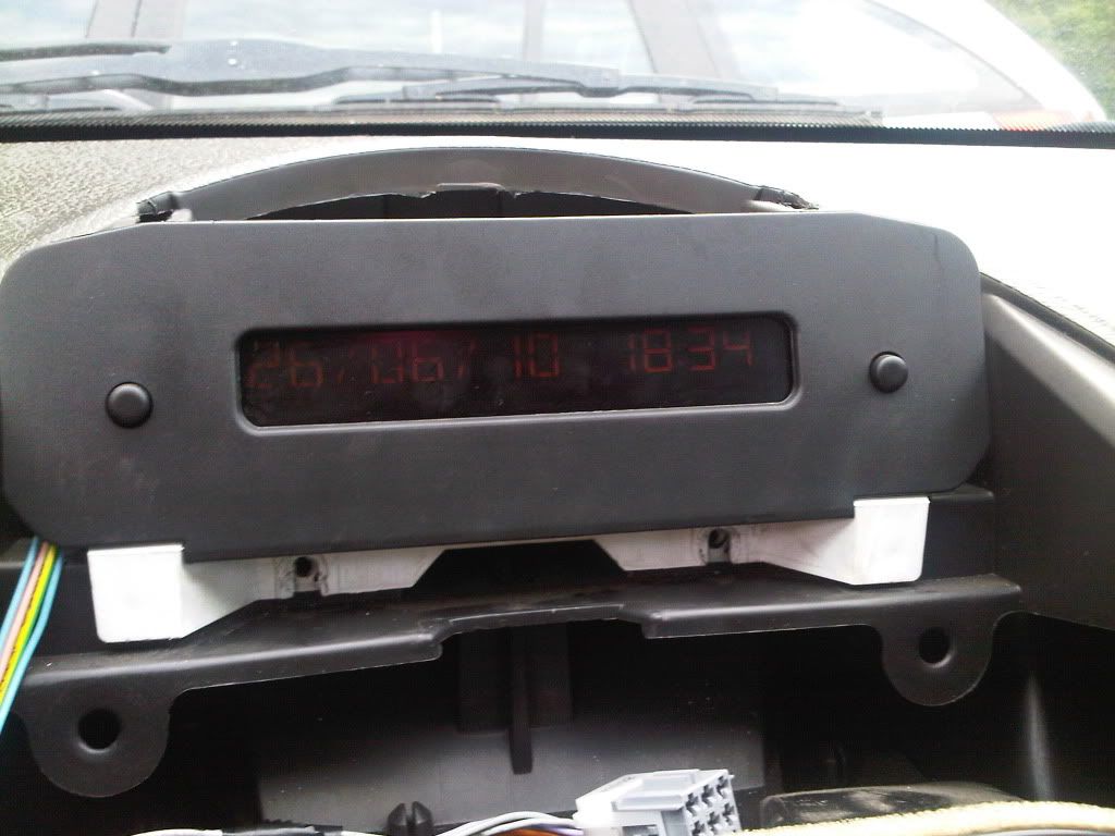

also changed my stadard dash clock and wired in a ppt40 and got the grey dash console for the wider clock
