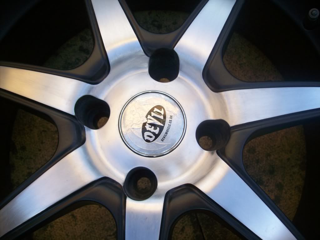

as my alloys were in a real state and nobody had showed in interest in buying them i decided i needed to sort them out myself. i've never done anything like this before, so here is my progress. (1st wheel only).
before
during
after
it is not quite finished, i plan to go over the polished parts with a smoother sand paper to get it nice and shiny and then laquer. i also plan to paint the front calipers white.
as it has took me all weekend to get this far on one wheel its going to be a while before they are all done lol.
comments welcome Smile

I spent ages rubbing them down with a rough sand paper, my hands hurt now lol. then masked the silver bits off and sprayed the rest matt black. then tidied it all up with a smooth sand paper. they need some lacquer though Smile

Just so that you know, you could have saved yourself a lot of work but simply 2000 wet and drying that finished down then using a G3 cutting compound and it would have come up like the standard finish.....

cheers guys, im going to go over the polished bit with some 800 grade paper and some g3 after, but might give the wet and dry a go with the next wheel as it took me ages to do this one

mate pm me your address i got some pads that will work great to rub down!!! what grit you start with?
btw for first attempt that is proper good!
Elldan
PostPosted: Mon Jul 19, 2010 10:16 am Up
Posts: 111
Location: Coventry
180 mate, then 320 and ive just got some 800, 1500 and some g3
