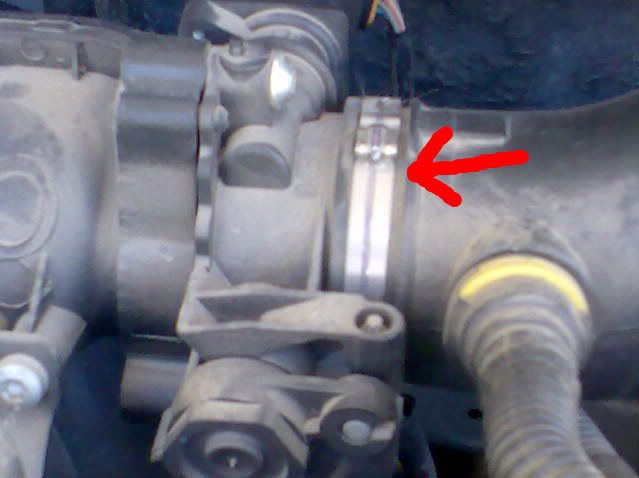

Hi All,
I would like to clean the throttle body,but I don't know how to unclip this clip,or is't a one use only,and i need a new replacment,any idea would be great,thank you for your help.
Tim

Cut it off and get a new one...
They should be the ones where you can tighten and loosen them, but it doesnt look like you have that one.

Or squeeze it together and it should come undone
PostPosted: Sun Aug 29, 2010 10:43 am Up
Squeeze together, replace with jubalee clip if need be

I don't think it should be that type,because this is a factory fitted one,never been taken off since i got the car,but I know that type you are talking about,and I will do as you said as a last option :D,don't like to cut things off Wink

How can I squeeze it together,and there is nothing to hold it from,what tools do you recommend I should use,or is there a special tool for this kind of clips?
Theyre is, cant remember the name
Or side cutters will do the job to squeeze it together (not to much), then release and it will open

I will try that,and let you know if it worked or not,hope it will :D,thanx
