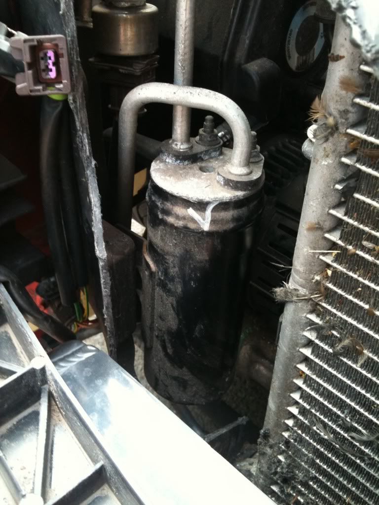

PostPosted: Fri Sep 03, 2010 6:57 am Up
So I couldn't just de-gas and remove this:
And blank off the two pipes?
PostPosted: Fri Sep 03, 2010 11:06 am Up
yep aslong as you have it de-gassed by an approved aircon garage its illegal to just let the gas into the atmosphere
thats only the drier and wont affect the compressor/belt at all (apart from the fact the aircon wont work obv Smile )
personally id try another route and keep the aircon i couldnt drive a car without aircon it would do my head in
