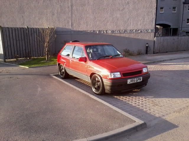

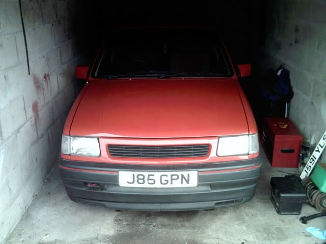

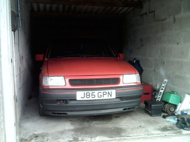

Here's my SR, 1992 with original 1400 single carb engine. Needs a bit of bodywork done which I will start on soon.
Sellers photos of the car:-

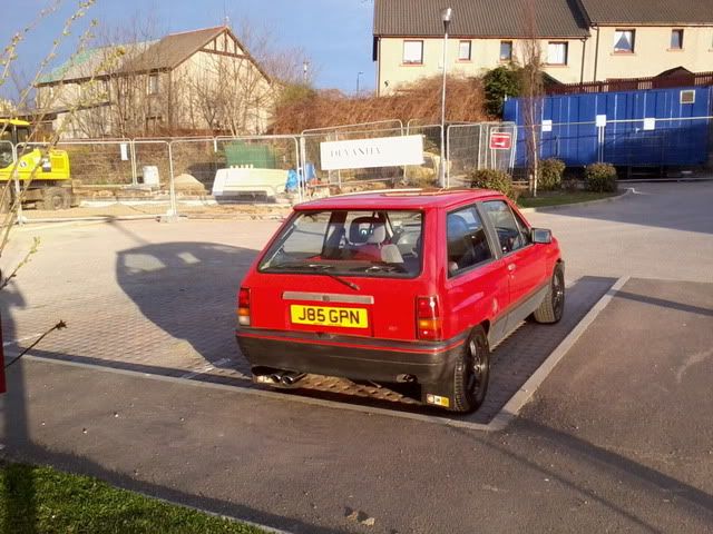

T-cut, trim restorer, cheap mudflaps, Laguna front splitter and some black wheels
Lowered the rear a bit
Decided I didn't like the black wheels so I fitted the one's it came with, I personally think it looks a lot better plus they are quite a bit lighter than the black alloys.

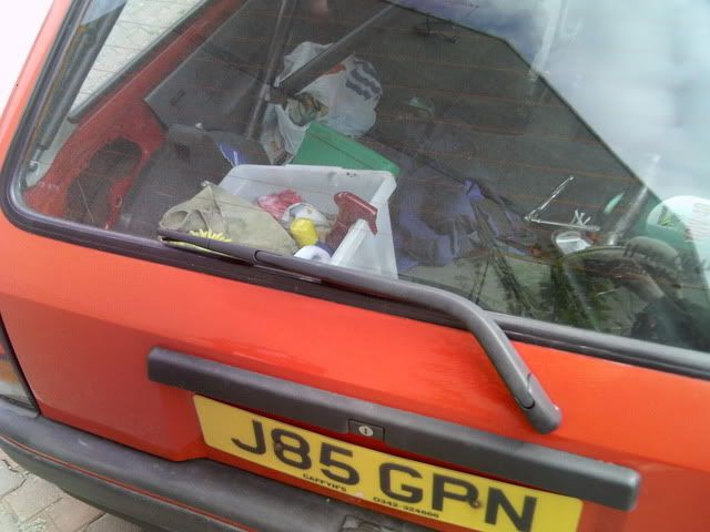

I received my Honda Jazz rear wiper arm today, so I fitted that!

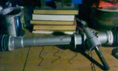

Steering rack removed ready to be wire brushed and painted :-
Steering rack painted :-
