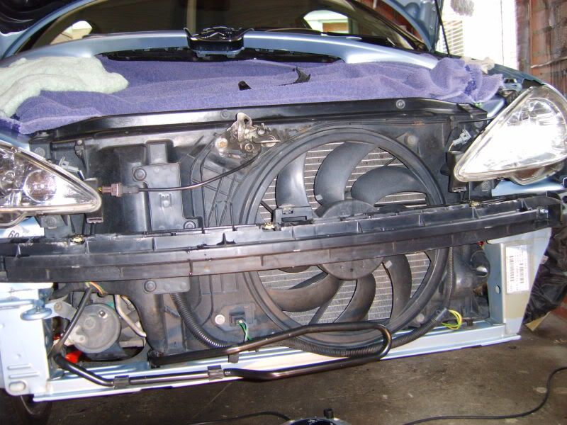

So does anybody know what the resisitor is for on the fan housing? It's the connector to the bottom left of the fan. Is this just used for the low speed fan?
I'm going to look at wiring my Omex ECU to the fan (or more accurately the relay) so I'm trying to understand what stuff does what...I might even re-use the original coolany fan relay if I can make sure the power supply to it is reliable.

I'm sure there is a low speed for when the A/C is on and a high speed for cooling the radiator when the engine is hot...
It also has two relays...one for each speed? I suspect the resistor is linked to the wiring for the low speed fan relay.
The relays will be triggered by outputs from the ECU.

I know I can test it but do you think the power is to the relay all the time? i.e. even with the ignition off? Does the ECU just operate the relay? If I can disconnect the original ECU from the high speed relay and simply connect the Omex in its place it would be great.

The OMEX uses a switched negative whereas Peugeot use a switched positive for the relay. You are correct in thinking that coil by the relays is a resistor. They should have power there even with ignition off so it continues to cool once you stop. Your best bet would be to get your multimeter out and test what you have. I've removed the resistor from mine and the two under bonnet relays. Tthe omex switches the new fan relay by triggering a ground to the relay coil.

So I could still use the original relay but I'd need to make sure it has an ignition controlled positive so the Omex can switch the negative??

No, as you would only get the fan on when BOTH ecus switch it on. You will have to do away with the standard ecu input to the relay and give it a perm +12v and switch the earth via the omex.
If you want to keep both it is also possible.
What you would need to do is fit another relay (a small one will do) and use the omex to switch that on and use it's output to power the standard relay. If that doesn't make sense I can draw it for you later.

Would it be possible then to operate the A/C fan on low speed via the standard ECU, Connect the Omex with a small relay and disconnect the main full speed fan relay from the standard ECU and use the Omex on this speed...... think thats what I was asking Confused
