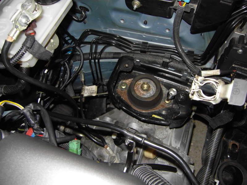

PostPosted: Tue Dec 14, 2010 3:57 pm Up
Posts: 7047
So you can see the earth strap where it attaches to the gearbox and inner wing?
Newty
PostPosted: Wed Dec 15, 2010 2:28 pm Up
Joined: Oct 13, 2010
Posts: 4
Location: Cumbria
I can see an earth cable on top of what I believe to be the top of the gearbox, I couldn't see another though. But I guess you have just given the location of it away to me!!! Do I need to get underneath to see the wing one?
Ta.
Hmmm...what can I do??!!!
PostPosted: Wed Dec 15, 2010 2:48 pm Up
Posts: 7047
You can see the earth cable at the left hand side of the picture just to the left of the 3 brake pipes. The earth cable also has a white label on it.
