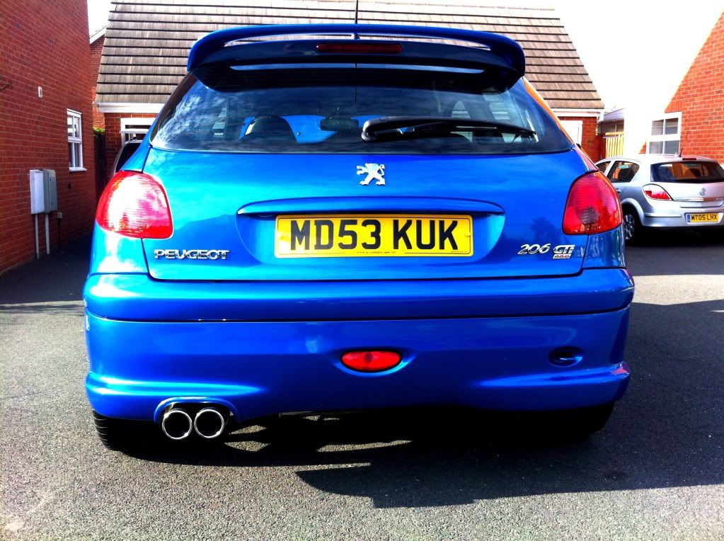

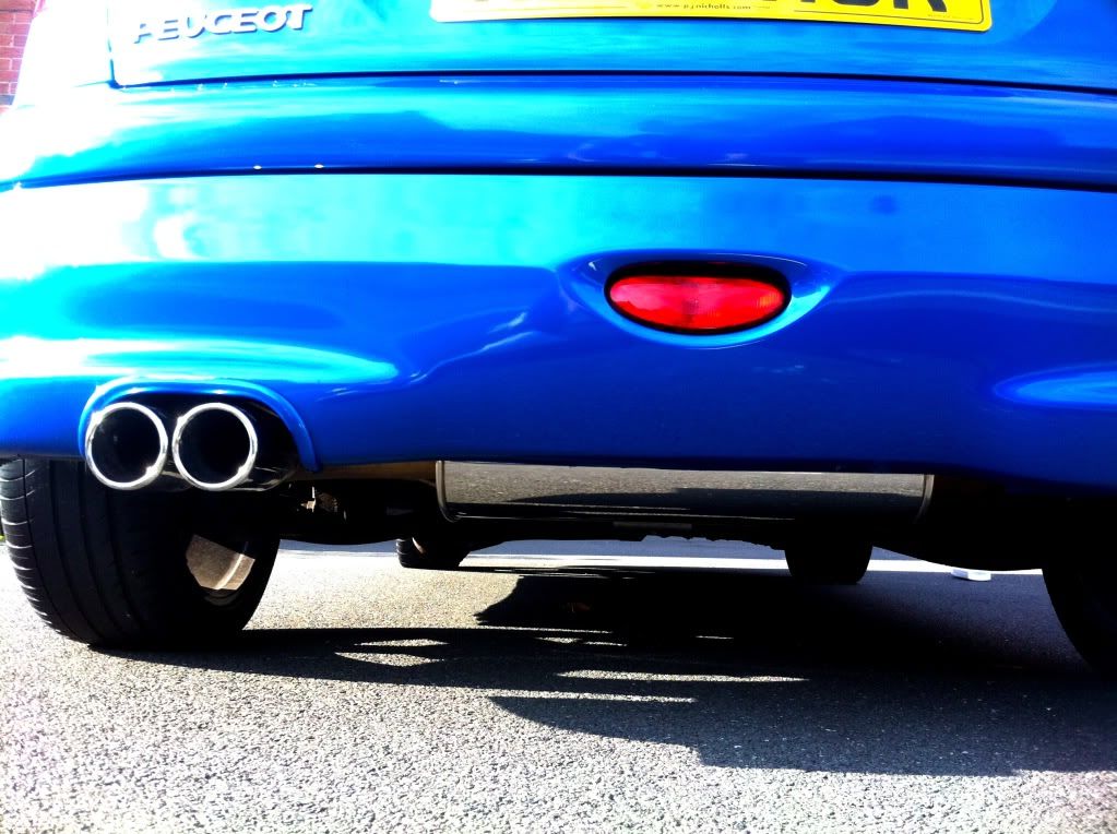

In the same angle as the one below please, looking to see how the larger exhaust cut out is done. Whether the original hole wants to be widened equally both sides or all from one side etc Smile

Perfect mate! Exactly what I was looking for!
From that I'd say that the hole needs to be extended to the left as we look at the back of the car, you agree?

hmmm.... i personally think its equal either side....just buy the little heat shield lip thingy off the 180 and put it up to get an exact fit

Hmm maybe.. Aye, going to get one and as you say just trim a little at a time until it sits perfectly Smile

i'd say from either side too.

get a 180 owner to measure the gap between the edge of the fog and the edge of the exhaust surround
then measure yours, if you want to be precise.
From the photos i reckon you want around an inch off each side of the normal surround
