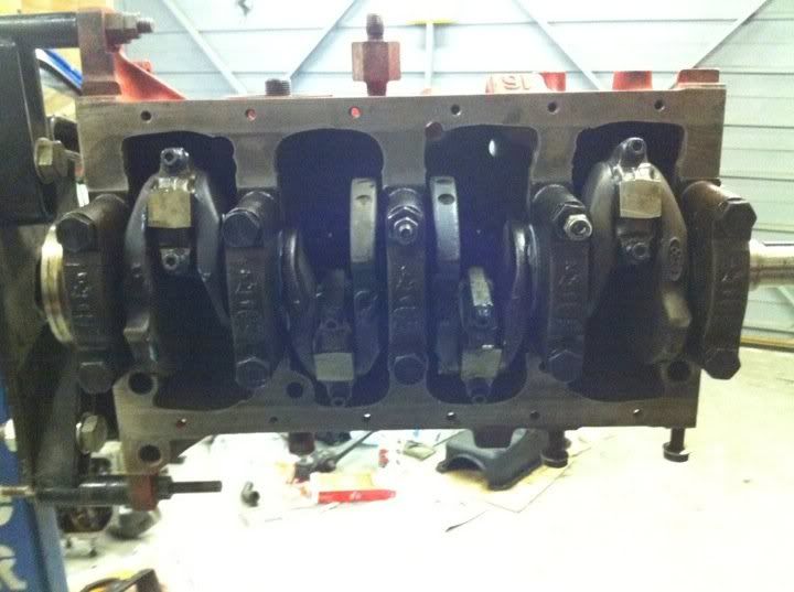

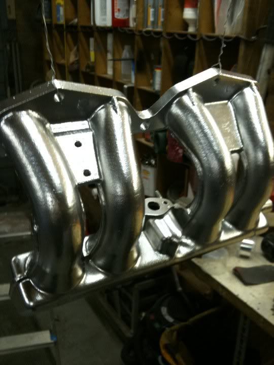

Might not be every bodys cup of tea but i know in my newbies thread couple of people liked it so thought id put a couple more pics up for you lot to have a look at!!
I brought the car for £1900 knowing there was a few bits wrong with it that needed abit of tlc but this obviously went to abit more then i hoped. Whilst driving the car back i thought it was abit slow but i was comparing it to my last 320bhp escort rs turbo so didnt think much of it. about a week later i went to lakeside and got slaughtered by another standard rs turbo so it was time to take the car for a mapping session at torque of the devil. first run = 88bhp and 3psi of boost lol at standard rs turbo suppose to run about 10psi. whilst mapping it on the 19th run it spun all its bearings DOH!! So finished the day off with 170bhp and and buggered engine.

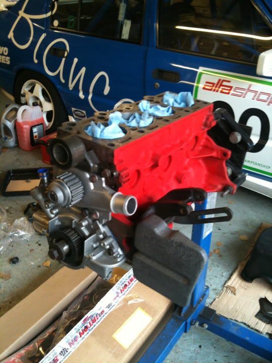

so rebuild commensed ive been building the engine with parts so once its finished i can hopefully start running around 250bhp Cool
Next winter its coming off the road for its zetec conversion which will give me around 400bhp Very Happy
Little spec and price list for you first:-

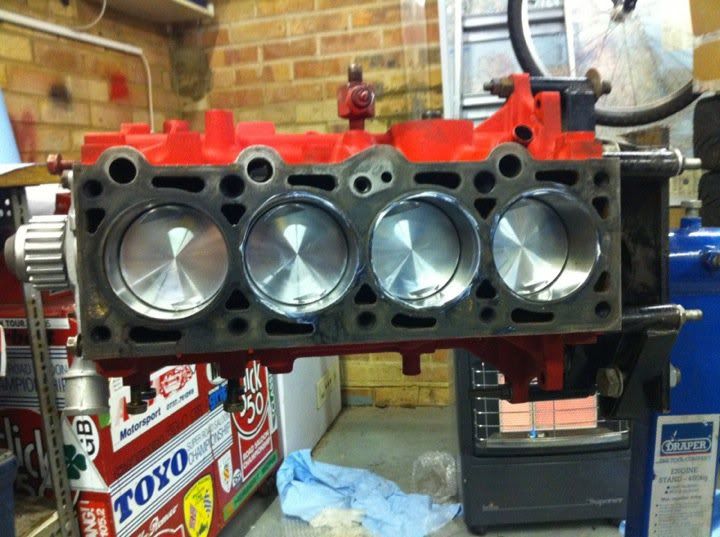

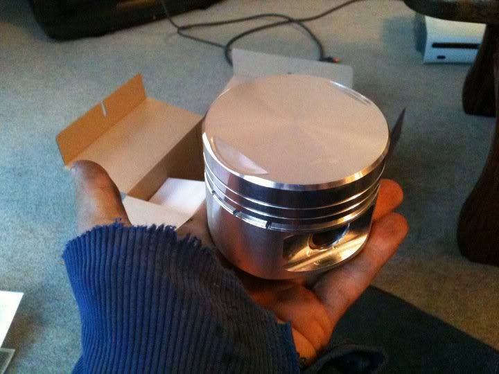

Forge accralite pistons 1mm oversized £650.00
New engine mounts £125.00
heavy duty main bearing set £65.00
ARP Headbolts £110.00
High pressure oil pump £95.00
Thrust washer set £15.00
Water pump £45.00
Thermostate £15.00
big end bearing set heavy duty £55.00
Full bottom end gasket set £35.00
Main bearing cap bolts £80.00
ARP conrod bolts £65.00
Full head gasket set £50.00
-31 Actuator £95.00
Forge sump valve £65.00
bored block by 1mm £160.00
4x standard conrods £250.00
Conrods shot blasted £180.00
crank polish £20.00
Heat paint and halfords paint used £120.00
This weekend coming up is going to consist of rebuilding the head which also is going to cost around £200ish
Bits to come
Payday MIGHT BE consisting of a tubular manifold Wink £299.99
New exhaust system £450.00
Stage 3 head + kent cam with vernier pulleys £500.00
and now for the more interesting parts Smile

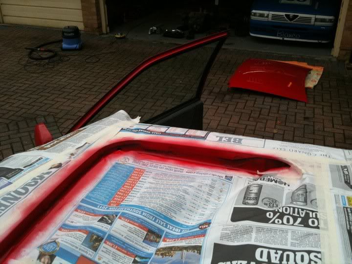

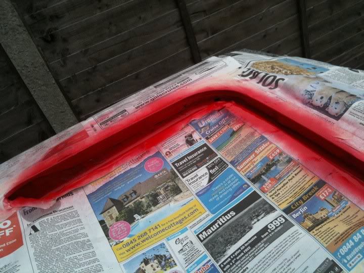

Sorted sunroof had a few bits of rust and serious paint fade lol.

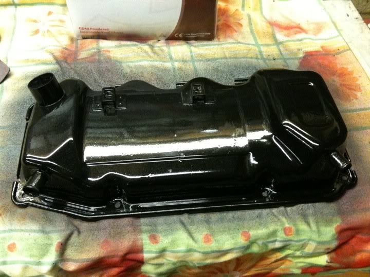

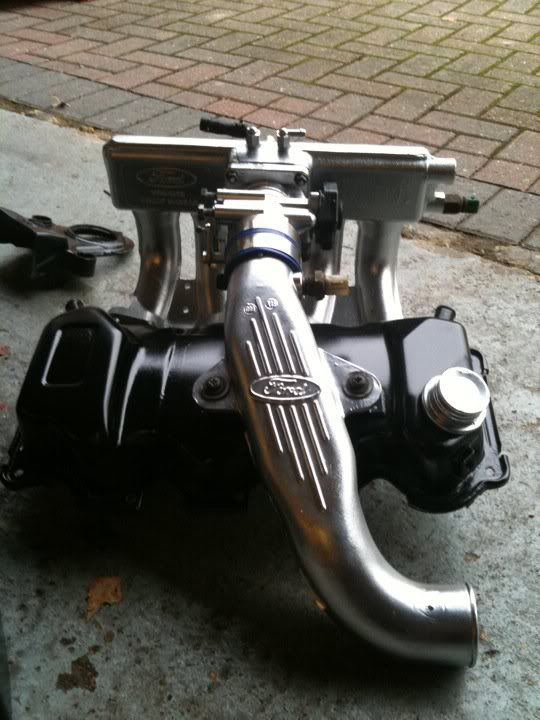

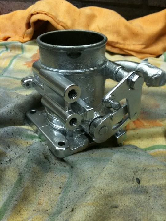

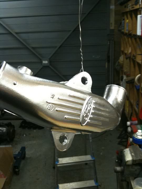

Chromed few parts

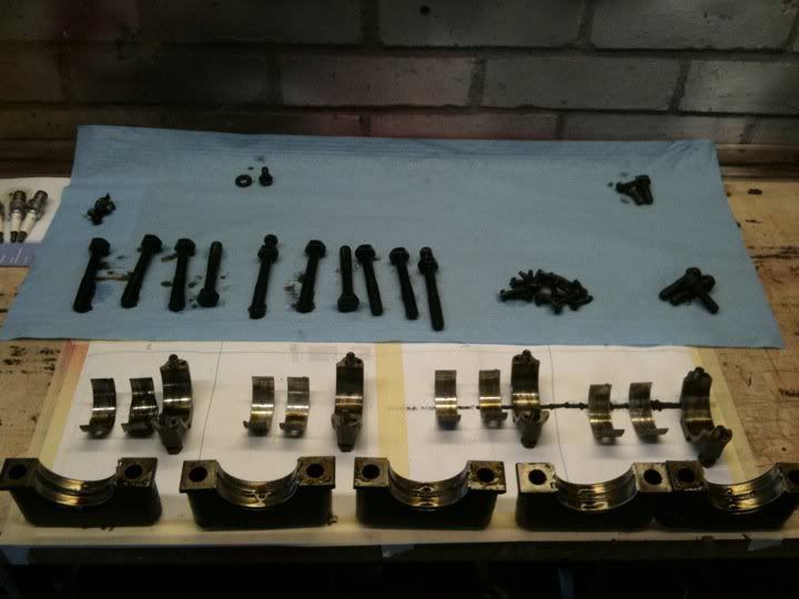

The broken parts lol
far left bearings check the shape out compared to the rest Laughing

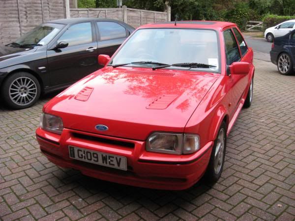

Few pics of the car!!
Would love your comments ladys and gents Very Happy like i said i can understand it not being every bodys cup of tea Very Happy

I like this cup of tea a lot, despite how 'buggered' the engine looks in the first photo. Keep up the good work fella.
