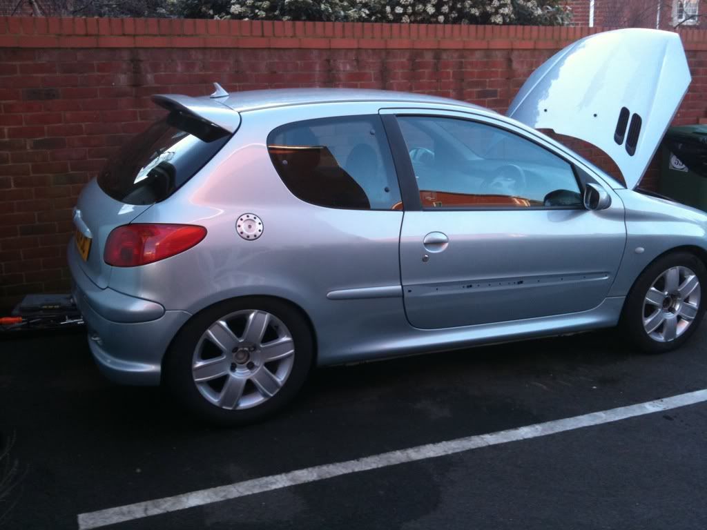

Stuck my C4 VTS wheels on whilst my 17's are on the C4, would have to mod the centre caps but what do peeps think?

PostPosted: Sat Feb 12, 2011 3:10 pm Up
Im liking those wheels, something different always look good. Deffo need to mod the centre caps
Andrew
PostPosted: Sat Feb 12, 2011 3:17 pm Up
Joined: Mar 03, 2010
Posts: 2636
Location: Black Country Ay I
Its OEM but different, I like it Smile
