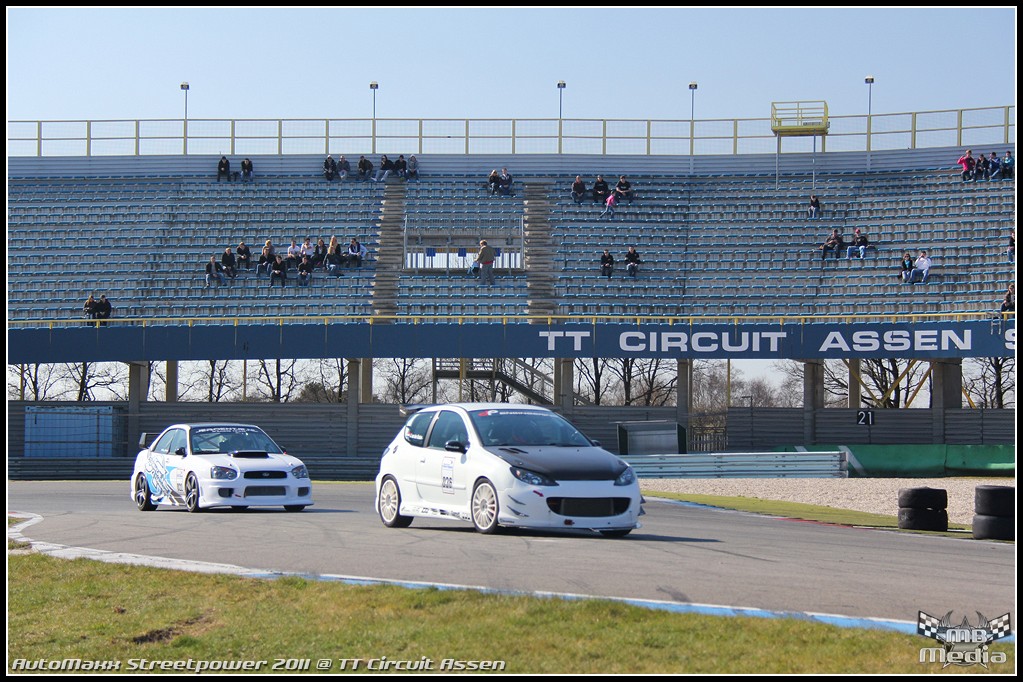

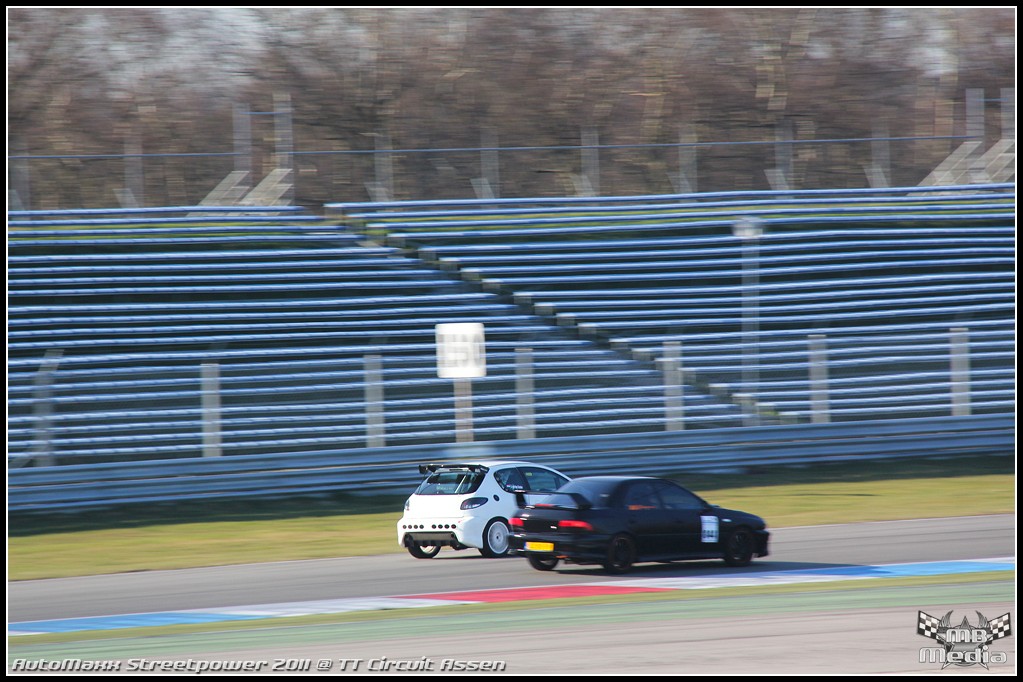

After two years of building and modifing, the 206 gti turbo has finally been on the track last weekend. There wasn't enough time to do some extended track testing so the first time on the track was immediately the first edition of the Dutch time attack series on the TT circuit of Assen.
In the first 20 minutes of the warm-up session the handeling of the car was rubbish and i drove a poor 2:28 as my best time. After some minor adjustments with the camber, spring damping and tyre pressure the car responded a lot better.
In the qualifing round of 20 minutes i made up some time and with a 2:18 i had qualified myself for the finale. In the finale round you only have one lap to set a good time, but unforunatly the clutch was overheated due to a bad time schedual (the organisation had planned the qualifing and finale in one session) so there was no time to made some adjustments and cool the brakes and clutch. Eventually with a slipping clutch i still drove my fastest time of the day in this round with a time of 2:14 and became 6th overall of the 30 competitors in the semi-pro street class.
This day was suppose to be a test to make sure the car was ready to compeed and it turned out to be a huge succes. Next month there will be some huge modifications on the susspension to make the car more rigid.
