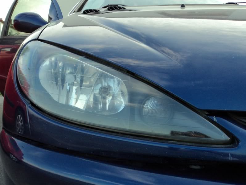

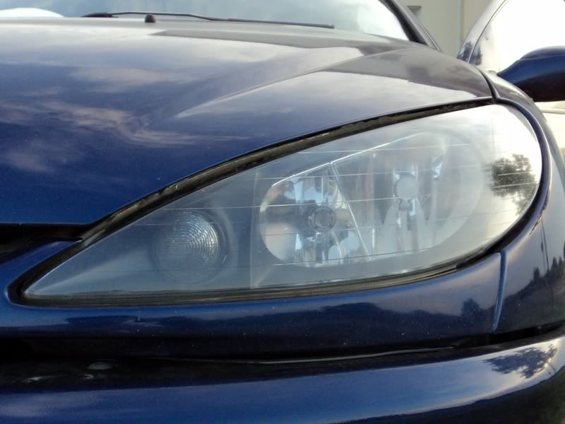

shoaky
PostPosted: Fri Jul 15, 2011 2:57 am Up
Joined: Jun 13, 2010
Posts: 44
Location: Sibiu, RO
Bought a pair of right-hand drive headlights and changed the inside mirror for a left-hand drive. so the only difference between them were the mirror.
here are some pics:
