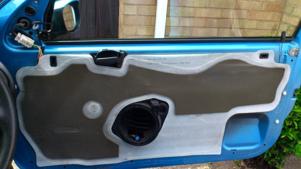

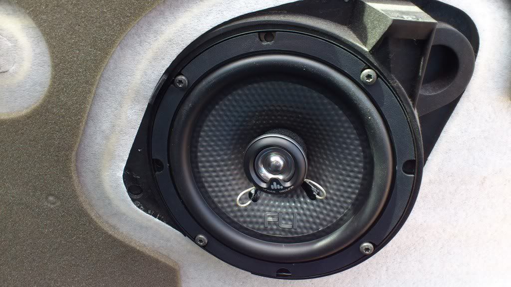

Next to go on was the speakers... i hate these stupid clips! i never wanted to see them again after the 106 but there back to haunt me Evil or Very Mad door off;
Front Speakers in, a perfect fit, god knows why people suggest 17cm, 16.5cm bearly fit;

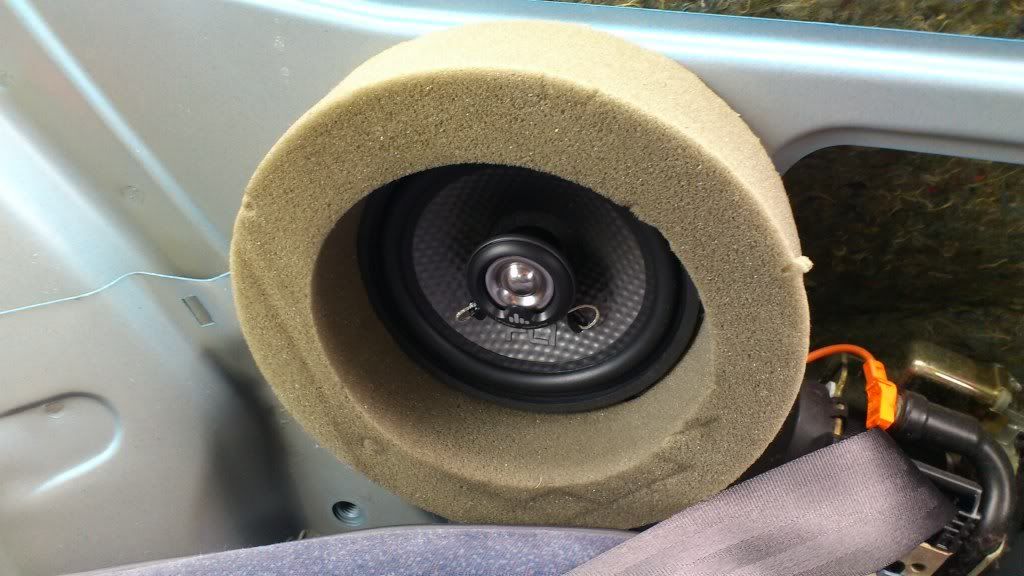

Rear speakers in, and what i'm guessing peugeot class as sound proofing back on..;

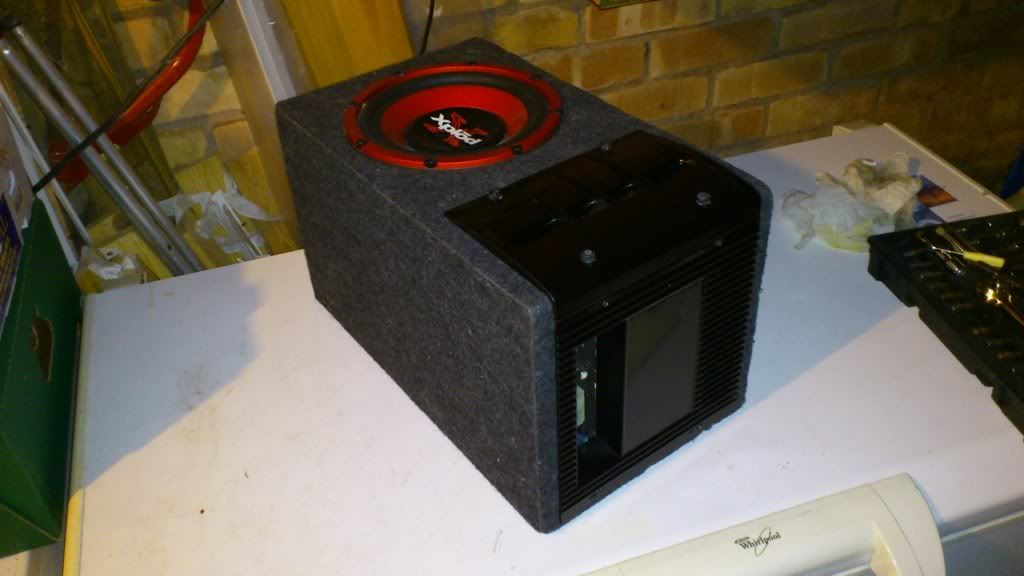

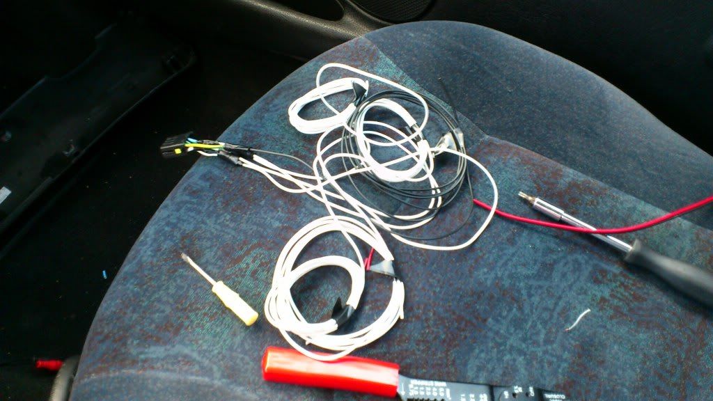

So after all this work went into wiring up the speakers and sub, the lil pug went typically french on me and decided the headunit was no longer allowed to work and after about a weeks worth of trouble shooting it turns out the memory feed is dead, no idea whats wrong with it so i just ended up wiring it to the battery, and eventually i got it to work ( a big thanks to; Richie_1, Chris1.1, Sazismail, richardw1992, and sam w from 106OC), we have life!
The cars now a couple grams heavier, it's meant to get lighter not heavier!

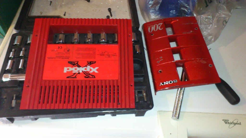

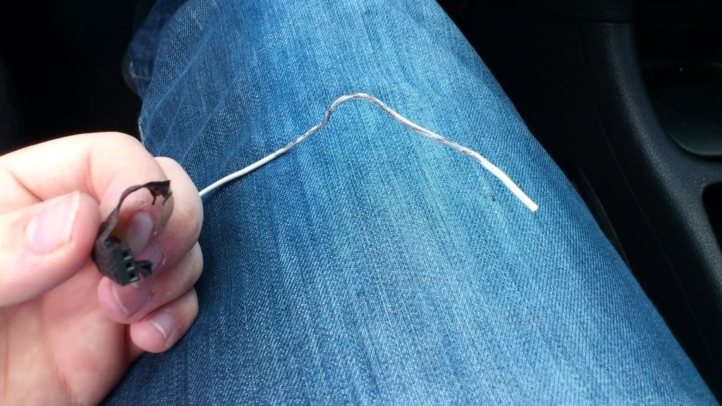

Also while stripping the wire described in the manual as antenna, this fell out Question oh well i don't need it and if i do i can always wire it in manually;

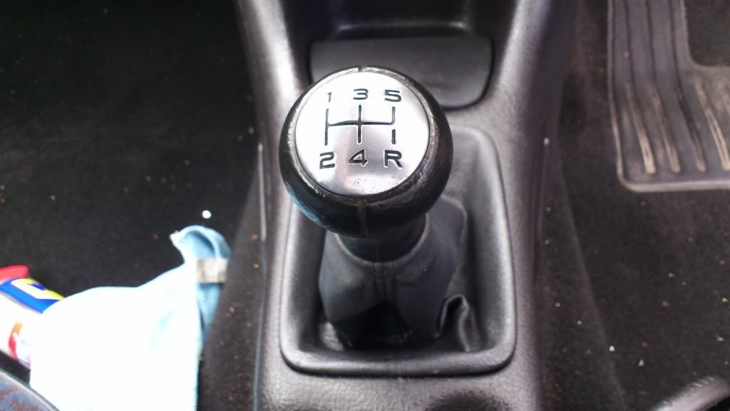

Next up were 3 small mods, paint front badge, mist style washer jets and a new gearknob and gaiter to replace my slightly worn one;

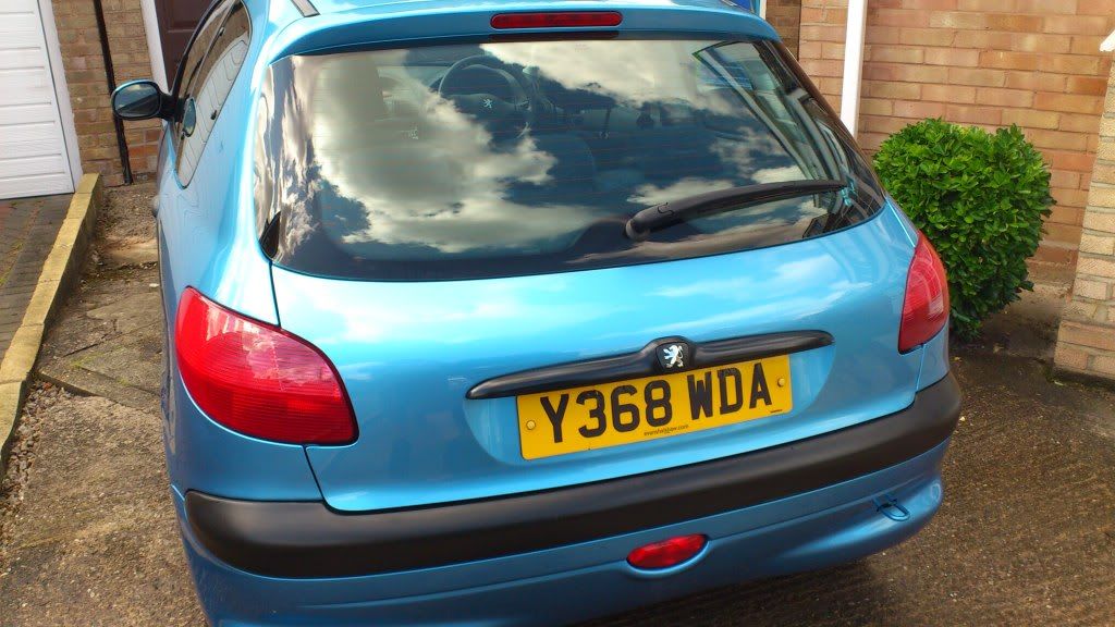

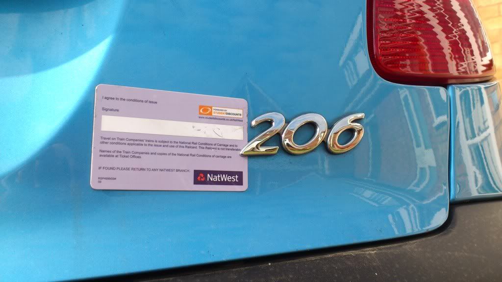

Next up i went about debadging my rear and i must say i'm quite happy with how it turned out (i wasn't sure about it before i did it), and i found a use for my natwest railcard, they keep sending me them but i have no use for it Laughing ;
Oh and afterwards to get the tcut off i washed her and she certainly does shine with a bit of demon shine on her;

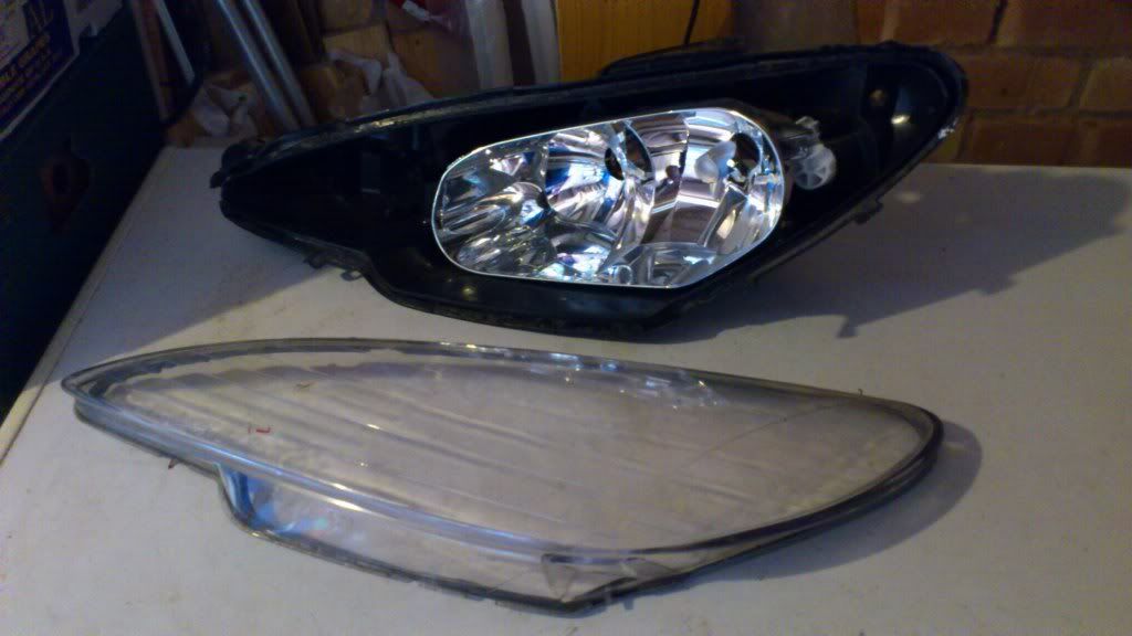

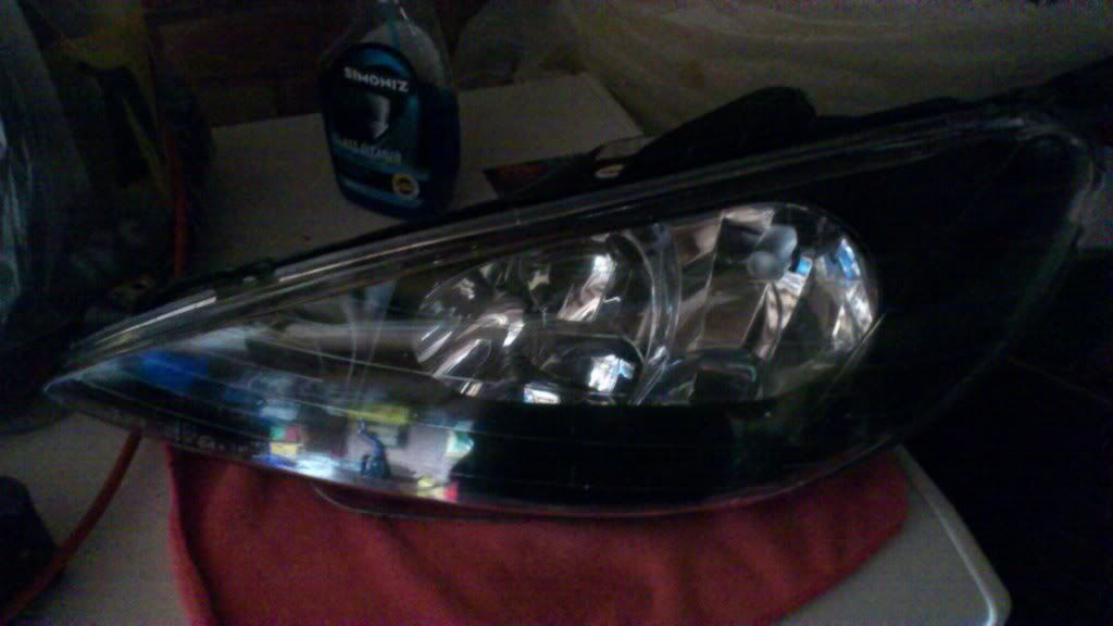

Anyway my new headlights arrived, so on with the strippage!
Primer, only to run out half way through;

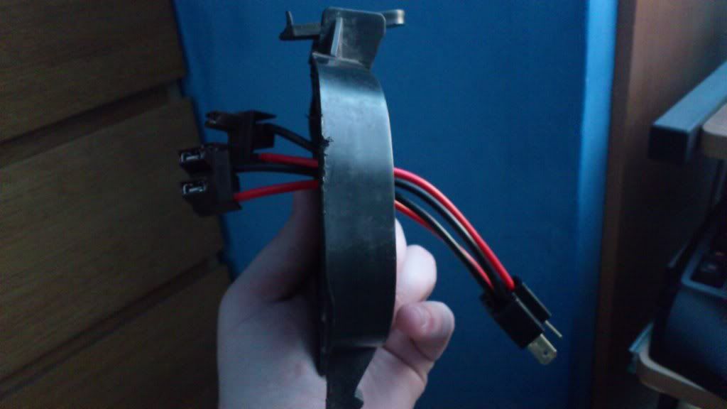

While i had no primer i went about making a h4 to h7 adapter (i may add a relay later on, it depends what there like);
I was disappointed when i received these headlights they aren't in the best condition, the sidelights holders are burnt. an indicator bulb holder is missing, and one of the headlights adjuster plates kept falling out of the holder meaning i had to strip them back down to connect the headlight adjuster, anyway pic of the sidelight holders condition (lucky i can reuse my current ones..;
While i was waiting for more primer my computer got infected with the damn french meaning i had to cannibalise my first home built machine (now my friends old machine, yes i build them to make cash on the side) for spares since i'd spent all my cash on the car, I'm a poor student money either goes to the car or the computer, it's usually 50/50 but sometimes either side wins and hench the old machine got stripped of it's ram to last untill my student finance comes in september, come january this will either become my server or go in my car for an in car computer, we'll see, that is if it doesn't die first....and yes that is pink coolant Wink ;
Anyway while i was fixing that my primer arrived, along with some matt black and high temp matt black;
Which meant these could be finished, and yes i forgot to add the indicator glass when i took the photo;

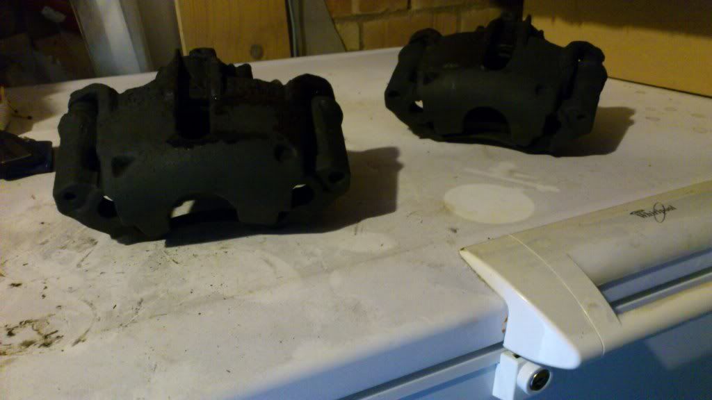

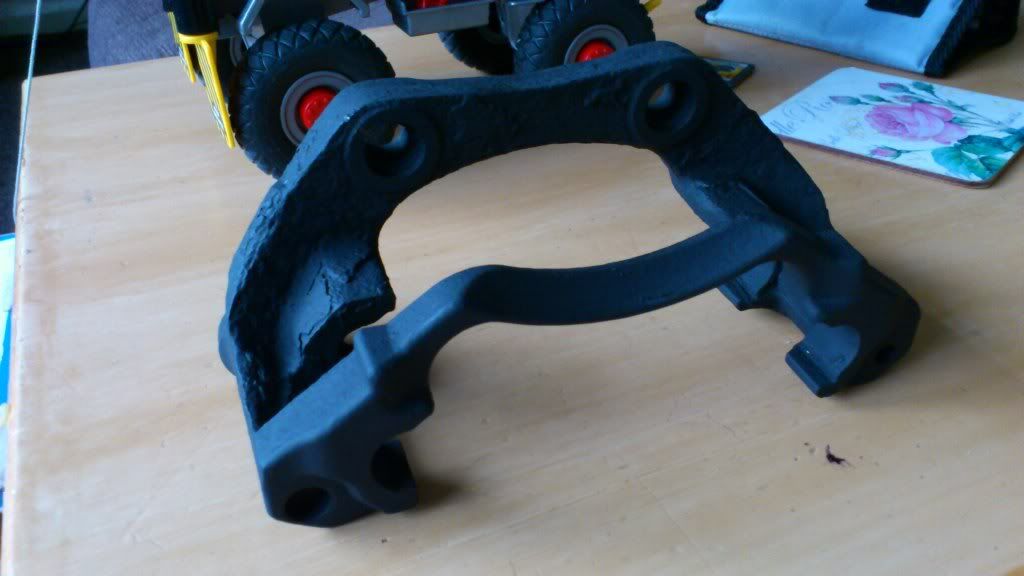

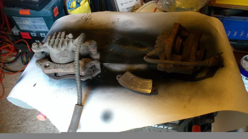

Later that day while i was reassembling the headlights my Gran Turisme brake calipers arrived, looking rather sorry for themselves but for £12.50 i can hardly complain, anyway thats what the high temp paints for, they even came with a set of what look like new pads, bonus! even if i'm planning on getting green stuff pads Cool ;

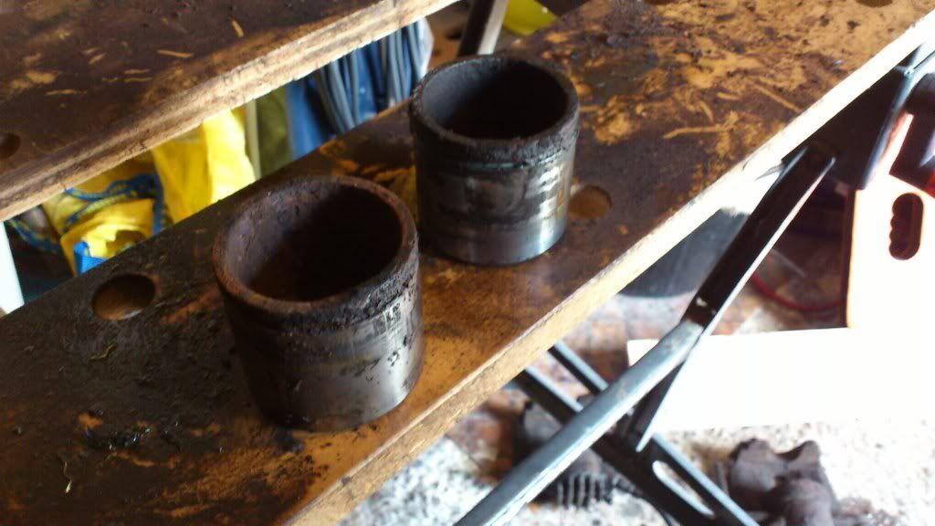

So like anything else to do with a car seized bolts were an issue, after a few days of coating the carrier bolts in WD40 and using a hair drier (i'm not joking it gets hot enough to do what a blow torch does, not as hot but it still works) they eventually loosened, and hour or two with a high speed drill and wire wheels, i was getting no where near refurb, but they were in a good enough state so they'd still look good on the wheel and weren't going to cause more rust so i sprayed them (not sure on the colour, i'm wondering if HT laquer will make it darker, if not i can always get more paint, there not going on yet anyway;

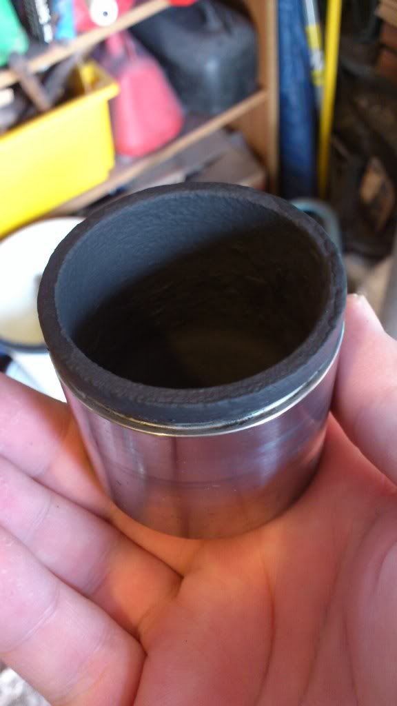

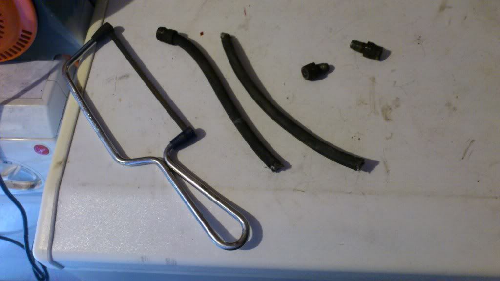

Next up was unseizing the piston, solution? cut head off the brake lines, connect to foot pump and pop, out they come looking rather sorry for themselves, 10 mins with the wire wheel and some more paint and heres the results;

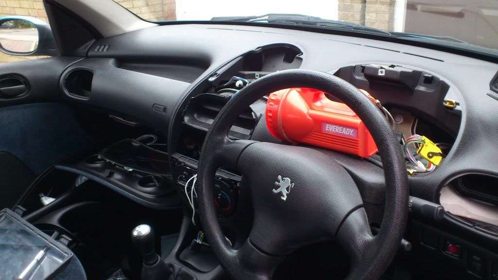

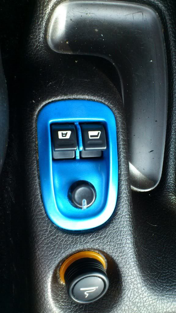

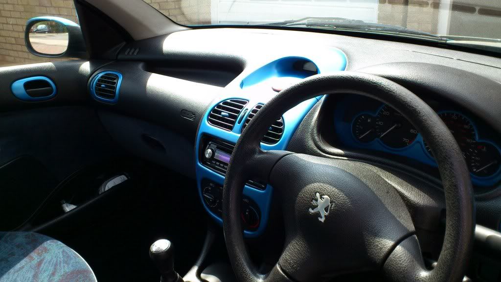

While the parents were on holiday meaning no old man moaning at whatever i do to my car, i decided to get to work on my dash so out it comes;

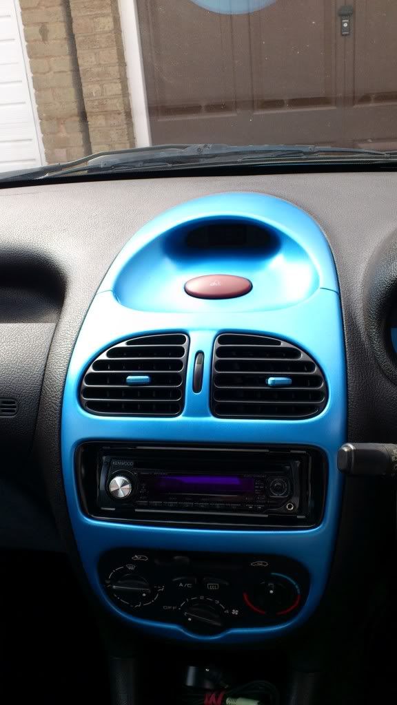

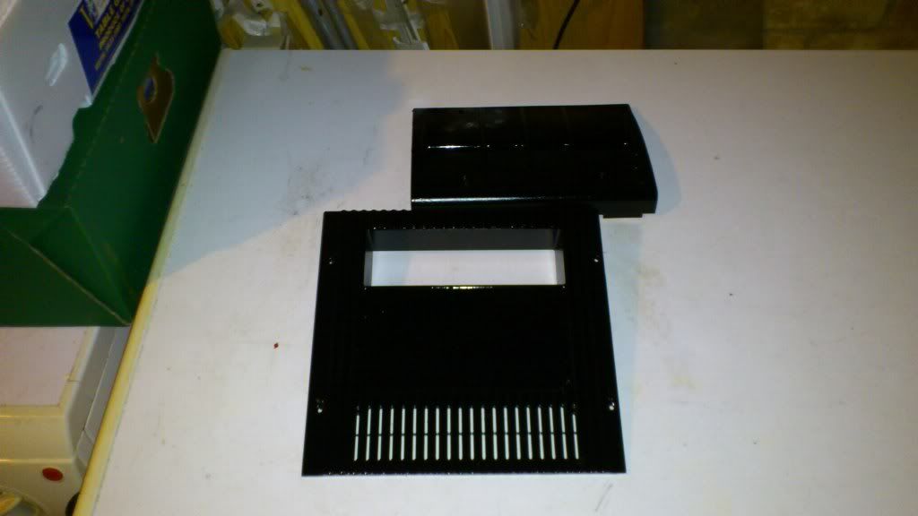

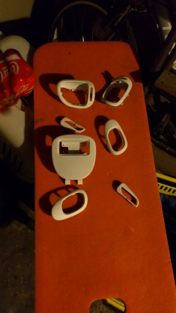

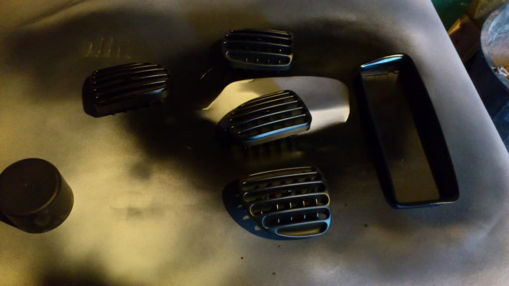

Prep and Prime;
Now i wanted a 2 tone paint job on the dash, so these got done in matt black;

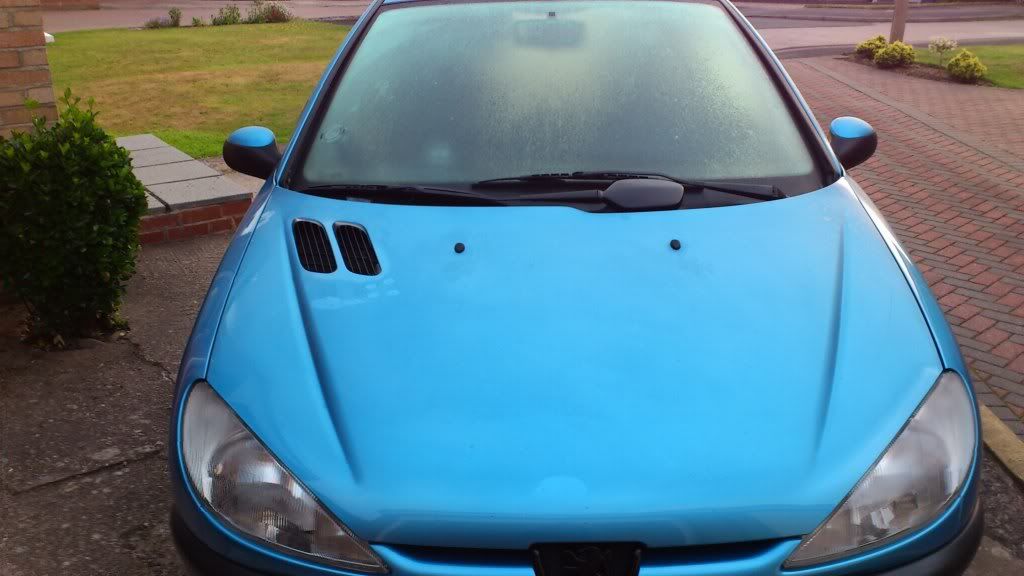

Along with the wiper arm cap and bonnet vent to keep up with the theme;

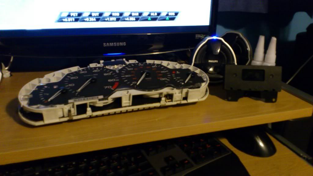

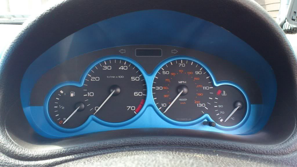

While thats all drying, i went about detangoing the clock and milage gauge, yes that is f1 on my computer;
And the finished product of my painting skills;
Anyone else thinking i should get a lockwood kit? I plan to resolder the LED's and swap them for some blue ones later but i'm not too sure when it comes to the dial paper, anyone think white would look good with those dials? I don't think they do a black version so it will probably have to be white if i do it, i'd rather have black if possible though.

Something i forgot to mention was the brake lines wouldn't come off along with the rest of bolts so a little "persuading" was in order Twisted Evil ;
There now more or less refurbished they just need new dust caps as there torn to shreds;

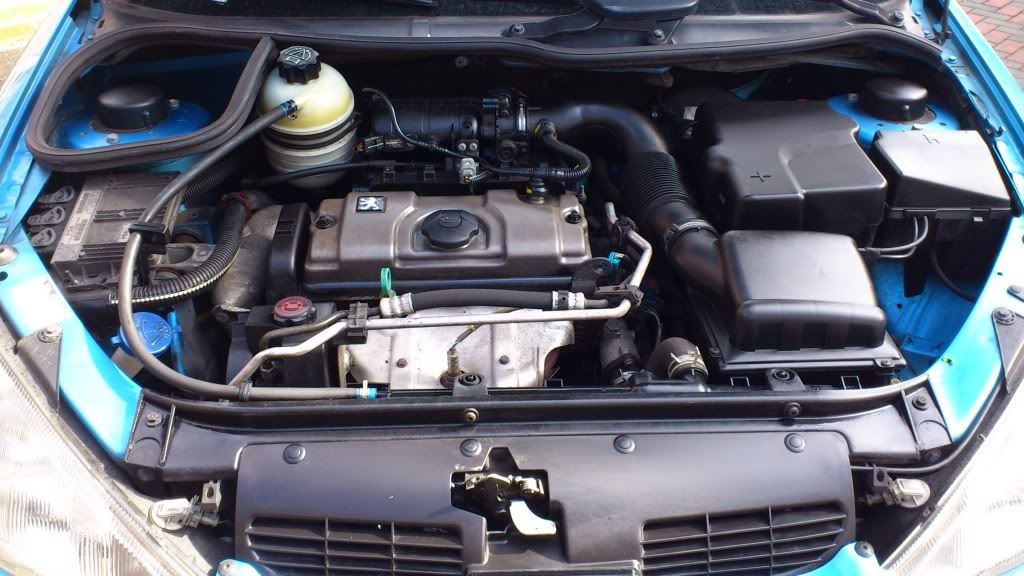

- Check the airbox for blockage (the car didn't seem accelerate as fast as my 1.1's on the trip home but it may have been me not used to the car, i know it's heavier but it should be somewhat nippy, maybe i'm too used to the rev happy 1.1, but then again the clio sporting seemed to accerate slowly compared to the 1.1 too)

very nice mate, looks like you did a tidy job of opening the crystals up... oven job??

how did you split the lights...

The first ones abit worse than that but i used a very hot hair drier, a flathead screw driver, and a little bit of rage, to glue it back i just used industrial strength glue. Absolute pain of a job to do, the plastic lips abit of a mess but as you can't see it when there on the car it doesn't matter to much.
I could do with leaving them out in the cold one night to see if condensation builds up before they go on the car, i just hope they are properly sealed, i dont want to have to take them apart again, the new glue is stronger than the original stuff. The lenses needs abit of a refurb also, so that will need doing also before they go on.
