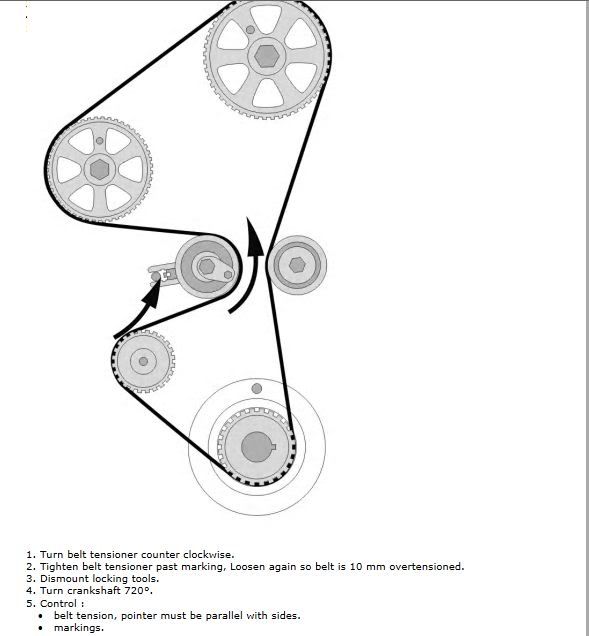

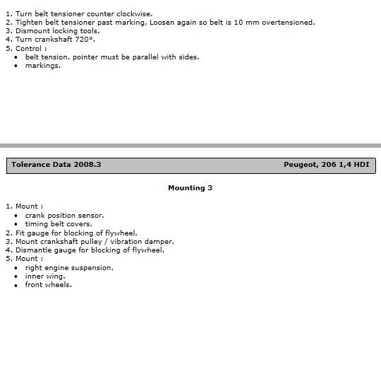

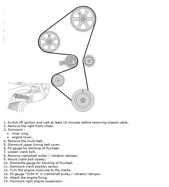

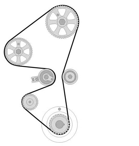

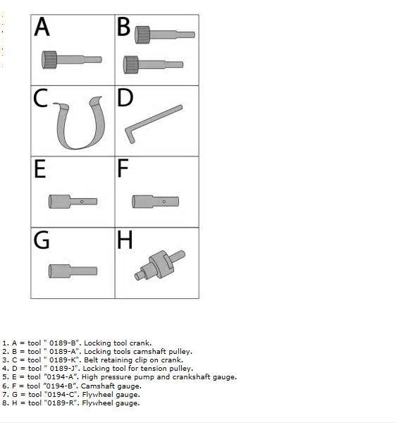

Hi I was wondering if someone could help as I am about to replace my timing belt and alternator belt. I was wondering if anyone could come up with instructions with pictures or diagrams.
My car is a 206 1.4 hdi, 2002/02.

kieron
Thanks for sharing.
I will print out for my mechanic next year.

The 1.4 HDi isn't that bad actually ... it was the first one I did (since then have changed the 2.0i in the CC and that was slightly more complex)
At the rear of the crank is a hole to lock it and that just needed a bolt!
I'm trying to think about the front, but I didn't use or need any special tools ... think it was a bolt here as well, but would need to re-look at my Haynes to confirm that!

kieron wrote:
Exhibit A in the case for why haggis120 has a wrecked engine next week? Very Happy
