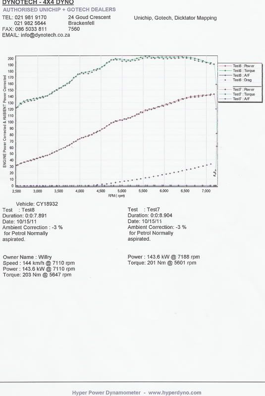

So the FRC software has adapted and the car is way quicker off the line and through the gears. I've also been around the race track, Killarney, and set up a time of 1:41:14. That was with just a basic street set up. Next track day I will make the car lower and start playing with the camber settings. I will also be looking to race on the track with race fuel

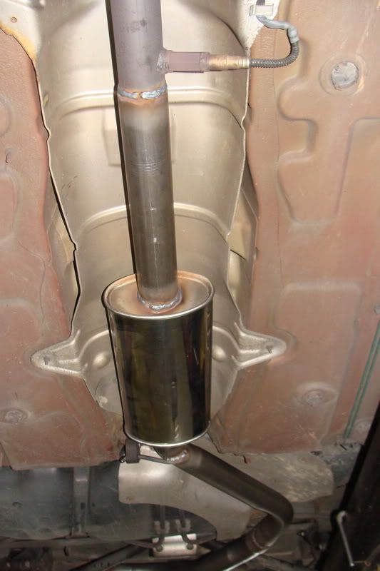

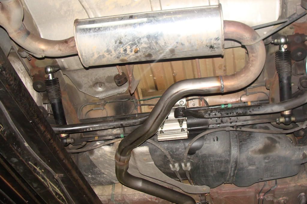

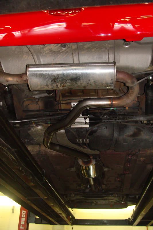

So I got some advise that if I change exhaust that I might get some torque back.
Changed the exhaust to 63mm all around and also changed the way the piping goes around the torsion bar
Schumi
PostPosted: Mon Oct 24, 2011 2:31 am Up
Posts: 901
Location: Istanbul / Turkey
Thats bad exhaust piping. You should replicate janspeed.
