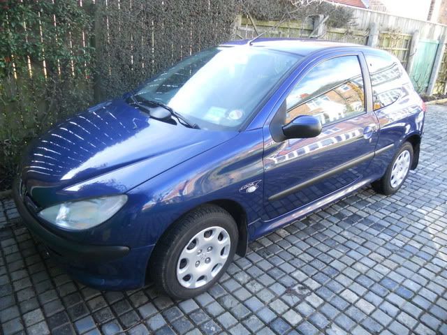

If anyone require's pictures, this is all your getting.
DOH!!!

P.S. It's cool, I've already seen pictures mwahahahah! lol
