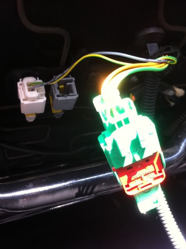

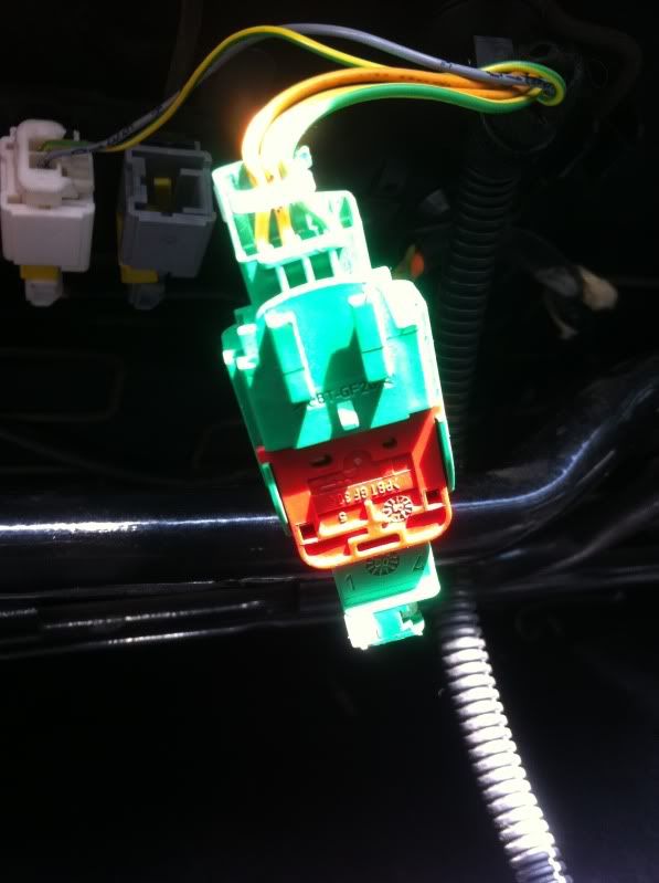

First of all I did search first but couldnt find anything. I need to remove my drivers seat as its wobbling and rocking, I have undone the 4 torx bolts holding the runners down and left the battery disconnected for about 30 mins before hand. But i cant get the airbag connector to split. Please can someone point me in the right direction?
Thanks
Danny.

HFStuart
PostPosted: Wed Jul 06, 2011 3:56 pm Reply with quote Up
Joined: Jun 23, 2011
Posts: 24
Turn the connector over from how it's shown in your photo. There's a little green tab that you'll be able to push down and it looks like that frees it - but it doesn't
You need to get a slim screwdriver and slide it in just beneath thab tab - give it a wiggle and the connector can be pulled apart. Took me a while to work it out and I've done a few over the years.
Edit: Camera found - Like this mating half missing but you get the idea.
Stuart
rob_1990
PostPosted: Wed Jul 06, 2011 4:31 pm Reply with quote Up
Posts: 100
Location: Cambridge UK
thanks mate, that worked a treat!
Stuart
