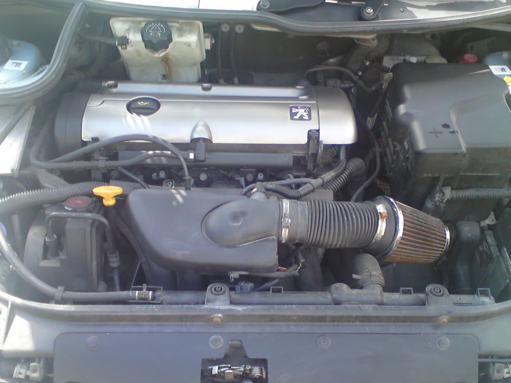

Does anyone know how to remove the top cover of the airbox which looks like this
PostPosted: Tue Mar 27, 2012 11:45 am Reply with quote Up
There is a hole at the side where a screwdriver can be inserted to undo the jubilee clip that hold the cover onto the throttle body. A torch might help you see the screwhead of the clip.

Just inside there mate

cheers guys, hopefully removing it will give me room to remove the icv
PostPosted: Tue Mar 27, 2012 1:20 pm Reply with quote Up
Well it should do because then it will look like this.

dont split the rubber bit £45 for replacement from pug
