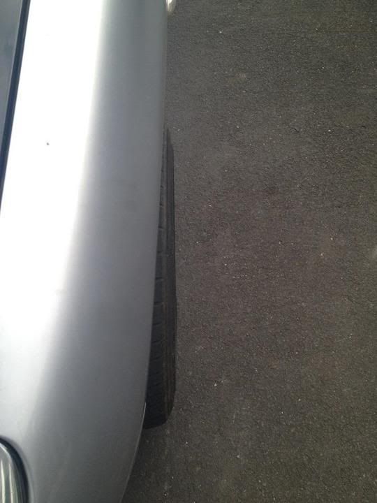

picture to explain... measured wheels and they seem to be the same size... tracking is out but dont think that could cause that?...

Bent hub, my GTi has this issue
And currently ive replaced everything apart from the kitchen sink and the hub
You may subframe but its a heavy thing to bend/move across, hubs can bend very easily

That doesn't look any worse than my wheel.

Why don't you swap the front wheels and see if it's the same ...
- if it is you have a suspension/subframe problem
- if it isn't and the other wheel sticks out, it's the wheel and it doesn't match. What did you measure? Hub to outer rim? That's the offset you need to check.
Not got a thin spacer stuck to the back of one?
