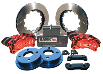

Also, what are everyone's views on Compbrake, I have never heard a bad word about them, and they can set me up with some topmounts too!
To be honest I didn't think I'd be able to afford them, but if I can then I'm more than inclined to get them!

Jamie
PostPosted: Tue Mar 16, 2010 3:22 pm Up
Posts: 3327
Location: Ring y0
macj
PostPosted: Tue Mar 16, 2010 3:23 pm Up
Posts: 3085
The set your looking at are for a 205 and are £750...ish
I can find out if they do a 206 kit and probably get that down to around £650 with a bit of blagging
