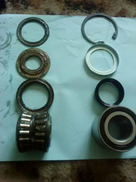

i have forgot which washers go first what a ding bat old bearing to left new to right

yeah i can do that its the washers i forgot how they go on i know the rubber goes on the rear but forgot the rest its the metal cup washer i forgot where some kits dont even have them do i even need it ?
WGH
PostPosted: Sat May 12, 2012 4:42 am Up
The circlip goes on the outside edge and the hub seal ring (below circlip in picture) goes on the inside (nearest brake shoes)
The washer 2nd down on the left is what your hub nut tightens against.
Not too sure where the rubber washer goes though.
From outside, hub nut, hub nut washer, circlip, bearing, hub seal ring.
