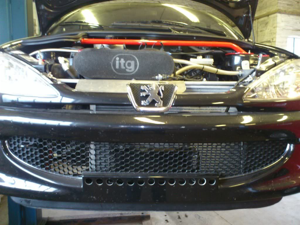

i take it you want it as standard as possible?
as the air con rad is out the way my new alu rad is taking its place so it will sort of look like an intercooler.
also ive requested my in-let and out-let to be on the passengers side so all the piping will go to the massive empty space i have next to my oil catch tank.
also the header tank pipe will remain as it is, just a little longer as the feed is as it is on the standard rad.
and i see what your going to do but its still in the way for my liking so its all coming off lol
I just want mine to work with no potentially unreliable joins in hoses. The shorter route from engine to radiator the better too so the standard hoses do that best.
Trust me, take off the fan housing and the bonnet catch etc but the nose of the bonnet will still be in front of the inlets. With the airflow through the top of the existing cooling fan opening and cutting additional holes on the opposite side of the fan there will be no lack of cool air getting in.
Yours will be very similar to mine except your inlet and outlet will be at the end. Mine will be on top and bottom which reduces the cooling area of the radiator but with it's extra area of the right hand side and extra depth it will be fine.
Removing the fan housing also means you need a new fan which adds expense...if it's on the back of the radiator space is tight. I'd also use the original radiator mounts if possible because it keep it further back ever so slightly...think of the weight distribution!!!

I may still use a 205 gti rad as this is the shortest I have come a cross that will fit straight in but the pipes are on the opposite sides I have no problem with the pipe work I just want something that will work and fit nicely behind the grill.
The company I'm in leazon with atm are on about custom wielding a golf rad as thats the one with the 2pipes on the passengers side. I'm open to all options Edward as this is the only thing I need to source as every thin else is on order.

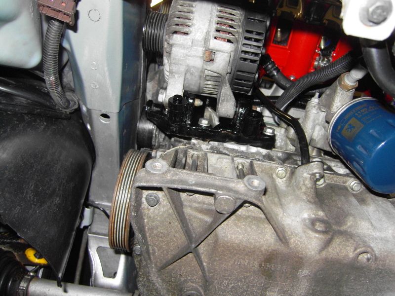

A little bit more attention to detail...decided to take the PAS pump and alternator bracket off the car and spray it. It was quite shiny in places but I wanted it nicer...just a shame you can't see it...also got a new pulley as the bolt was rusty.
Looks a lot better in the flesh.

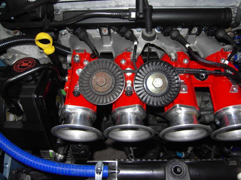

Took it out for a short run the other day, brakes are fine now too...without the airbox at 6k rpm it sounds much different to having the airbox fitted. There is a note change almost like VTEC engines give, obviously a different sound to VTEC engines but the same effect.
So I really want to drive it when it's 100% perfect...it's complete as it is but I think it could be better. So that means a Saxo/106 PAS pump, short radiator, longer trumpets, ITG sausage filter and proper Jenvey linkage...
So a few hundred quid to be spent yet.
How come you want to change to a 106/saxo PAS pump? Whats the difference?
